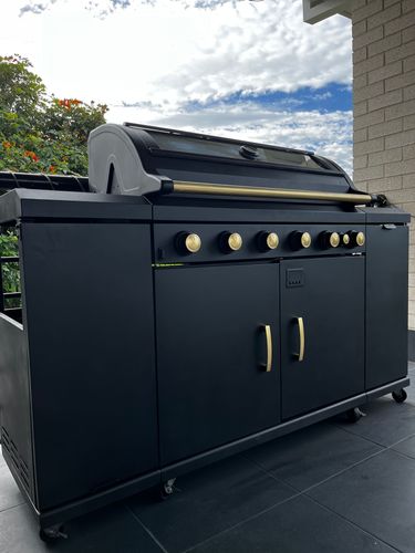

The most glam BBQ glow up😍 All details below👇

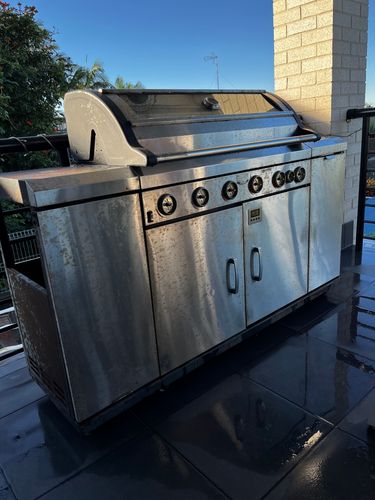

‼️ FIRST THINGS FIRST: You’ve gotta spend time prepping your surfaces. Remove knobs and handles. Clean BBQ with hot soapy water (with a degreaser) and steel/wire brush any excess rust off your surfaces. Hose it down and let it dry. Then wipe it down with some mineral turps on a micro fibre cloth and allow to dry again. Cover the areas you want to protect from over spray.
🎨 THE PAINT: White Knight High Temp Self-Priming Heat Resistant Spray Paint (colour: Pot Belly Black).
👉 THE DETAILS: Gold Spray Paint (whatever self-priming one you like). Only apply to parts not exposed to heat.
The project cost me less than $100 and the results were outstanding!
The perfect way to add luxe to your home for a small price tag!
