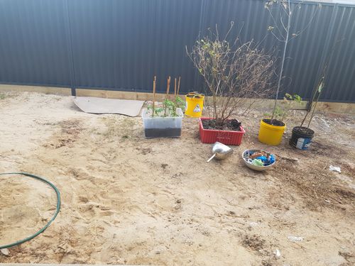

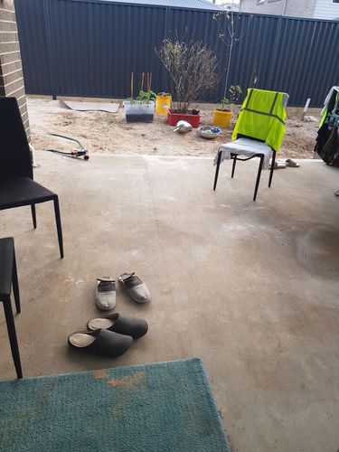

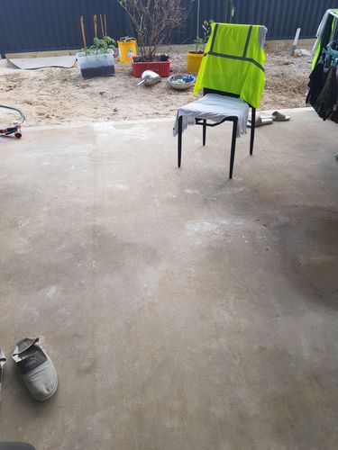

4 mtr of flat concrette and 4 mtr of flat soil

The supplied supports would be fine for the concreted area depending on how much height we have to work with to the door sill. For the sand area, you would need to swap them out for versions that you concrete into the ground.

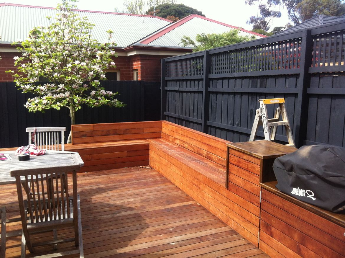

I also would like to build a bench at end of the deck, similar to the one in picture.
Regards,
Vipul Goswami8915a9273c5693237c1fc07ba6b44478.jpgbackyard-ideas-deck-bench-wood-with-planters.jpg
