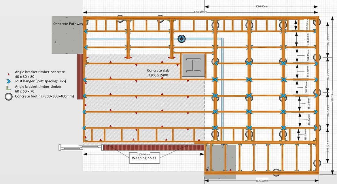

Size of alfresco is 3.2m x 2.4m but we decided to extend the deck to the backyard fence increasing the size of deck to 6.2m x 3.33m with 2 cm clearance on concrete and 10 cm clearance on the soil. The deck was supposed to meet two walls with 2 cm clearance to allow ventilation for weep holes. A small deck was added to the plan later to serve as entrance to the grass.

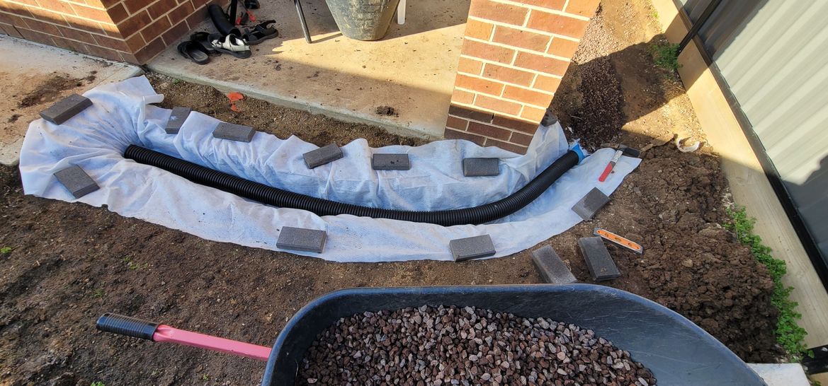

Drainage

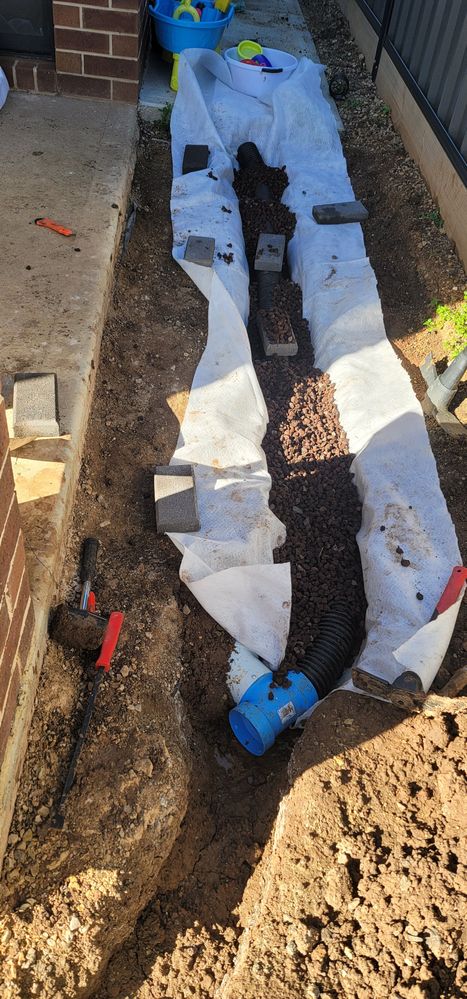

A channel was excavated on both sides of the alfresco, ensuring it was wide and deep enough for the ag pipe and drainage stones. Geotextile fabric was laid down, followed by a thin layer of drainage scoria before placing the ag pipe. Fortunately, a stormwater drain was located at the corner where both ag pipes met, allowing for an easy connection using a stormwater snap tee. Another layer of scoria was added, and the geotextile fabric was wrapped around the pipe. Finally, the channel was filled with the remaining scoria.

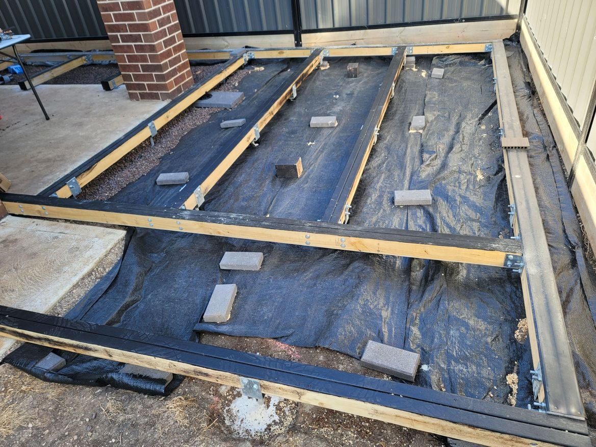

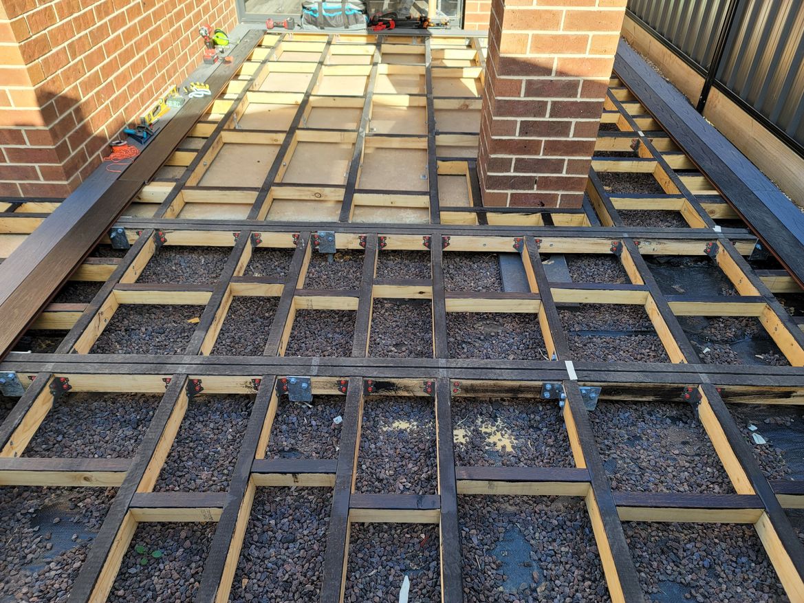

Frame

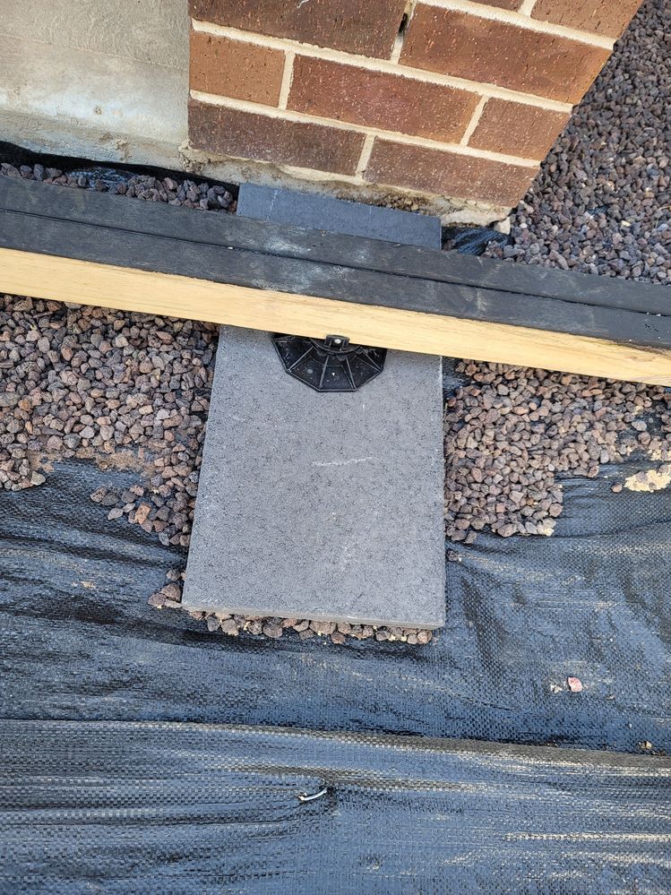

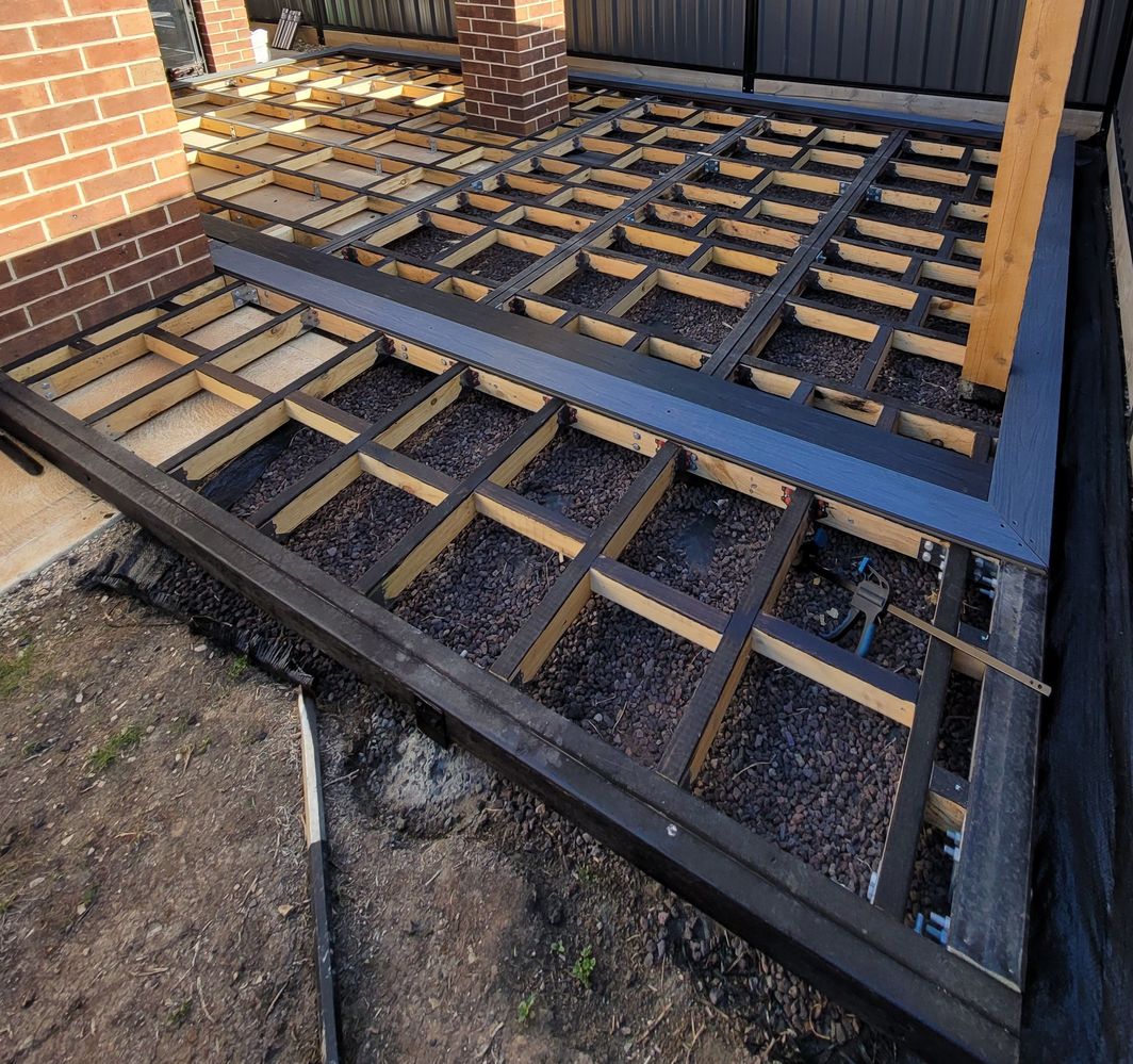

Galvanized stirrups were used as stumps, set into 400x400mm holes filled with quick-set concrete. A weed mat was laid down, followed by a layer of drainage scoria. The bearers were constructed using two 90x45mm treated timber pieces, glued and nailed together. I got stuck when one of the stumps ended up being over the ag pipe channel, which was resolved by using a large paving stone and a pedestal feet.
Since it was a low-level deck, the bearers and joists were installed at the same level. The frame was secured to the alfresco floor with angle brackets and dynabolts. To enhance durability, the surface of the frame was coated with a bitumen membrane.

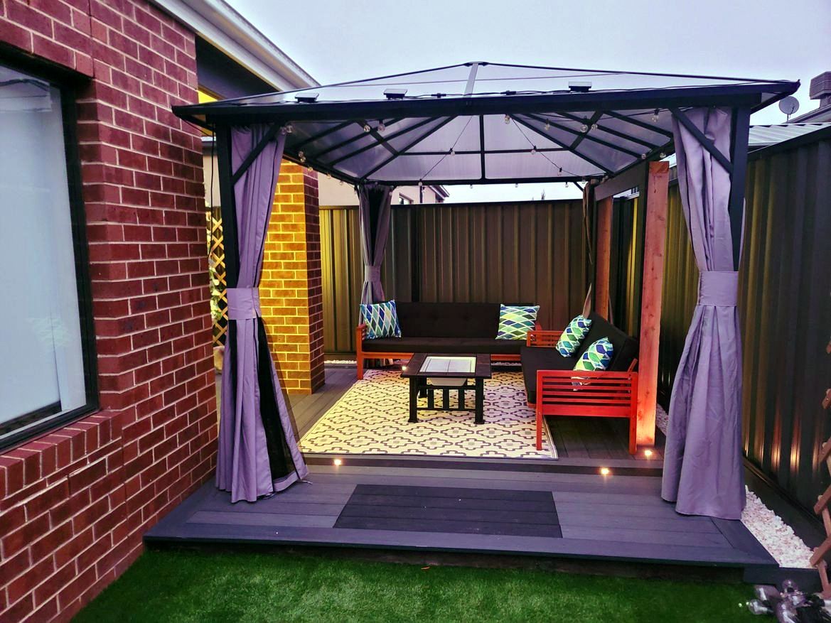

I love the outdoor area @nvdshams.
The composite decking looks great with the outdoor lighting and the hanging garden.
I'm sure you'll have many wonderful afternoons spent in this fantastic space.
Thank you for sharing.

Hello @nvdshams
Thank you so much for sharing that update, the deck and gazebo look fantastic! I can already see many social occasions happening in this area!

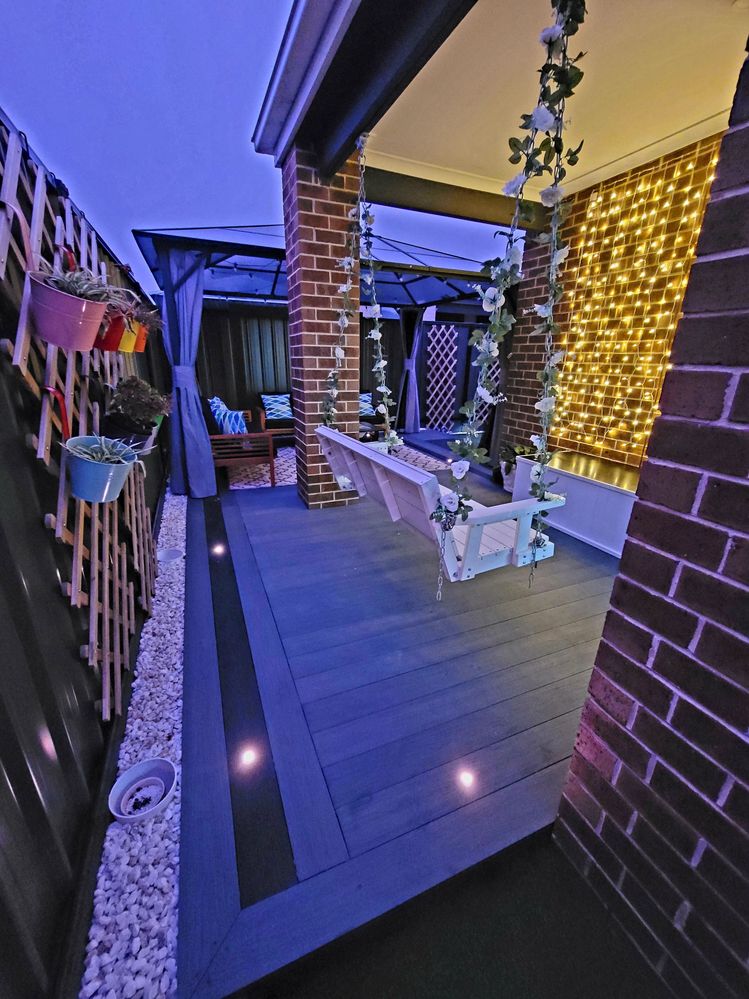

Good morning @nvdshams
That is a fantastic looking deck! And serioulsy impressed with your drainage :smile: Solves so many issues down teh track having it sorted.
How is the deck and area holding up and would you change anything from your original install?

Hi @Dave-1. Thanks for your kind words. Deck has been holding up really well for the last 6 months. If I have to do it again, I would probably use steel frame instead.
