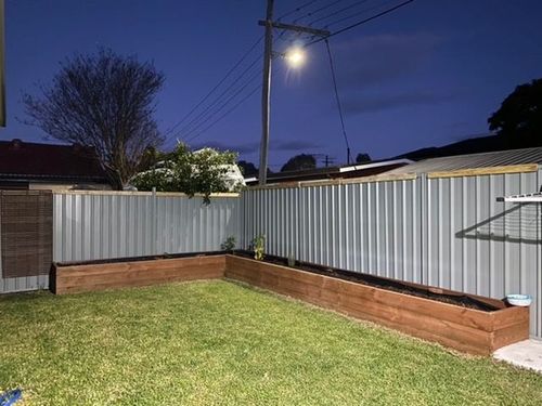

Hi Mitchell,
please see below two photos for progress.
At this stage, I decided to just attach it to the top baton, and am still figuring out how to attach the bottom. Or just let it hang loose - but prefer to fix it to the colorbond I think… thoughts ?

Re: Bamboo fence panel for extra privacy
That's looking sensational, @jeremytan!
I believe the easiest way to fix the bottom edge would by running the same baton as you have done on the top except only fixed into the uprights. Did you run into difficulties fixing that bottom baton?
It looks like you've slipped the bottom edge behind the raised garden bed, so I can't imagine you'll have too many issues letting them hang there. You could screw through the back wall of the raised garden bed directly into the panels, which would fix them in place.
Thanks @MitchellMc.
The colorbond fence was harder than expected, so the self drilling screws didn't work too well as it ended up just pushing off the colorbond and into the timber batons. Ended up pre-drilling holes, which turned out to be quicker.
But I might find a way of securing the bottom of the panels to prevent them from moving over its design life, as I imagine that might damage the fixing point at the top of the panel.
