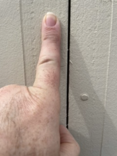

The boards were originally painted over but I want to fill the gaps before painting a different color.  Attached is a image showing the small gap
Re: filler for gaps in blueboard joins
@ac1977,
That's a gap that should probably have been set originally with the above-mentioned products. Now, your best option might be to use a flexible and paintable polyurethane sealant like Sika 300ml White Sikaflex 11FC Plus Polyurethane Adhesive Sealant. It's a great product for joints that might expand and contract.

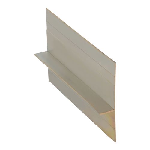

Hi @ac1977 if your looking for a basic cosmetic fill, James hardy make a product called a "Horizontal Trimline Joint Flashing" which come in various widths and 3m lengths and can be ordered via the special orders desk at your local Bunnings. It's pressed into position and fixed with silicone sealant.
Regards, Nailbag
