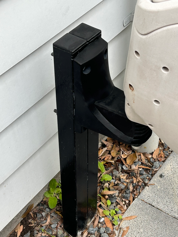

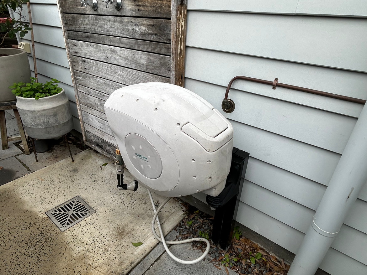

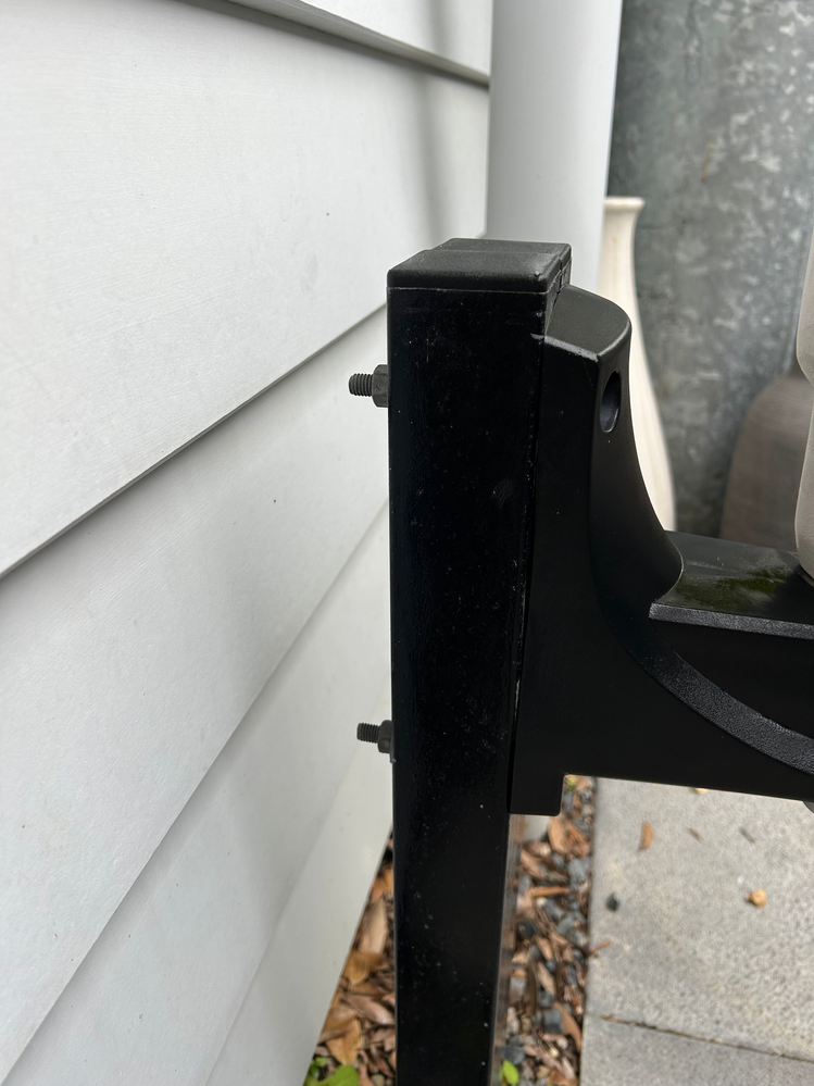

G'day hammerandnails l am always wary when attaching a heavy item to a brick wall especially when attaching something like a large retractable hose reel that is going to be constantly reeled in and out putting pressure on those fixings. To counter that, even though my walls aren't rendered brick, when l installed my 30 metre Hoselink seven years ago l concreted two galvanised 50 x 50 posts into the the ground, painted them black and then attached the garden reel to it. Works like an absolute charm and l never have to worry about it coming loose from the wall. I've attached a few photos to show you what l did. Cheers 👍

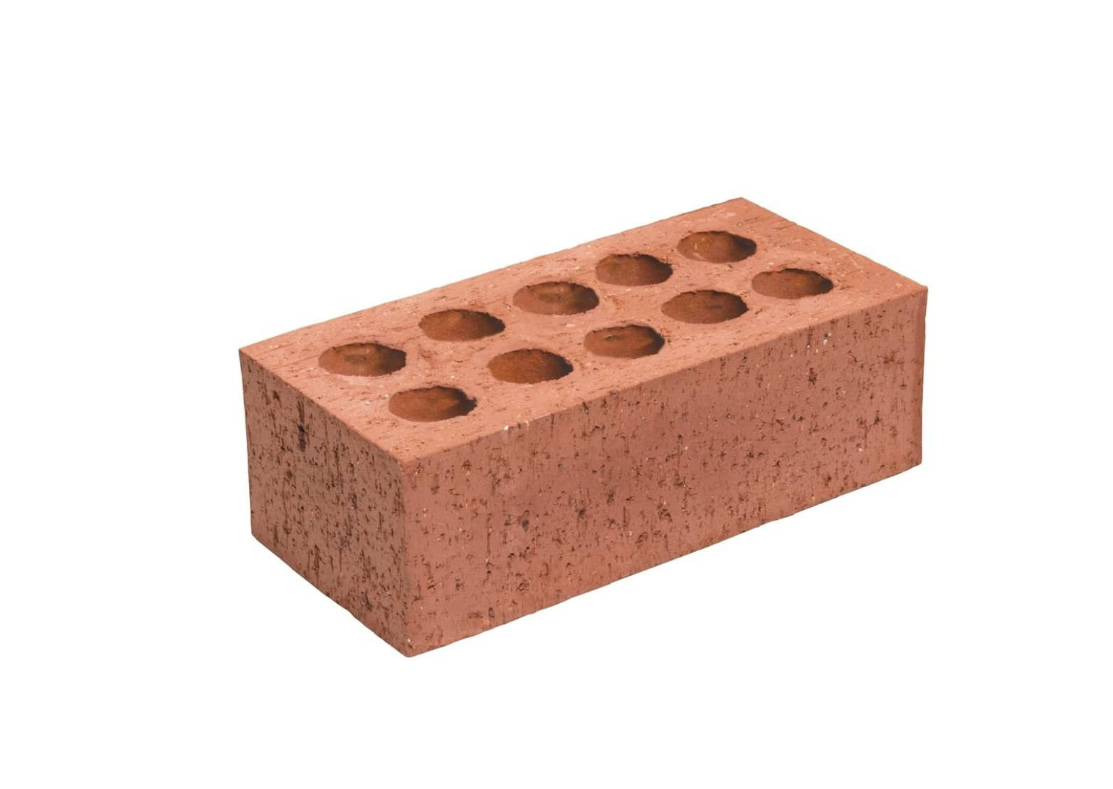

DynaBolts don't tend to work particularly well on common house bricks that have holes in the centre of them.
This is because the expansion can crack the core of the brick, which can irreparably damage the brick and make the Dynabolt unable to grip .
If your house was constructed with these bricks, then the option @Eric_L recommended is your best bet, as the Chemset and sieve will work together to fill the holes and create a good, solid anchor. Have a look at this video on Ramset's YouTube page for an example of how it works - Ramset™ UltraFix PLUS Polyester Anchoring Kit.
If your house is built with core-filled besser blocks, then you would be fine using the Dynabolts you mentioned.
If you weren't sure what your house was constructed with, then it would be better to use the Chemset and sieve method just to be safe.
