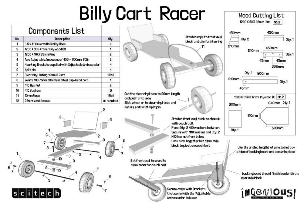

I could suggest various sizes, but it's likely a good idea to have a plan to go with those. I suggest following this Step-By-Step video from one of our suppliers, Trojan: How to build a billy cart.
You'll need a length of 90 x 35mm MGP10 Untreated Pine Timber Framing - Linear Metre at 2400mm and one piece of 1200 x 596 x 18mm BC Plywood. You'll also need to pick up a couple of axles and four wheels. If you're looking for extra speed, I'd suggest wheels with bearings in them.

I've contacted Trojan, and there are no specific details on cut sizes for this exact project. However, they've been able to supply a set of plans from a very similar billy cart.
Please let me know if you have questions.
