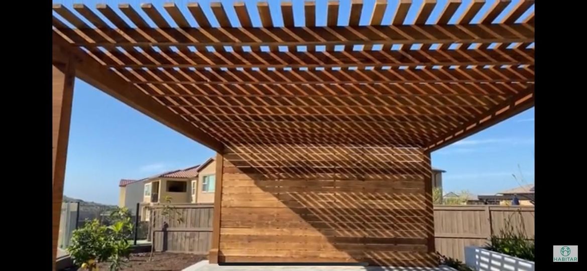

I am planning to do a pergola similar to this one:

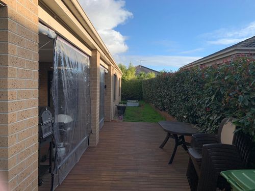

The plan is to do it next to the house and all the way to the fence. The area is 6.9mts for length by 3.1mts for width and 2.5mts height. Can somebody help me how much timber would be required?

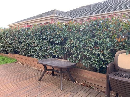

There are some trees next to the fence but I will remove them. Not sure if I should have 2 or 3 posts along the fence because of the length of 6.9mts.
