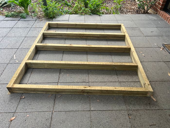

I pieced together the base frame over the weekend (picture below).
In preparing for the decking, I am wondering if i should:
  • A - Build the decking from edge to edge and fix the wall frames on top of the decking.
  • B - Build the decking with a 70mm clearance to each edge, so the wall frame can be fixed directly to the sleeper.
I initially thought that B would be the way to go so I wouldn't have to fix the frame through the decking, but now realise that if I don't go all the way to the edge then the decking will not be properly secured.
Some advice would be greatly appreciated.
Re: Can I use timber battens for wall framing for a cubby house?
Hi @Raymo16,
The simplest and easiest thing to do is attach the decking boards and then fix the frame through it into the subfloor.
Use a 100mm Galvanised Batten Screw through each stud bay to ensure you get a good strong connection. Make sure you pre-drill holes to ensure nothing splits.

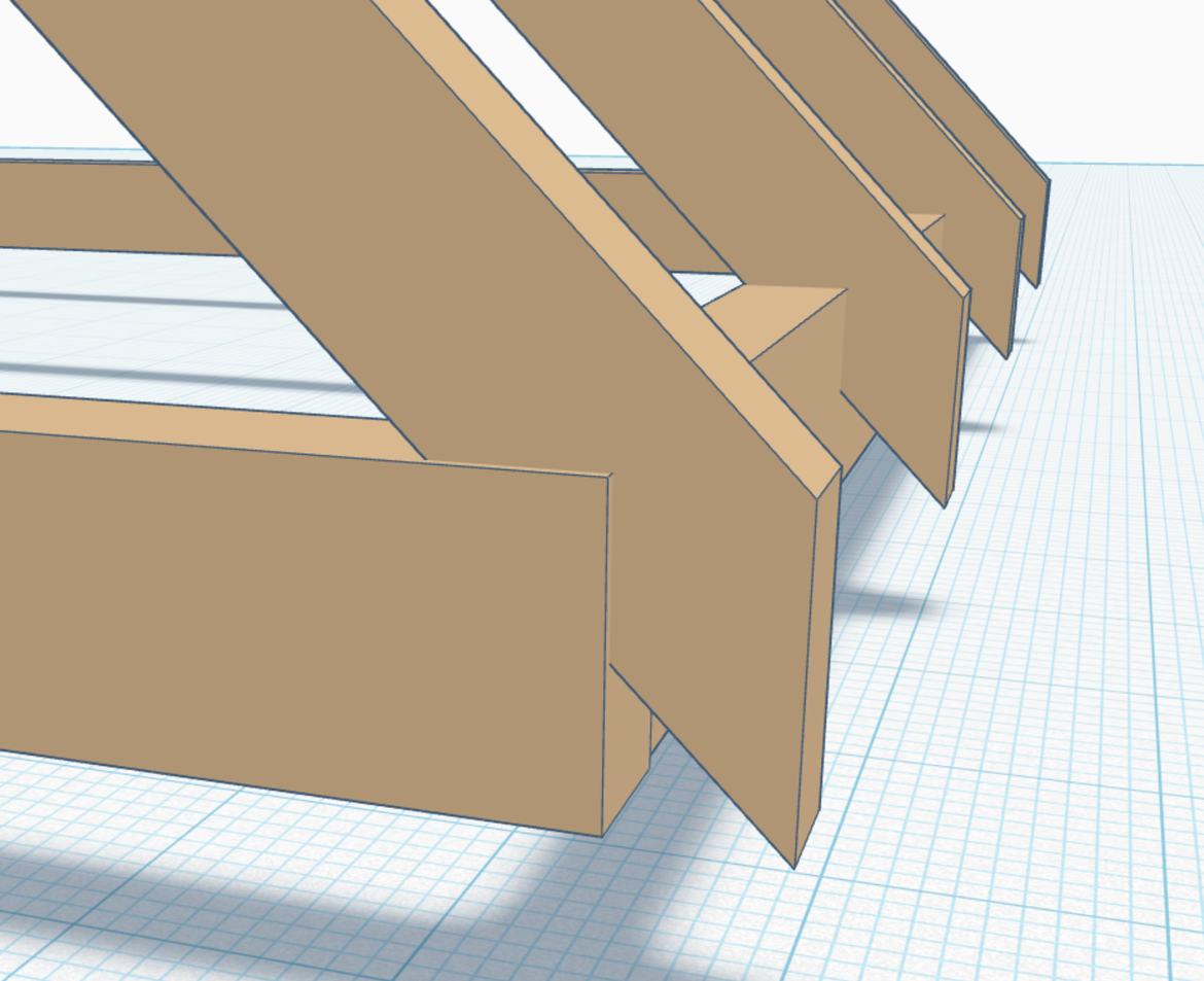

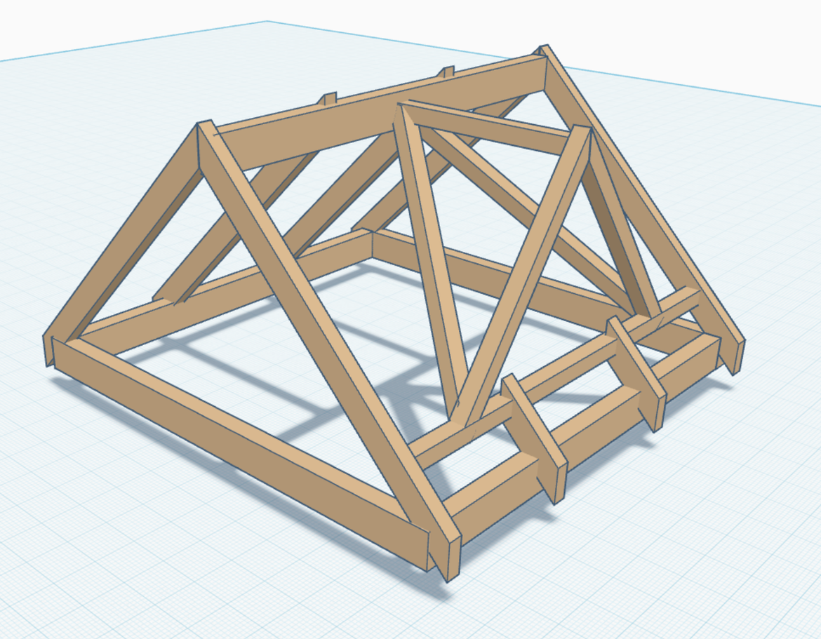

You might like to check out step six in How to build a pallet cubby. It shows how I cut the uprights for the walls at an angle, allowing me to attach the rafters at the required angle. This is a very simplistic approach that works well.
Alternatively, you could use a more traditional roof-building technique and cut birdmouths into the rafters. I've spent some time creating some renderings for you.
