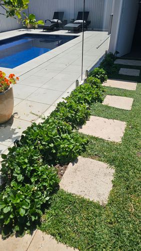

I want to make a garden path kinda like the image, stepping stones between grass. It will lead to the pool.
The pool has beautiful travertine stone capping and has nice 400x400 outdoor  tiles around.
I would love to have travertine pavers but my budget is next to nothing as I am on maternity leave.
The previous owners who installed the pool left a heap of the spare outdoor tiles. I know I can't just use tiles like pavers as they are too thin. However could I glue them to the top of cheap 400x400 concrete pavers, almost like a veneer? If so what would I use to secure them? Sorry if this is a ridiculous question... I'm inclined to think it's bot possible as I couldn't find it on google lol

Grass and tile walkway
Following on from my previous post. I am planning to use outdoor tiles to create a stepped path similar to the pic.  I was planning to use the tiles as basically a veneer to the paver. However I thought the tiles were 400x400 and would fit on pavers I had. However turns out they are 450×450 and being on a budget I can't just buy bigger pavers.
I am now thinking of making my own pavers/ slabs in situ to put the tiles on. I have a few questions as to how I might do this in the most cost effective way. Note I have zero experience with anything like this so tell me if it sounds to ambitious.
1. Can I use the pavers and some bricks I already  have in the 'slabs' to reduce the amount of concrete I need? E.g if I want a 'step' to be 1x2 tiles (450×900) can I put 2x 400x400 pavers down and just fill the gaps so to speak maybe with a thin layer with mesh or something on top?
2. For the form work, since they are only small slabs and (hopefully already have pavers in there) can I use fence pails and garden stakes as they are cheap. Is there anything cheaper?
3. What concrete mix would you reccomend?
4. If I was feeling super ambitious and wanted to do some thinner steps like pictured, how would one cut ceramic outdoor tiles of this size on a budget? I looked on the website and there is a $40 tile cutter but it looks to be only 300mm. Also how would I make the edge smooth?
Thanks, any advice is greatly appreciated

 I ended up using tevatine  pavers, strawberries and kidney weed :smile:
