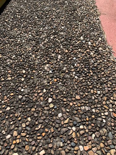

I’d like to know if you can affectively paint a pebblecrete driveway, and is, how?
And what type of paint is best to paint painted cement/concrete
Hello @DonnaOBrien
Welcome to the Bunnings Workshop community. Thank you for joining us and sharing your question about painting your pebblecrete driveway.
One of the products suggested in this discussion - Re-surfacing pebblecrete was Megatreat. It is a two-part application of primer and topcoat. These products need to be ordered at your local store's Special Orders Desk. Unfortunately paving paint and garage paint systems are not compatible with pebblecrete.
Your other option is to clean your pebblecrete with a high-pressure washer to remove the mold infestation between the pebblecrete. I suggest using Simple Green 1L Green Concentrate All-Purpose Cleaner to remove any oil and grease residues.
