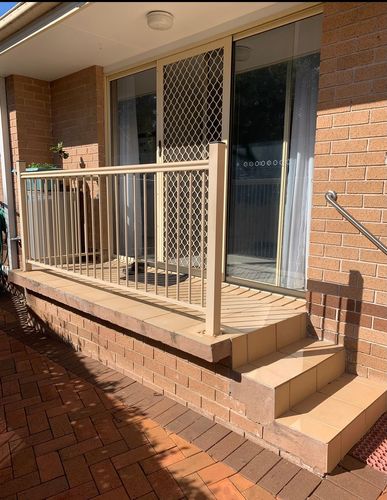

hi - we are re-doing our backyard and wondering any suggestions on jazzing this area up. I’d like to avoid ripping up the tiles. Does Bunnings have outdoor tile paint that would work? Happy to hear suggestions.

I presume those tiles have some type of coating or glaze on them? I've called a few of our outdoor flooring paint suppliers lately and all of them have advised against coating a tile with any type glaze on it. The paints are designed for porous substrates like concrete or cement-based pavers. The pavers on the ground would be a perfect example of what they could go over, the tiles on the patio and steps not so much.
Personally, I would be tempted to clad the entire patio and stairs with timber decking. An issue you might have to deal with is the last row of tiles. It appears to ramp up to the sill of the sliding door and there wouldn't be a lot of room to place a joist. I'd then paint all that cream trim/handrail in a blue-grey colour or perhaps even Dulux Monument.

Thanks Mitchell. Yes I believe there is a coating on the tiles so I guess that rules that out. There is a slant on the tiles near the sliding door - is there anything we could do about that if we were to deck it?

After having another closer look at your photos I don't believe timber would be appropriate. When I first saw your images I had interpreted the shadow on the bottom edge of the door as a track approximately 50mm high. Now I can see it is not and the bottom of the door is flush with the top of the sloped tile. Where-as previously I thought you might have around 70mm height to work with now I see it is much less than that.
With the available height, you would basically be laying decking on top of tiles and this is problematic as water would not have the ability to drain off the area. I apologise for my misinterpretation of your image and possibly getting your hopes up.

Tiles that are glazed can be painted as long as you sand the top layer back first.

Do you have any suggestions of how the glaze could be sanded off, as I haven't attempted to do that myself? Do you think a coarse 40 grit sandpaper would do the job? Perhaps even an angle grinder with a Josco 127mm 40 Grit Abrasive Flap Disc might work.

I wonder if you could some kind of acid to break through the glaze of the tiles and render them porous to the paint,

That's an interesting suggestion. You could use an acid, but you'd likely need to use hydrofluoric acid or ammonium bifluoride. Neither of which I'd recommend for D.I.Y. use around the home as they are highly dangerous. If you were going to go that route, I'd recommend you consult a trained professional and employ them to do the job.
