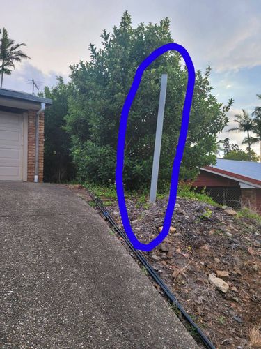

Wondering how deep is the concrete base, will that be too heavy for two men to lift it up in bare hand after using shovel to take out the soil around it ?
We got rotrary drill , shovel and spade
Thanks for any ideas

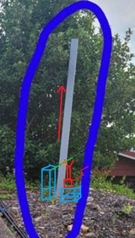

Dig some more and put a 100mm brick or block infront the pole and as the pole tips over the block it will act as a piviot point lifting concrete base out too.
If you find this pole super tough i use a car jack especially in old timber fences ie many posts. Pulls them out like steam hard bit is lowering jack then adding blocks as post rises. I use section of old fence posts to make varying block heights. 100% success done with my experiance.
I drill 15 to 20mm hole in post and push through thick steel rod (reo or very heavy tent peg ) I then put a besser brick and timber block one side and a car jack on the other side chocked up under the other side of metal rod. Then simply operate the jack with 2 to 4 tonne lifting force re adjusting jack and opposite blocks as it lifts up. Always double check stability around jack work. When pole is quite loose then man handle it.Strap and jackJack with rod through pole

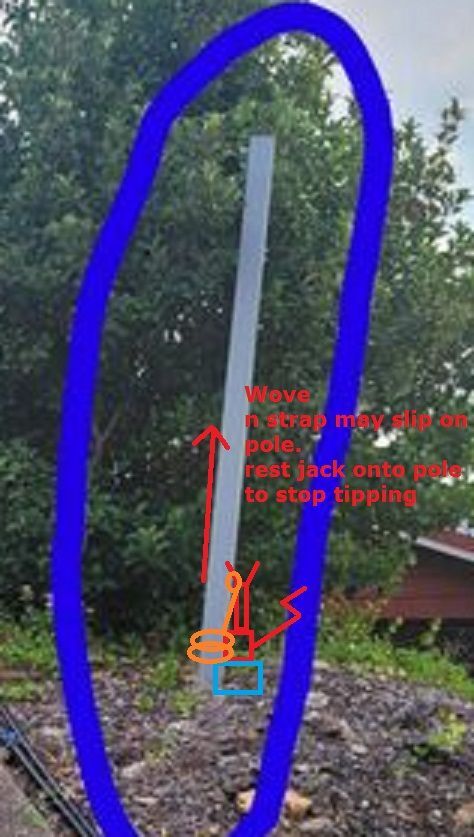

I dont know if a woven strap will grip the pole as not to have to drill a hole. 40% success estimated.

It's great that you've received excellent advice from @MitchellMc and @Jewelleryrescue. Just to add to the ideas suggested, have you thought about the reason the pole is there? I believe it is used to attach a Marquee 3 x 3m Charcoal Triangle Shade Sail. Hence the reason why it is buried so deep and held in with so much concrete.
If you look at the front of your house you might find anchoring points for the shade sail. This would make an excellent spot for your car to park in without driving into the garage. It will keep it nice and cool this coming summer, although all this rain is making me doubt that summer will show itself.

I think you are right about that being and ex shade cloth pole i was thinking i was seeing things wrong but that poles on an angle. I think I can see that eye at the top. well spotted @EricL

Thank you so much for all the advice.🙏@EricL @MitchellMc We want to remove it because we want to install drainage and the pole is standing in the way of the best drainage path. Then we talked to the plumber, he said he would hire excavator to dig trench so he would remove the pole so well. The rate for the excavator with operator is approximately $400 – 500.

Your excavator with operator is the best way too go. Just need a solid chain of woven belt around the pole to grip it is the secret there. our pull it over.

Just in case your excavator guy has no experiance pulling pole with a machine.
Wrap the pole low to the ground. You might need to dig around the pole and wrap onto the concrete base for grip.
