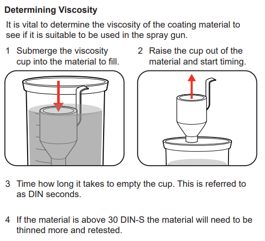

You'll notice there is a viscosity cup included with the tool.
You'll have to make sure the paint and thinners mixture is mixed thinner than 30 DIN-S before spraying. If it needs more thinning, add more thinners.
