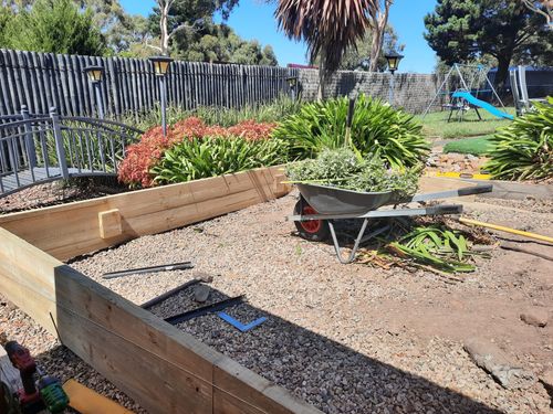

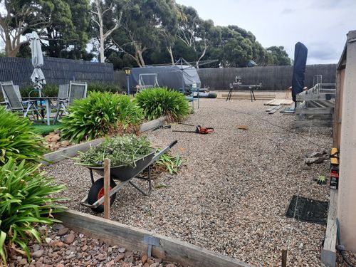

I cleaned and cleared the area where the walls of the base were to be positioned to level up the ground. I also began to run the string lines for the right level.
Here, I started running the treated pine sleepers. As the slope was fairly steep, I dug in some of the sleepers and with supports, lifted the others to create the level area to
work with.

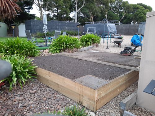

Once I had it level to my liking, I boxed in the 4 corners. I proceeded to drill four 300mm holes to create the footings. Mixing 4 parts crushed rock to 1.5 parts cement in the cement mixer, I created the footings which included the boxing and the outer sleepers for greater depth. Once the footings were dry, I proceeded to then fill the area with lots and lots of crushed rock which I packed in thin layers to get the best compaction. To level it up, I screed the rock with a straight edge to get it right.

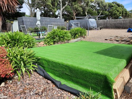

Got the synthetic lawn over and rolled it into position. I squared it up and pegged it into the ground. I also used gal staples to fix it to the sides. Now it was looking great!!

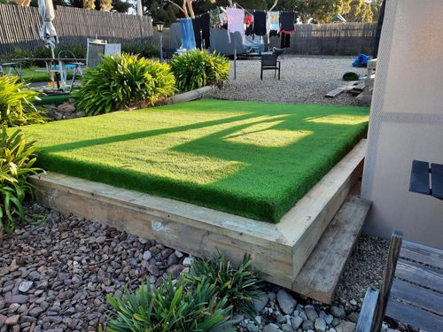

Now, I created the steps to access this area and the BBQ area. I had stretched it out as best as I could.

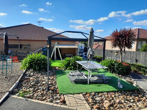

Now the best part began. My wife, 2 sons and their partners started to construct this gazebo. Following the instructions to a tee, the assembly ran great. Once we got it to this point, we squared the feet, cut away the synthetic lawn so as to have an accurate footing point and fixed the brackets into the concrete. Bolting the posts to the footings stabilized it nicely.

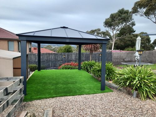

The roofing was added as well as the bracings and wallah, the gazebo was finished. It is a nice touch to our backyard.
And here it is in all its glory. I let the concrete dry for 5 days to get the best purchase on the dynabolts. It took 1 day to put it up and it hasn`t moved in the serious winds we have in the dividing range. Next project is the spa area.

Now that is some serious prep work! And really I dont think those concrete blocks will be shifting anytime soon ![]()
It has come up so nicely, I really like the edge you placed around the base. It looks pretty swish.
I have looked at those gazebos so many times and always wonder what they would come up like. They come up nicely!

Thanks for the feedback. The winds where we are are regularly gale force to damaging. Stood under her and just a wiggle every gust. Now the weather has improved, it is great to sit under with the family. You are right with how they come up. Real nice 👍

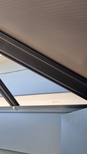

I have a question as I am in midst of assembling this one at my home.
These roof plastic holders. Do they go
all the way in or just a bit out like in picture.

If you still have your installation instructions, you'll see on page 25 that the roof plastic holders are actually short and do not go all the way. But in regards to its installation, I believe you've done it correctly. If it is not in the correct place, you would not be able to put in the edge locking piece at the bottom of the roof panel.
