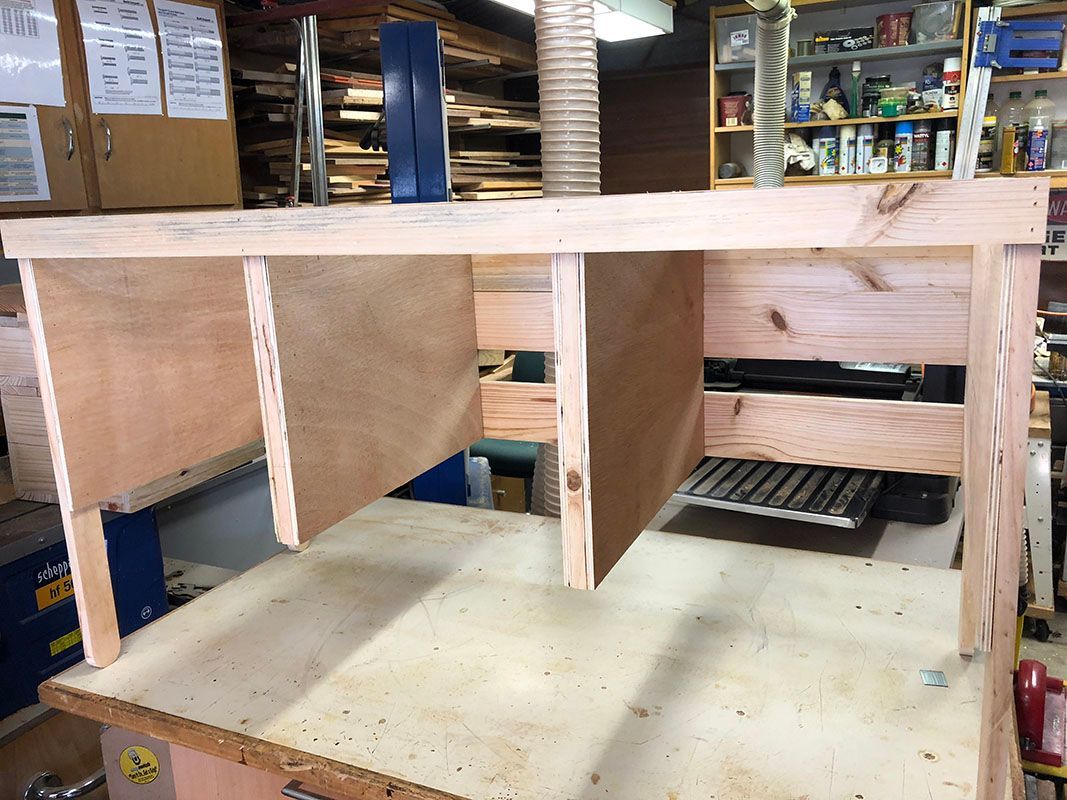

I planed up some pallet boards to equal thickness and made the framework using pocket hole screw joints.
Then glued and brad nailed the back panels using a couple MDF pieces cut to size for the spacing of the middle frames.
I had a Plywood crate that was being thrown away at work so I cut that up to be the internal lining of the nesting boxes.

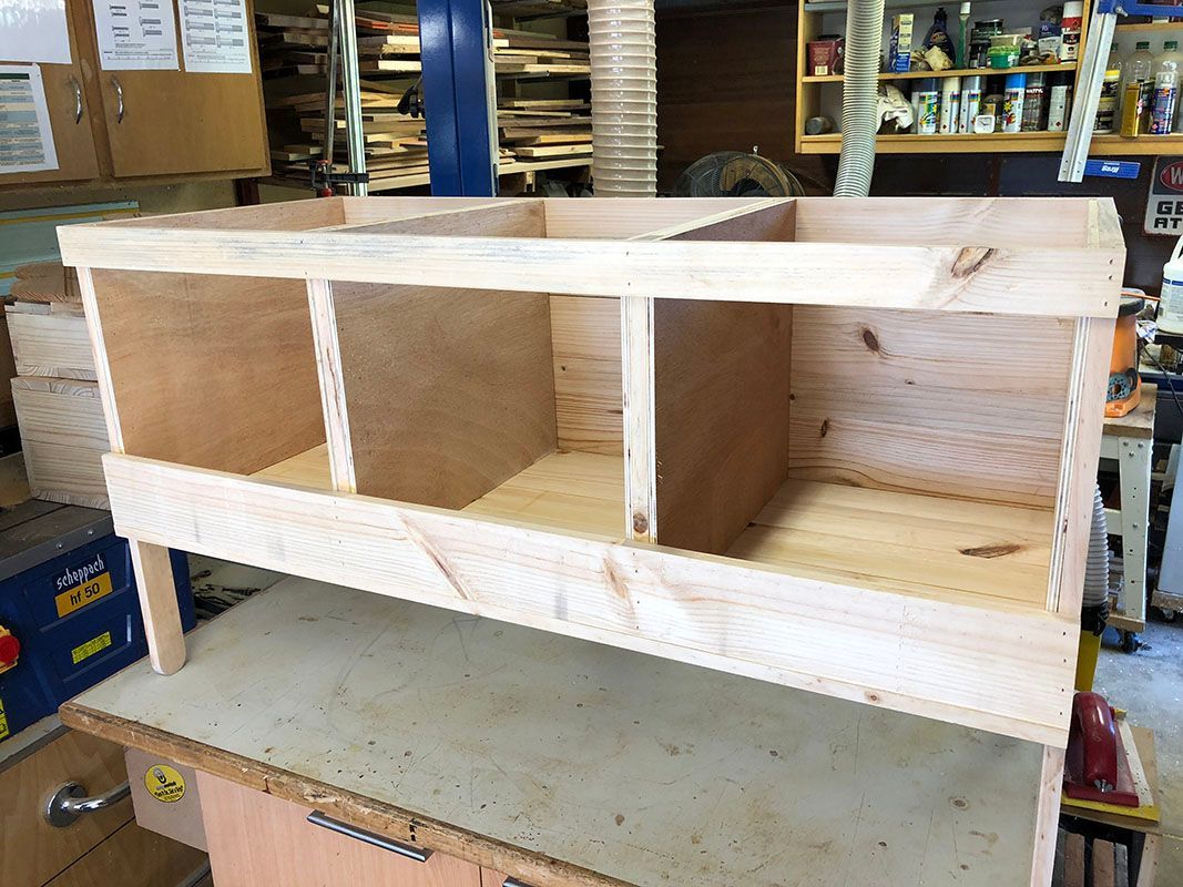

I glued and brad nailed tose in place then continued on with the outer cladding.

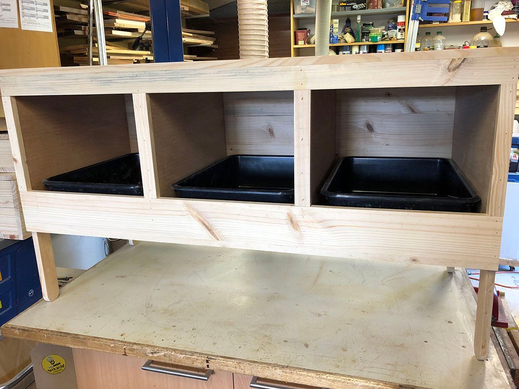

I finished the back then the floor and a couple strips on the front, she had supplied some plastic trays that she will place in each position.

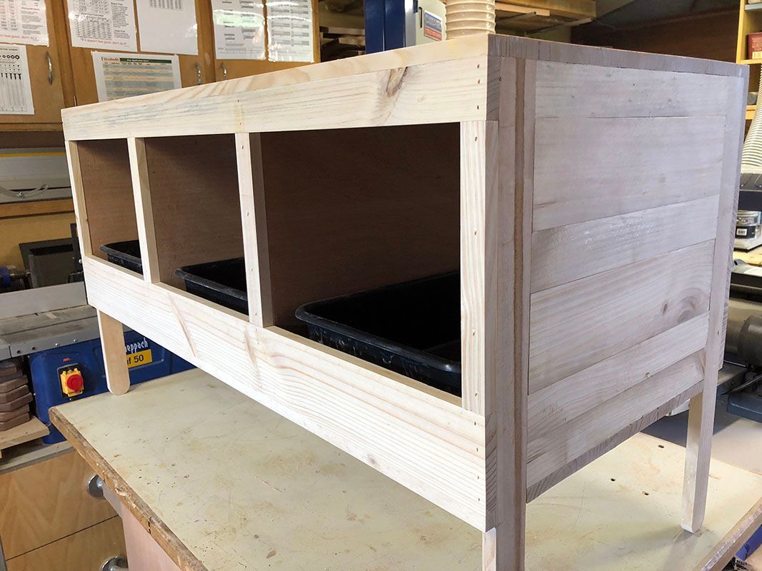

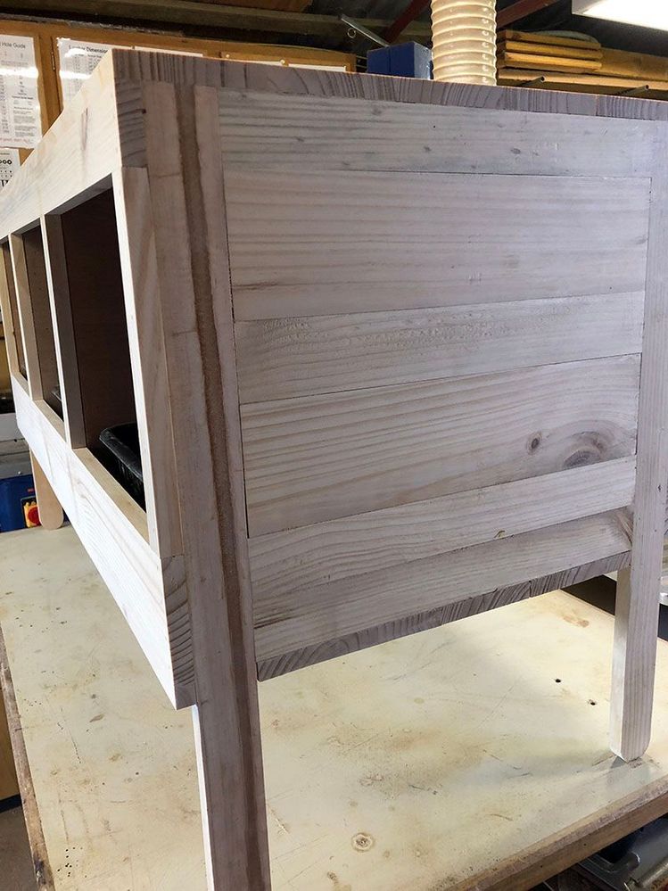

The side/end cladding was supposed to go full width but I accidentally cut the boards too small so I decided to cut them smaller and glue them inside the outer frame (some were even the correct width, lol)
And voila one finished Chicken Nesting Box. (I will fill the nail holes with beeswax and she will apply a varnish finish)
