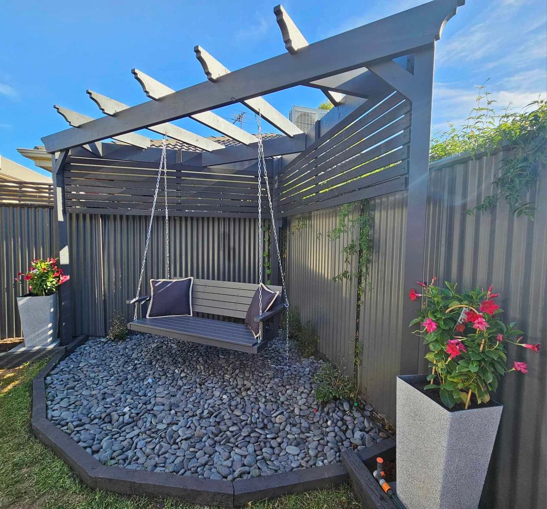

New Corner pergola with composite screening and Swing.
Steps
Step 1

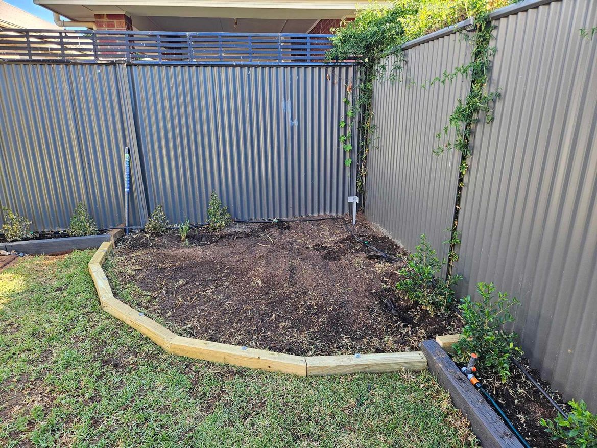

1)removed old plants
2) Dug up the grass
3) laid down Weed mat
4) Cut a Octagon Border
Step 2

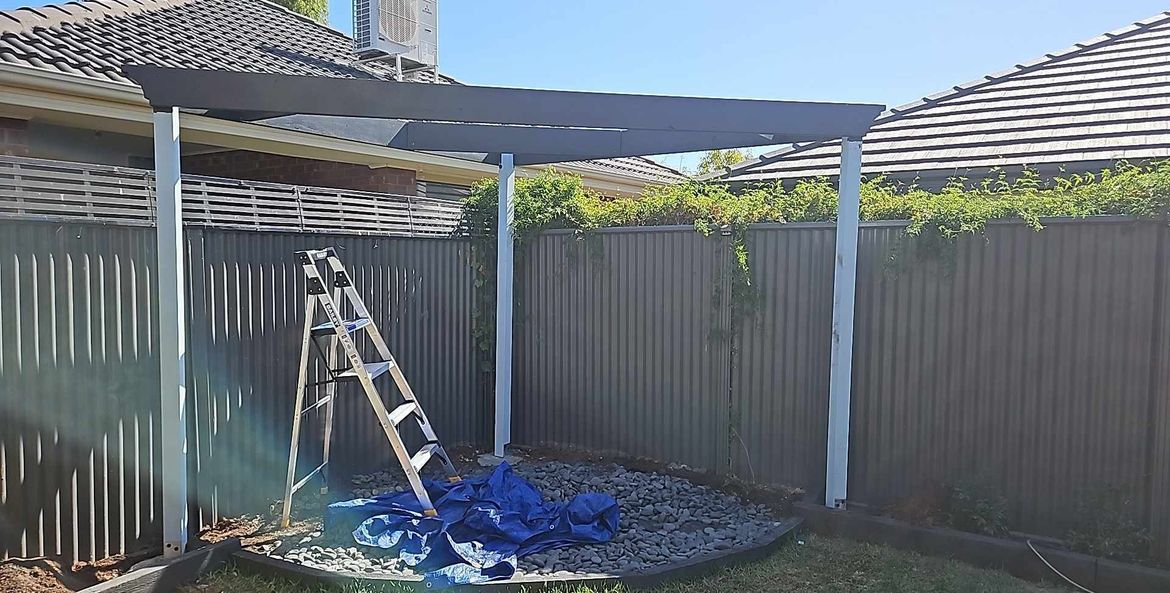

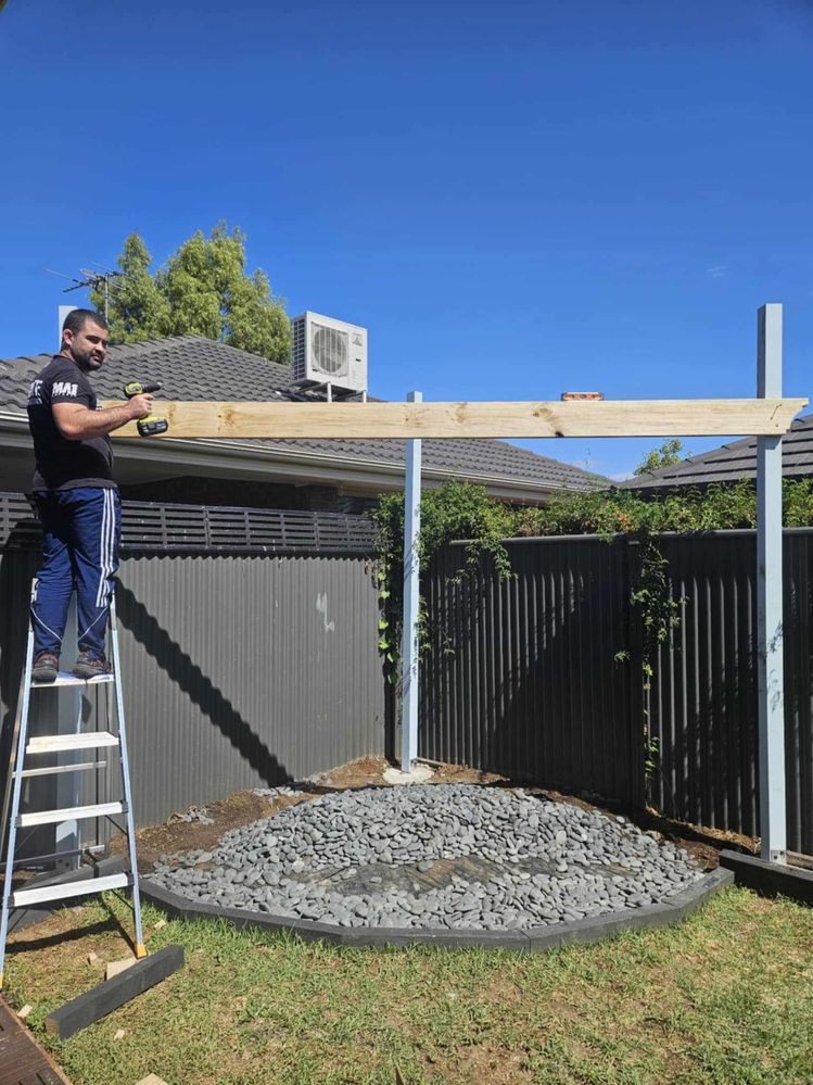

5)cemented in the Saddles
6) Screwed in the Posts
7) started screwing in the main Triangle Frame 485067823_650063437648761_7202535314084136185_n.jpg485516065_669225895590920_135839005490398125_n.jpg
Step 3

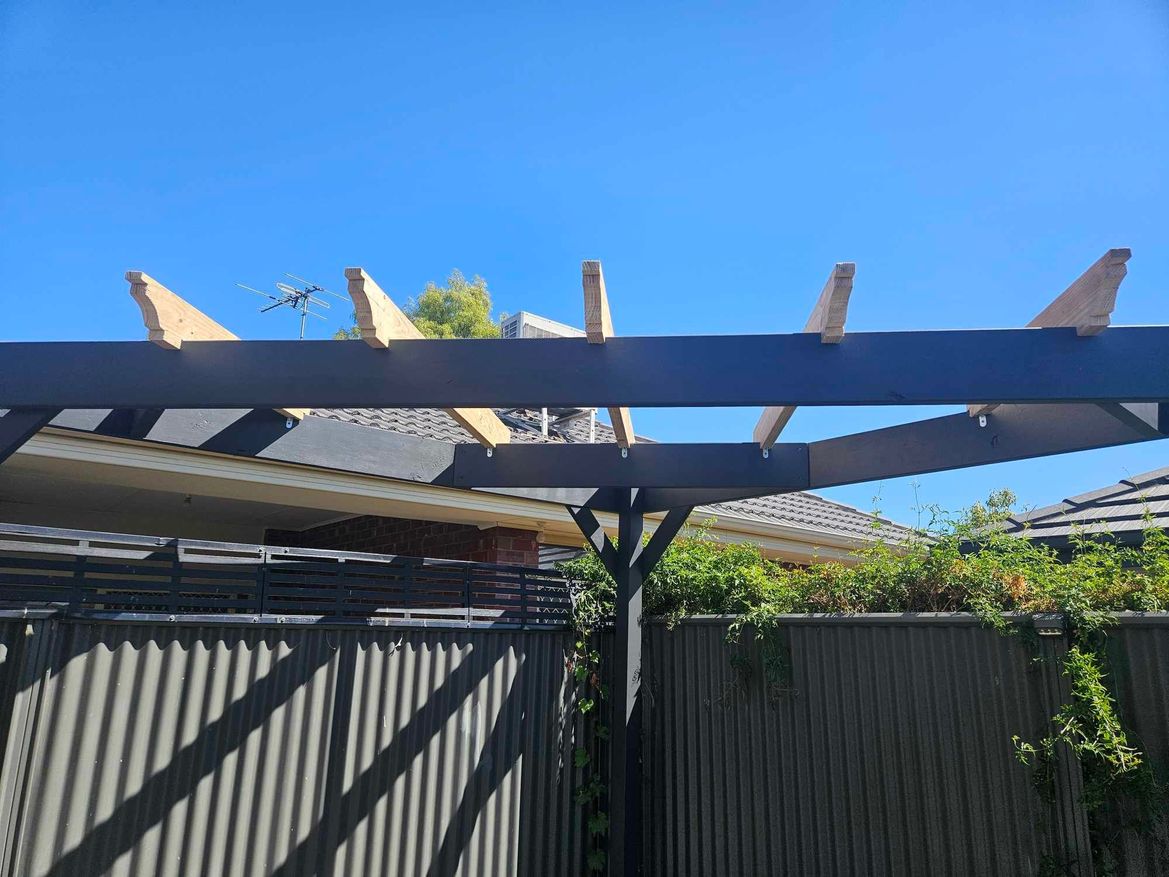

😎 painted the Main frame with Monument Paint.
9) Started cutting Rafters and notching out Pattern on the ends.

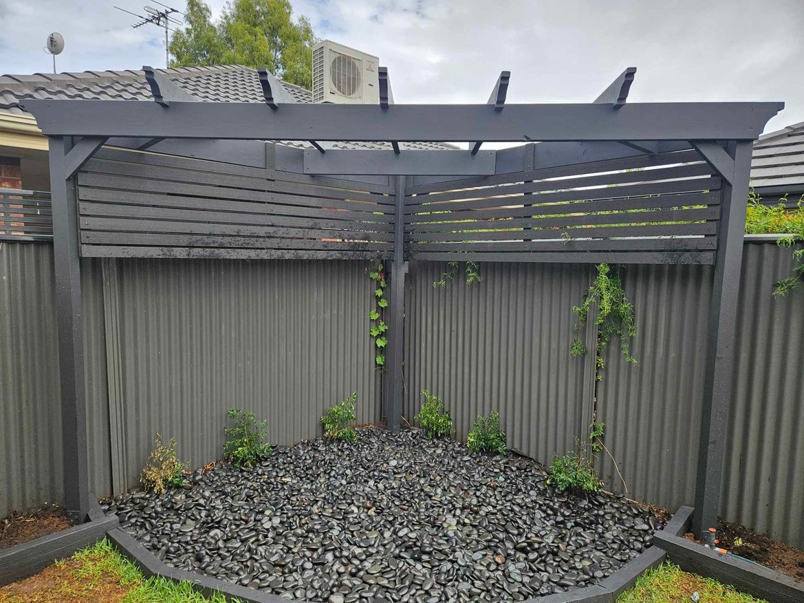

Step 4
10) Added Extra Post supports for strength
11) Added Composite screening
12) Painted he whole structure in composite
13) Planted hedge Plants and Smoothed out the Rocks
Step 5
14) Added Big W 3 Person Swing
15) Painted the Swing
16) Added to Climber Plants on the sides.
