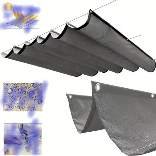

Hi @Kelly7916,
I am proposing a completely different approach, one that is low cost, easy to install and... in you case includes two hammocks.
Install that in your outdoor alcove using a clear material.
Together visit Bunnings, go for walkies through the outdoor living section and have a look at hammocks, sun lounges or maybe even a roll of synthetic grass.
Come back if you want more info...
