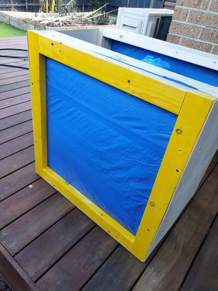

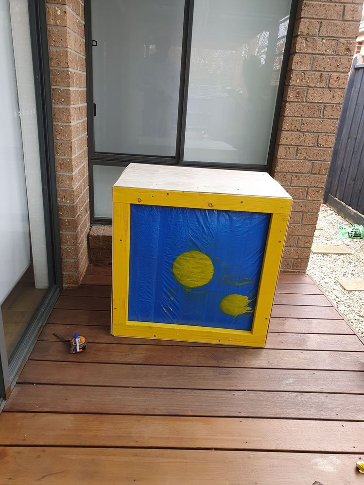

Wanted to practise archery at the club & for those times when we go on road trips to a friend's farm in regional Victoria. The goal was to see if I could build my own target to use at the club.
Disclaimer: It is not legal to practise shooting arrows in the backyard in most councils. Therefore this target was to be used at the club or back at my friend's farm in regional VIC.

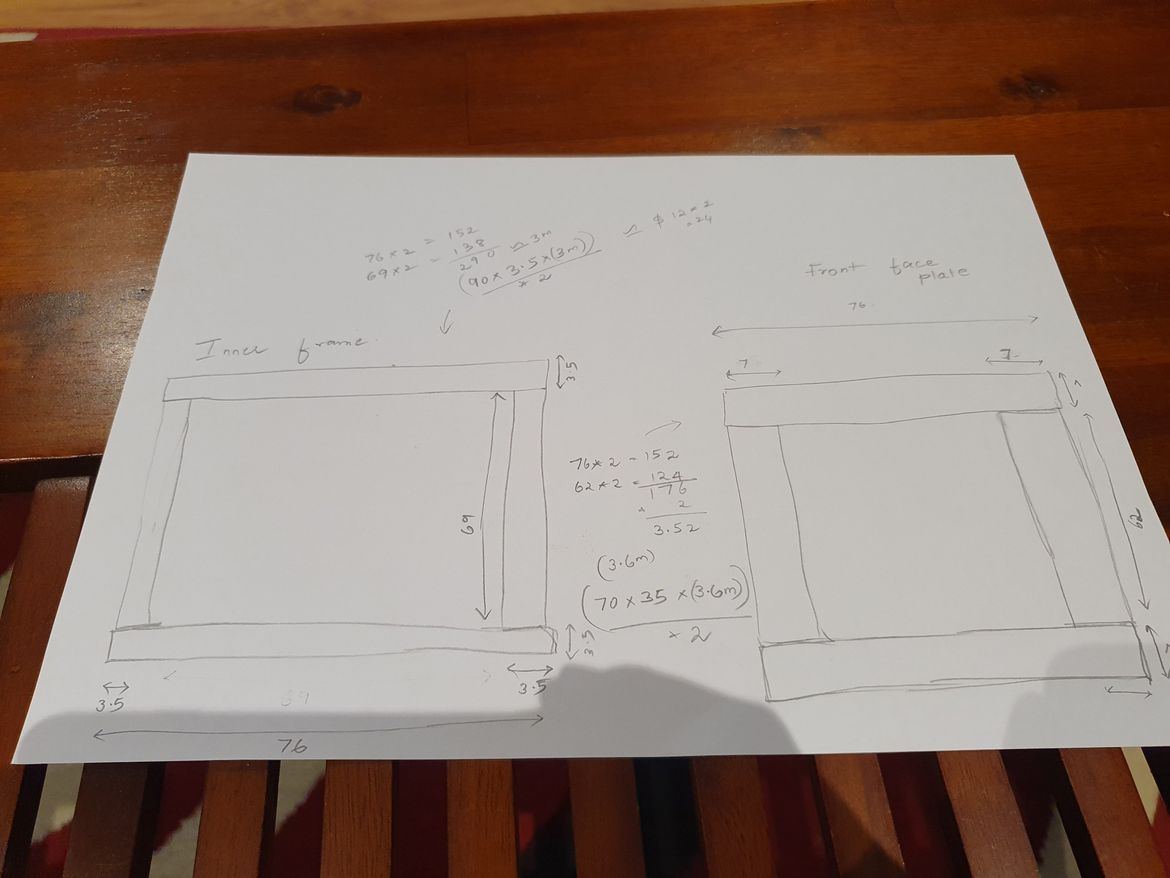

Please see attached diagram for exact measurments. Rough cost of all materials = $50
- Treated Pine
76 cms * 4
69 cms * 2
62 cms * 2

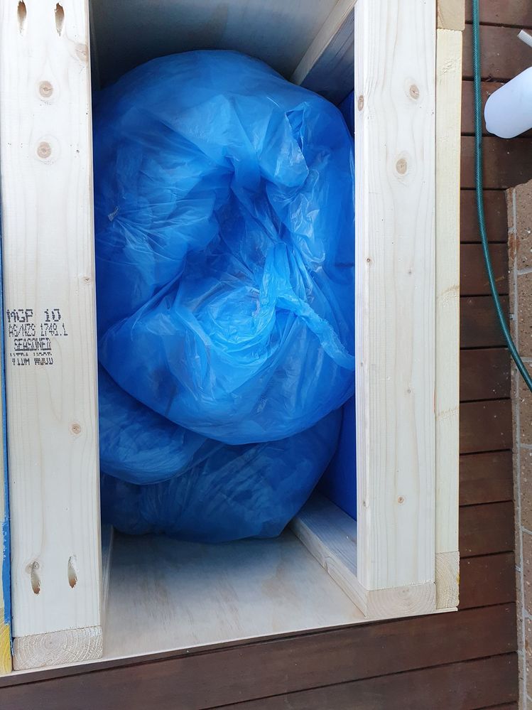

- Plywood
76 cms * 30 cms * 4
- Tarp * 2 (Link)
- Timber screws (Link)
- Basic Staple gun with staples (Link)
- Packing material (plastic pallet wrap) - Borrowed from a closeby warehouse
