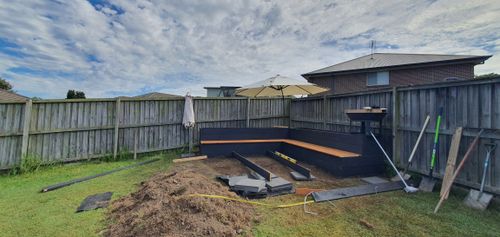

Hey everyone, I thought I would share my first ever project. Being a first home buyer this was the first chance I have had to actually build something and im surprised it actually turned out ok. Sorry if to many pictures but I figured I would show how it was assembled originally.

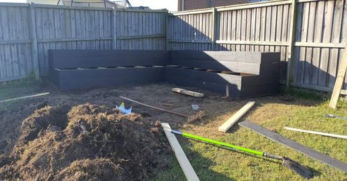

For anyone interested the seats/planter box were easy to make.
I used h4 treated sleepers with the height being 4 sleepers high. The bottom 2 measure 3 metres by 1 metre and the top measure 3 metres by 50 cms.

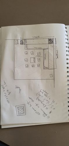

The drawing above is what I used as a basic outline of the plan. I changed a bit off of that.

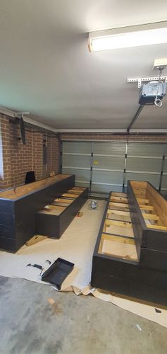

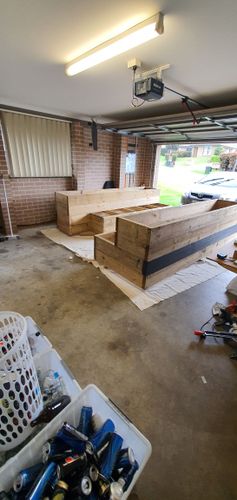

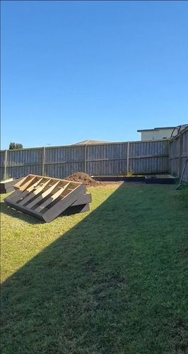

 I pre built all the pieces in my garage added supports for the seat base and the base of the planter areas and then painted all the pieces.

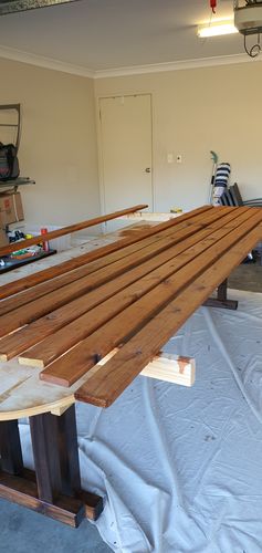

Stained some decking boards

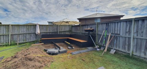

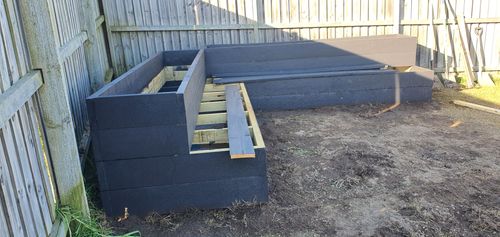

 And then took it all out the yard to piece it all together.

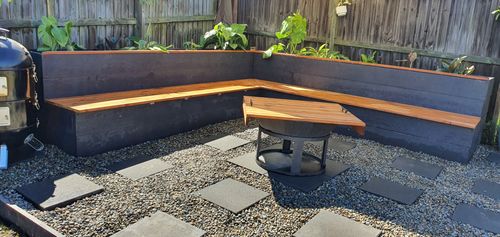

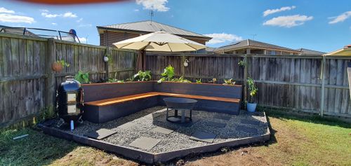

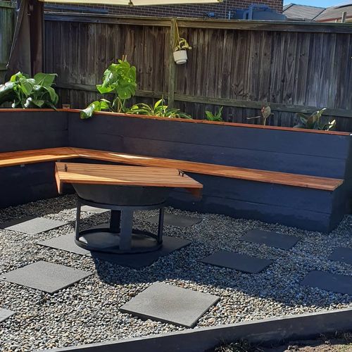

After that it was just a matter of creating a boundary to contain the pebbles and put pavers and a firepit in.
I built the lid for the firepit so that we can use the area for entertaining year round as it doubles as a small table.
The area has already had a good workout as we had our wedding reception in the backyard and it was where everyone wanted to be.
