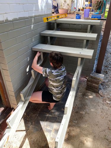

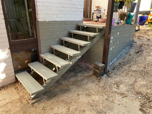

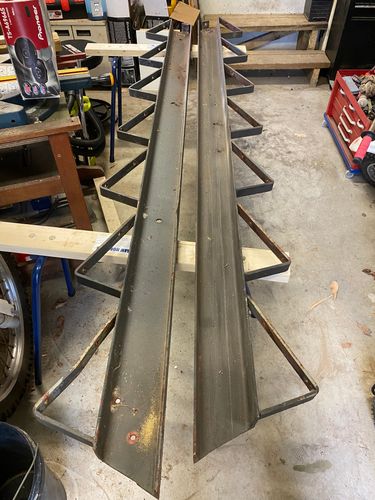

Bought some used stair rails from Gumtree and cut them down to size.
Cleaned them up with a wire brush and welded on some brackets.
A coat of primer before 2 coats of gloss enamel.

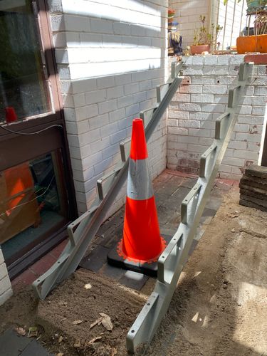

Bolted and concreted into place.

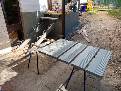

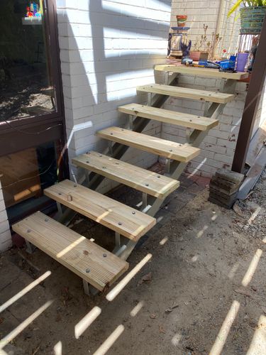

Marked, drilled and test fitted the treads before removing and painting.
Painted with a met roller using Dulux Weathershield low sheen and now ready to fit.
Assistance on hand with smaller fingers for the bolts.
Stairs done.
Next is the handrail.
