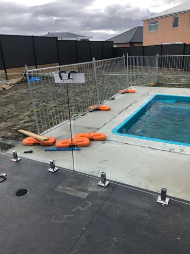

we are doing our own frameless pool fence as fencing companies quotes us $5000 for labour only.
we have couple of issues.
1.  concrete is unlevelled and we realised that after installing 4 panels. How do we resolve this to ensure everything is in straight line ?
2. The glass panel is now stuck in the spigot. Any way to release this ?

I'm sorry to hear that your glass panel is stuck. I suggest trying this method. The spigot has been installed at an angle causing the glass to be wedged between the two spigots. The panel is often held in with grub screws that act as a clamp to hold the glass in place. Make sure the grub screws are loose. Once you have confirmed that the grub screws are loose, lift the cover cap of the spigot and see if you can reach the mounting nuts with a shifter. Loosen the nuts to allow the spigot to align itself with the glass. This will remove the pressure from the misaligned spigots and allow you to lift the glass out.
Professional installers have shims or rubber inserts to align the spigot if the cement base is not perfectly flat. they also use cement grinders to remove excess cement if it proves to be slightly high.

You can buy small stainless steel clamps that fit horizontally between the glass panels; similarly affecting the alignment like the clamp at the top of the glass in the image you attached. Fitting these will align the tops of the panels perfectly. There are also small adjustments generally within the spigots themselves, if you tighten/loosen the top/bottom grub screw in each spigot. This should solve your issue of alignment.
If the panels are stuck, id first advise taping a towel to the panel either side of the one you're trying to remove. This will ensure you have no broken/damaged panels. Assuming you've already loosened the grub screws holding the glass tight, pry a piece of timber underneath, and slowly raise one side of the glass, then pack underneath it so the glass stays that height. Now do the same for the other side. Gradually work the panel higher and higher while someone holds the balance of the panel at the top, until the panel is free enough to be pulled out. Now you can make micro adjustments to the positioning of the spigots as needed.
If your glass is running out of level, and you can't pack it enough underneath, you can also add a few packers under the glass between where the glass rests on the spigot. You wouldn't really want to pack higher than 5 - 10mm for this method though.
If you have any issues feel free to message me, I'm an installer myself.

That’s amazing information for us. Do you know what the packers are called in Bunnings ? I am getting window spacers as search result.

Yeah window spacers or horseshoe packers they're called. You just chop them to size as needed with some snips (be careful not to cut your finger as they can be hard to cut). These are what i'm talking about: https://www.bunnings.com.au/macsim-75mm-mixed-hang-window-packer-20-pack_p1041490

It's great that you've received fantastic advice from @blueyryan. Using the Macsim 75mm Mixed Hang Window Packer - 20 Pack is a great way to even out your spigot installation. I recommend using Rocket Medium Sanding Sponge if you need to sand down the shims to get a very precise fit. Have you managed to remove your stuck glass panel? Are you making progress with your installation? Any updates about your project would be much appreciated.

Could I please ask how do I cut the packers? Hack saw or do I need a machine ? Sorry for my ignorance.
