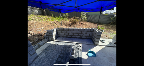

1. We built out the bbq area using blocks

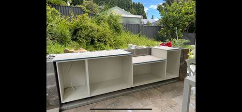

2. We put in the Kaboodle cabinets

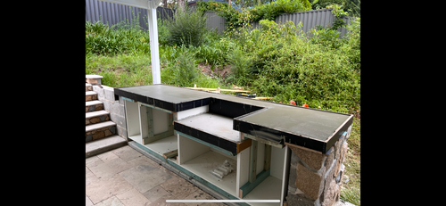

3. We formed up and poured a concrete benchtop

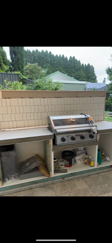

4. We build a splashback and tiled and grouted it

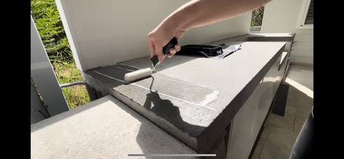

5. Polished the concrete benchtop and sealed
it

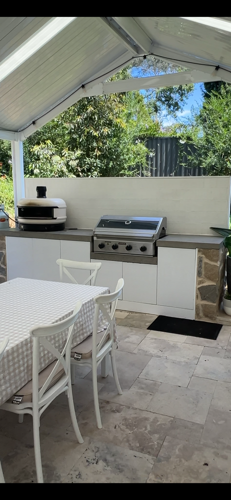

6. Put in the BBQ and here is the finished product

What an impressive build, the clean lines, stone paving cover and concrete benchtop just pulls it all together to create a solid looking BBQ area that will provide years of service.

Would love to know the kitchen cupboard sizes you have used from Kaboodle please?

Let me tag @RenovisionAU to make them aware of your query. Looking at the cabinet sizes on the earlier photos, it appears to be:

We used two 450 base cabinets and two 900 base cabinets, we cut one of the 900 cabinets down to fit the bbq.
we concreted a benchtop to protect the cabinets.
