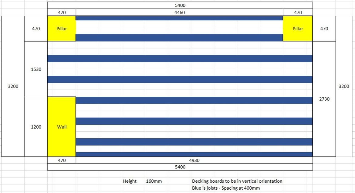

I've been reading all the posts and got some knowledge on how to start with my first ever DIY.
Below is how the measurements look.
I have few questions on what tools and materials are needed.
Thanks,
AB

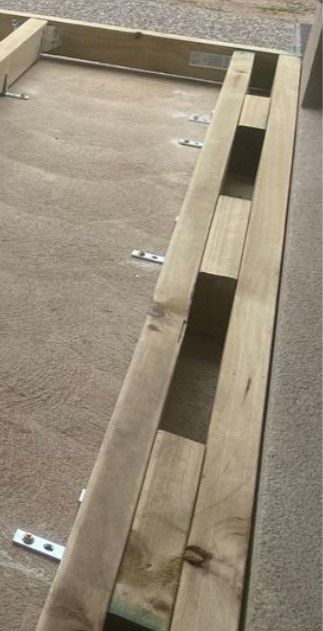

120mm H3 timber is not readily available, so you would look at using Treated Pine Outdoor Timber Framing 90 x 45mm on pedestal feet. Do you want a picture frame around the deck's exterior using 140mm timber like the image below? If so, you'll either leave space to fit the frame when laying decking boards or install the frame boards first.

Yes, I would want something like that. Referring to other community posts, I think I should do something like this to get the 140mm border.

It would be best if you framed around the pillars and the perimeter to nail off the decking boards. Otherwise, your joist placement looks fine. You could pack up under the 90mm joists, but that is quite a height, and what pedestal feet are designed for. If you are to place brackets between 600mm and 100mm would be ideal.
