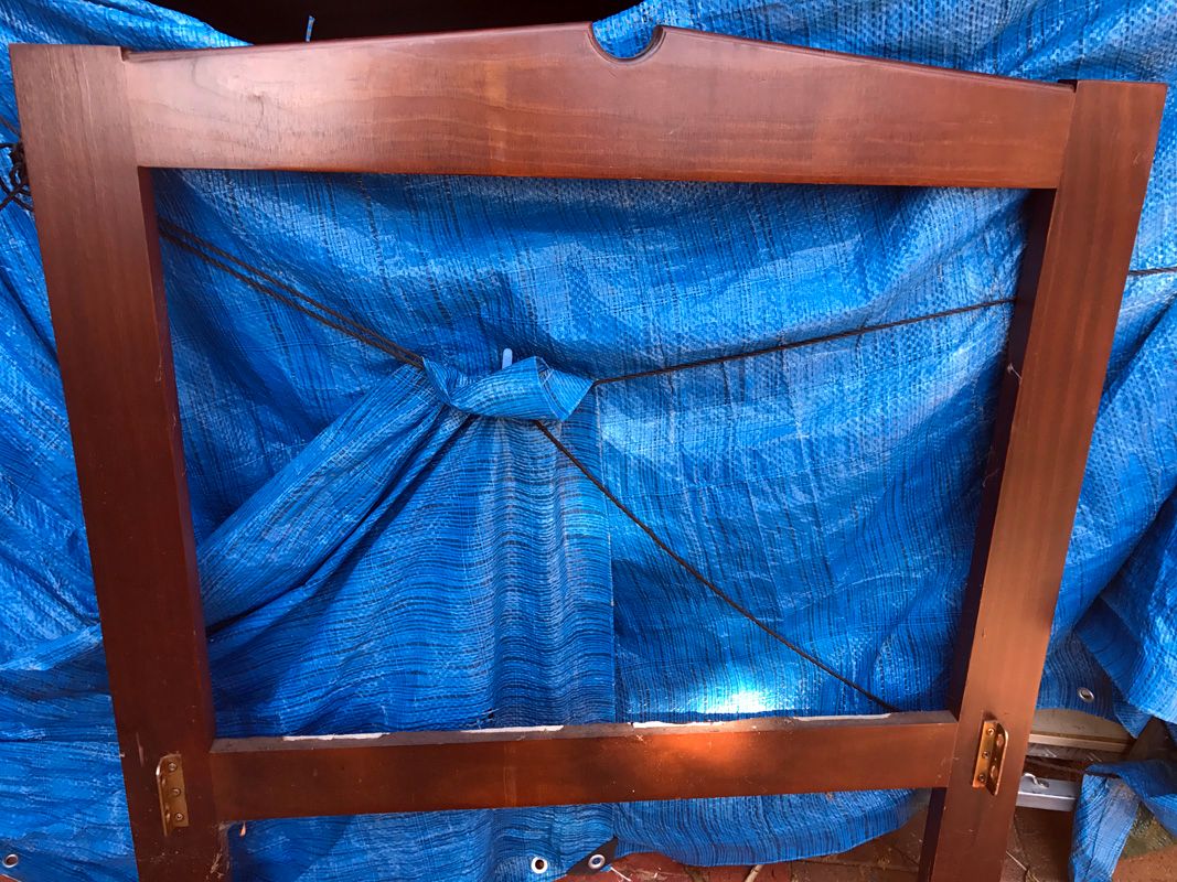

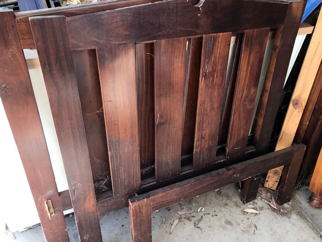

I had some single bed headboards that I picked up cheap from auction and the slats were the ideal width for the Cabinet enclosure.

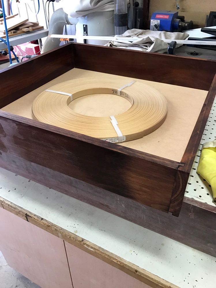

I trimmed to size on the table saw then using a Dado Blade stack cut in a rebate for the 5mm mdf backing board and a basic locking joint for the sides and top & bottom.
I had some cork tiles laying around and trimmed them to size so that 4 covered the back board.

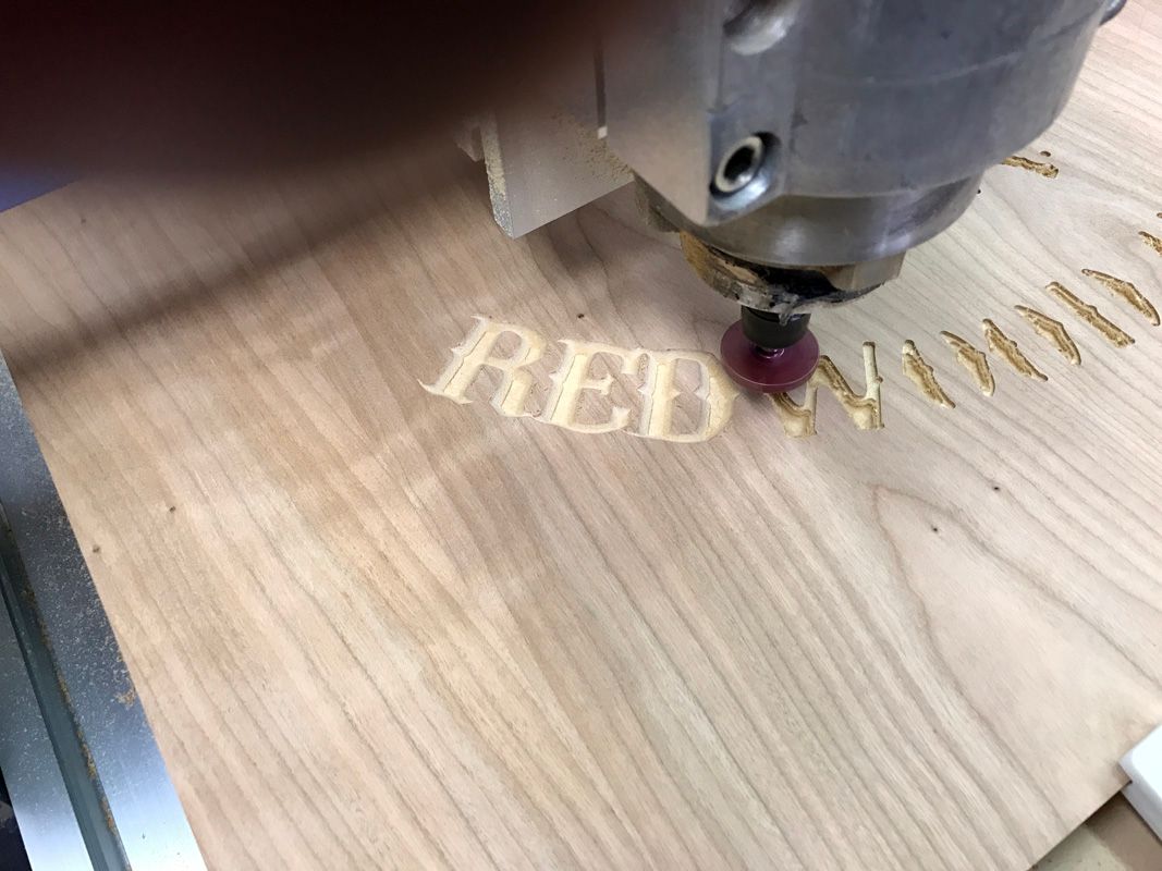

I searched Google and found a suitable image for the front door, I copied it into the CNC software program then manipulated the size to suit. It does a rough cutout of the bulk using a 3mm straight bit then I change the Router Bit to a 90 degree engraving bit for the detailed work.

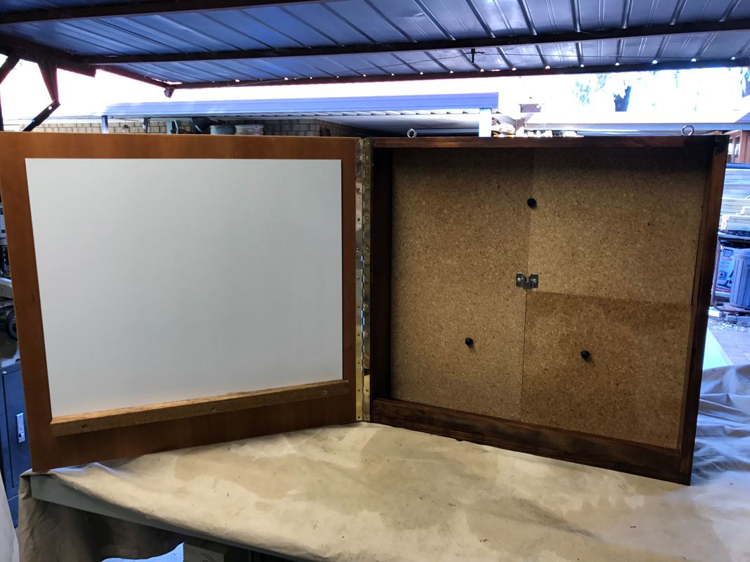

Then it was just a matter of finishing everything off, I cut some white Aluminum Composite to use as a white board score card and made a small shelf under it for the white board markers, I added a small piece of board at the bottom of the cabinet to create a tray area for darts and accessories, I used some brass piano hinge to hang the door then added a magnet closer and a brass pull knob (not shown) Several coats of Minwax wipe-on Poly and the project was finished.
