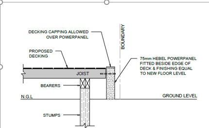

According to my draftsman drawing, my bearer must be fixed on top of the post. The bearers are double 90 x 45 H3 F7, and the post is 100 x 100 F7 H4. The joists are single 90 x 45 H3 F7. (I am from Victoria if that matters)
This is for a 6.7m x 3.3 m low level deck with an estimate of 450-600mm deck height.
The joists are connected to a 190 x 45 ledger which is screw mounted to a brickwall.
My question is for the bearer to post (stump) connection. If I use a T or L plate to fix the bearer to post, I can only fix the bearer on one side. The plate won’t flush on the other side because of the 10mm gap (90mm sitting on 100 mm). If I use a nail plate, I will have to bend it a bit for the 10mm gap. My option is to just mount the L or T plate on one side and bolt it through and through on the laminated bearer or ask the draftman if 90 x 90 is sufficient so the bearer is flush on the post, and I can use plates on both sides.
Do you have any recommendation on how to better fasten the bearer?
