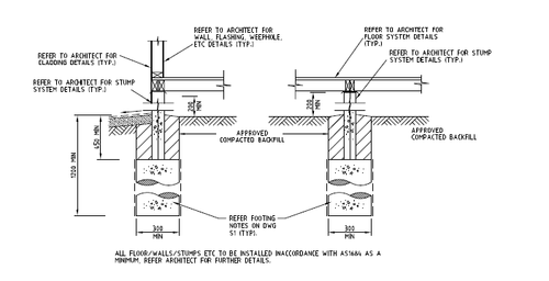

I was hoping someone could help me understand the plans for the footings certificate I have received for my deck? From what I gather I need to dig holes of 1.2m, fill that with 800mm of concrete and and then sit my stumps in at least 450mm below ground level? This was set by council and seems like overkill.
I also have to cut the site to allow for 200mm spacing on the underside of the bearers and have to move a lot of dirt in doing so. Any recommendations for this? Thinking a Kanga Digger.
Thanks for any help!
