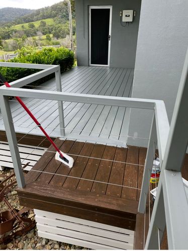

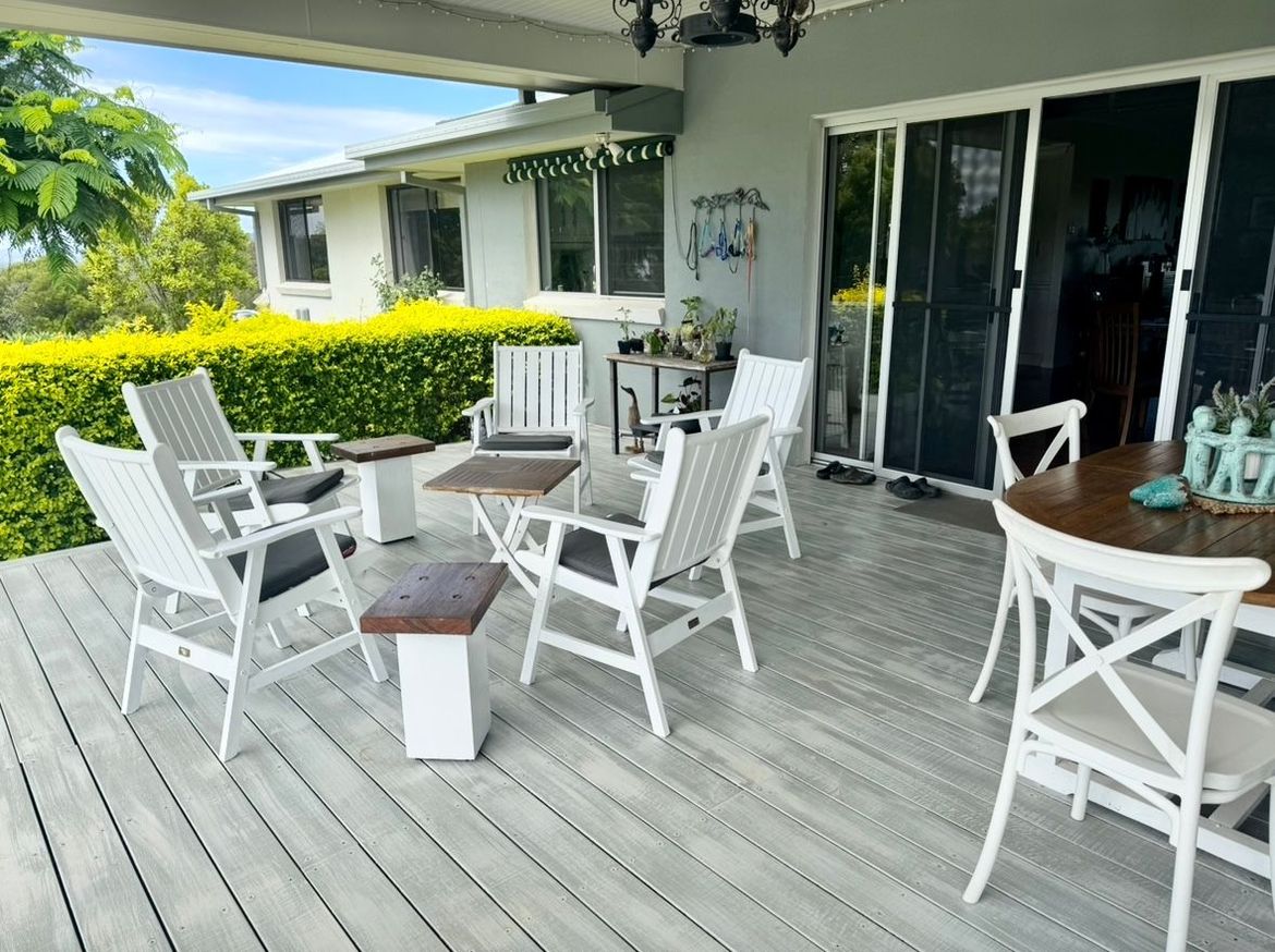

I wanted a more modern look on our three deckings. They all were dark brown stained timber which showed every footprint and bird dropping.  I was washing the decks every week,  so decided to lighten them.
I didn’t want the finished job to look like a flat painted deck so I lightly brushed the second coat to give a weathered timber look.
After painting the decking I also painted the brown stained furniture white which completed the look I was after.

Steps
Step 1
Wash the decking and lightly sand
Step 2
Paint the darker grey first coat covering the boards well checking to see the edges are also covered.
Step 3
When this  coat is dry, paint the lighter grey top coat over the boards using long strokes and a wide paint brush. This coat is almost like dry brushing. It picks up any grain and imperfections on the boards to look like weathered timber.
Step 4
To complete the over all look, paint the furniture with two coats of Prime and Paint. An undercoat and top coat all in one. I washed the furniture but didn’t  bother to sand at all.
Step 5
I was very pleased with the finished products. I now only have to wash the decking occasionally as footprints and bird droppings are far less noticeable.The decking looks like weathered rustic boards which was the effect I was looking for.
