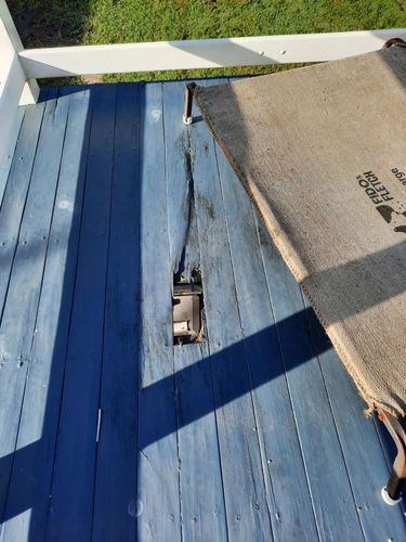

Our back deck needed replacing, especially after part of it gave way under hubby's foot, thankfully he didn't fall through it.
We thought it would just be a matter of replacing the deck but we opened up a can of worms.

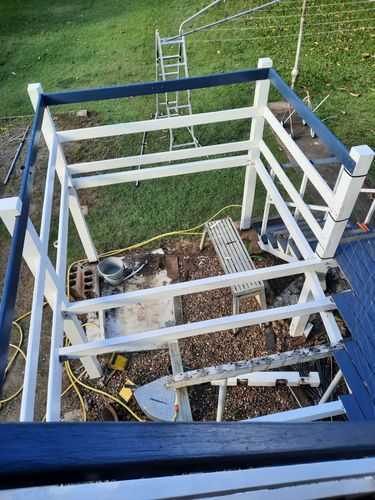

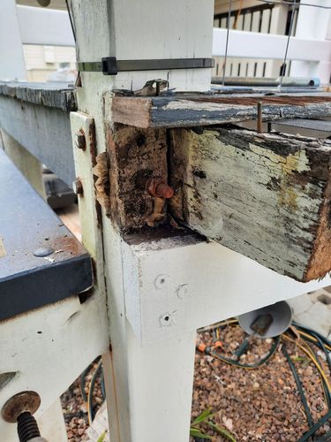

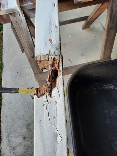

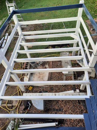

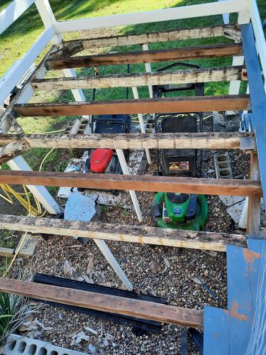

We removed as much of the old decking as we could while still leaving a path for us to get up and down the stairs. This revealed every second joist needed replacing as well as most of the bearers. Two posts also needed replacing when we found them to be quite soft around the middle.
Every second joist needed replacingEvery second joist needed replacingSome areas flaked awaySome areas flaked away2 posts needed replacing2 posts needed replacing

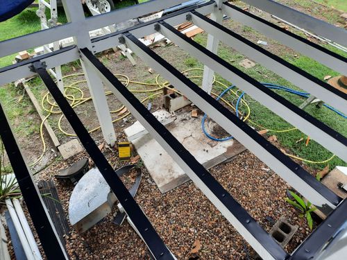

We removed sections at time to fix up or replace, I primed and painted the existing good hardwood joists as well as the new hardwood ones we bought from a local timber yard. I also primed and painted the new posts and bearers ready to go in. I'm afraid I didn't take many photos during the process. In reality this whole thing took over 6mths as we found it all quite daunting at first.
We still needed to keep a pathway so we removed the nails holding the deck to the bad joists and threaded the new ones underneath. We also had a temporary fence between posts to prevent dogs and grandkids from falling through the open deck area.
Removed and replaced sections at a timeRemoved and replaced sections at a timeReplaced all joistsReplaced all joists

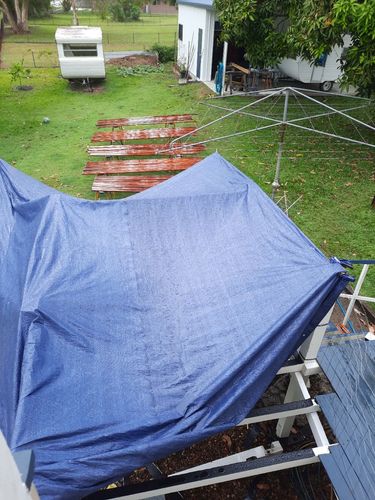

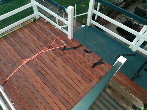

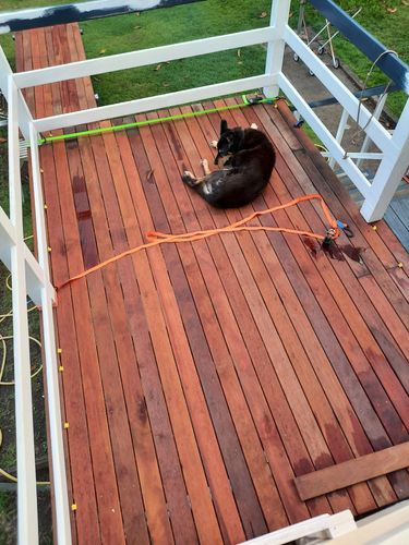

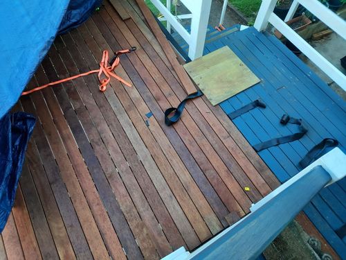

With the hardest part finally done, we were able to move onto laying the deck. We had bought the merbau months previously and had laid it out in the weather for a few weeks to remove most of the tannins etc so it didn't run all over the new paintwork. Some lengths were a little bowed so we used ratchet straps to pull lengths straight against deck spacers.
Protectadeck stapled onProtectadeck stapled onSun and rain protection while workingSun and rain protection while workingFinally making some progressFinally making some progress

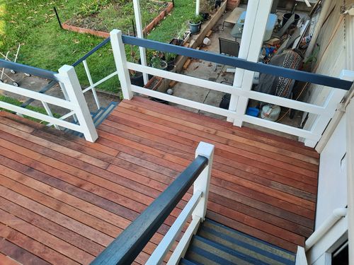

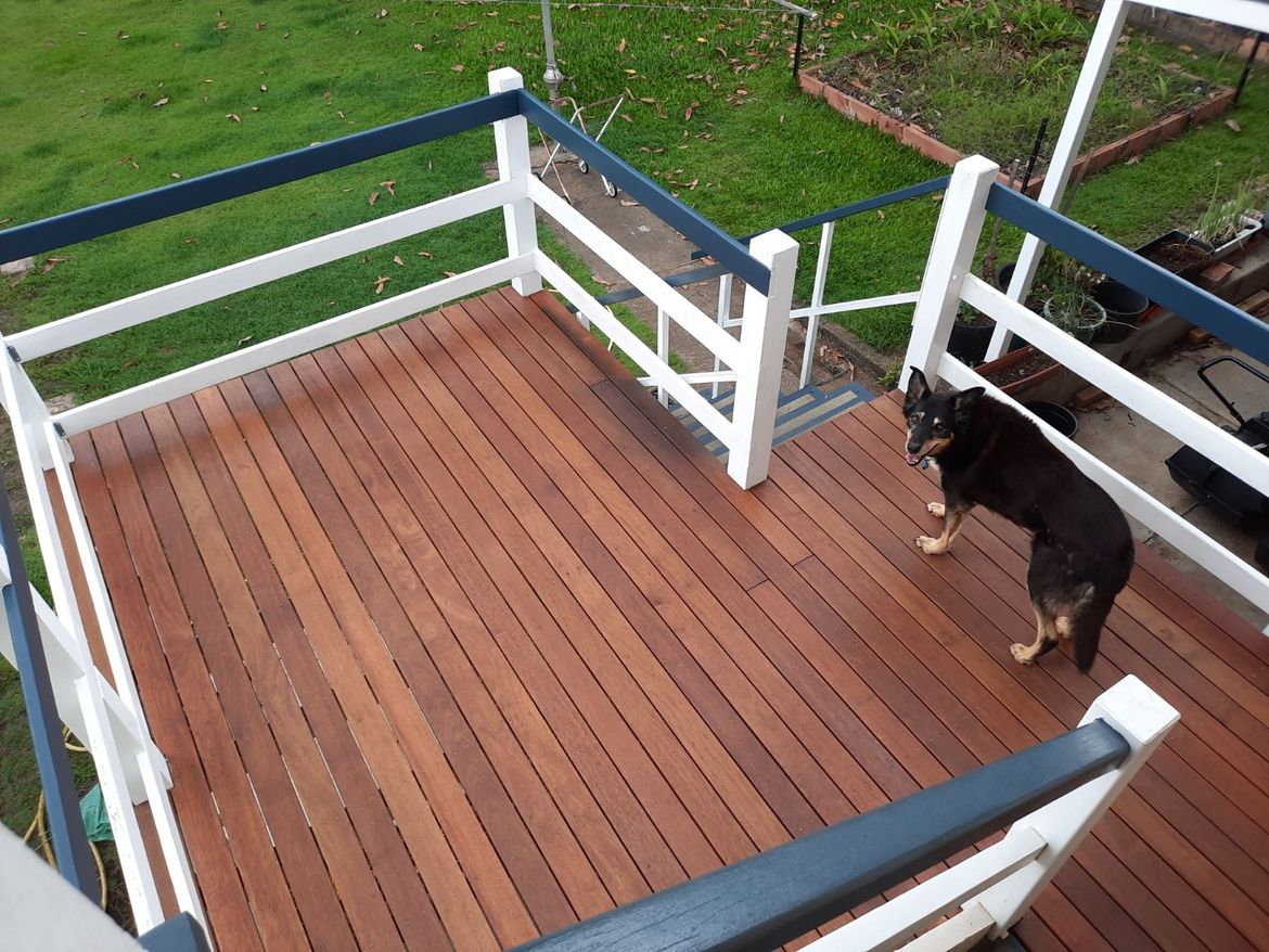

I have a new respect for deck layers, my back absolutely ached while laying this down. I had two drills and an impact driver set up, one with a drill bit, one with a countersink bit and the impact driver with a square drive bit in it. Hubby got hit with the flu just after starting and I couldn't just leave it so continued on my own.
Working our way acrossWorking our way acrossSite fore-girl never far awaySite fore-girl never far awayFinally made it across to the other sideFinally made it across to the other side

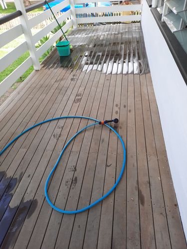

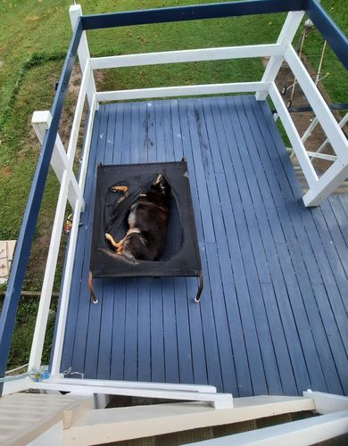

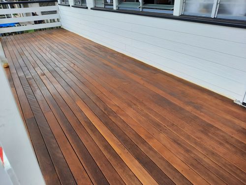

With the deck now laid, I gave it a good scrub with nappysan, rinsed and then applied 3 coats of Timber Protect Decking oil.
oiled and doggo approvedoiled and doggo approved
Step 6
Our deck only used less than a litre for 3 coats, so I took the remainder over to our daughter's deck, cleaned it up and it drank over 6 litres with 3 coats, hadn't been done in a long time.
Scrub with Unipro deck wash, pressure washedScrub with Unipro deck wash, pressure washed3 coats3 coats

Scary stuff. I'm glad your hubby wasn't injured when the decking board gave way. It almost looks like every second joist was replaced in the past leaving the ones that have subsequently rotted to the same fate. I'm glad you picked it up before further problems happened.
The new merbau decking looks great and I'm sure the Protectadeck 45mm x 50m Flexible PVC Joist will keep those joists strong and free from rot for a long time.

I really am impressed with your deck, it looks like a professional job! Well wirth the effort!
Long live ratchet straps is all I can say :laugh: They may be a pain to set up but are worth their weight in gold!
It would have been scary seeing the hole (and almost going through it) then uncovering the rest.... Makes me think its time to check my deck :smile:
Huge effort but the results speak for themselves!

Thanks Jacob. Yes there was a definite age difference between the joists and also how they were fastened in, the newer ones had joist hangers while the older ones were bolted with heavy right angle brackets. We bought this place just over 2 years ago and our neighbours told us that the previous owners had only just replaced the deck! I think they only replaced/added in the extra joists and painted the top, it definitely hadn't been replaced in a long time. When we moved in, the deck looked freshly painted, 18mths later there were dark patches appearing so I knew we'd have to do something about it.
 Dark patches started appearing through the paint. And yes, I replaced her bed even though she loved this one so much.Dark patches started appearing through the paint. And yes, I replaced her bed even though she loved this one so much.
