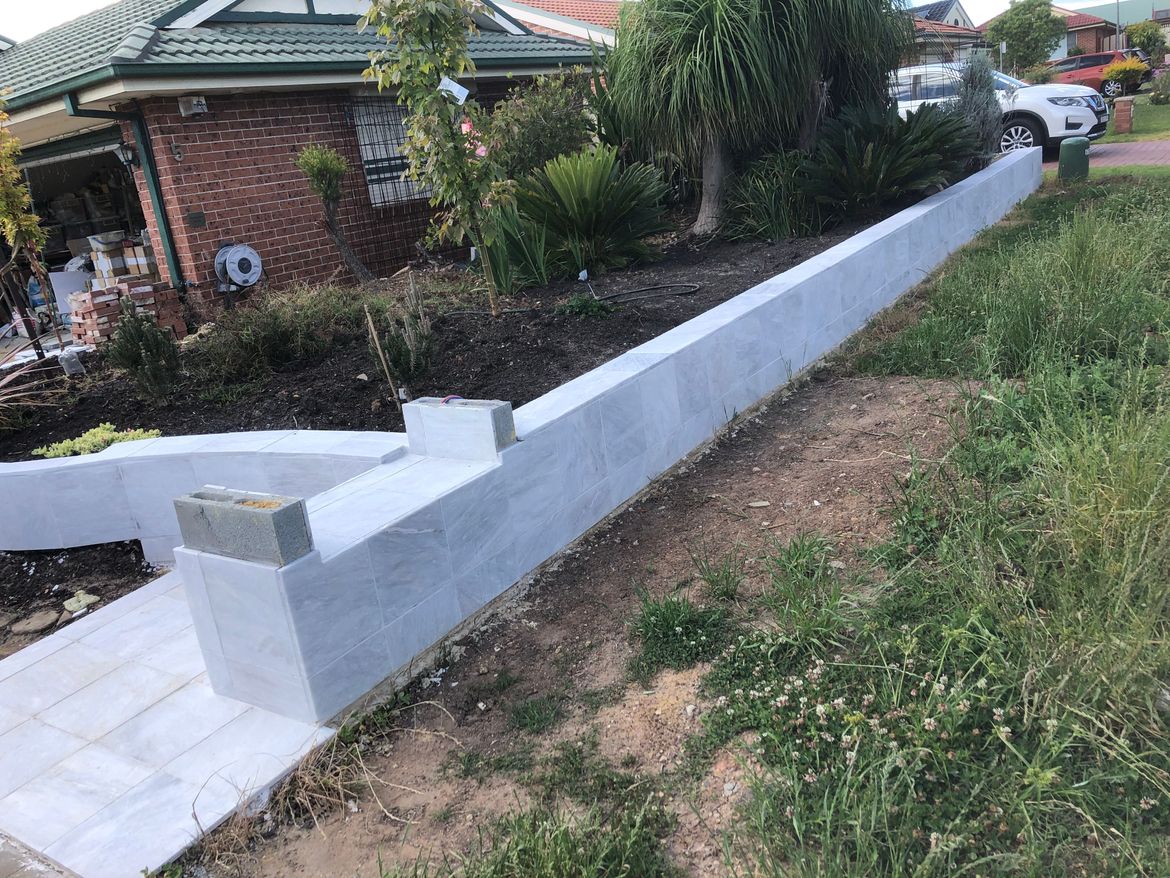

Hi @AJ-DIYer
I just finished a 2 row  besser or cinder  garden wall.  You want to go 3 bricks Height thats 600 ml,  It really sounds like your retaining earth ie a retaining wall which will need a solid foundation like @EricL  said.  Your local  council will  have some minimum specifications too.  But 600 mm height should be under  planning approval height,  I meantion this so you can build a great wall lol no one can question later on.
If you want that to be a forever wall  I highly  recommend  a  bare minimum of a  300x 300  square cement footing with  trench steel along the entire length.  I also recommend an agriculture  pipe  to drain  water build up  bedded in  crushed  20 blue metal rocks behind the wall if you know water collects in that area. Once you have that footing 300 x300  the wall will be a breeze to make with two pegs and a taunt string line . And please use mortar mix it wont  take you long  to get he hang of it. make sure you use waterproof gloves as  cement will dry your hands out touching it.  I used  liquide nails in the garden gluing loose  bricks in after a  bumping  them loose it seams to fail in two years and this surprised me.
I think EricL meantioned you can fill the insides of the besser/ cinder blocks(Cement sand or soil) and that makes them near indestructable
I love working with the 390 x 190 blocks as they are  easy to build with and the naturally are stable even  uncemented  when you  lay them over lapped like  brick,
If you want to try no  cement  foundation well that is possible but movment may occur at  later time.
Scrape out  flat dirt base and simply water for a couple days and earth will settle fast enough (dont use sand here) Go for it lay your cinder blocks and pack them in a little dirt and water it the added dirt will find  hollows and lock the blocks it tighter and wash underneath fillin any viods. and there is the option  of earth filling thr bricks. Ilke doing this as it add thremal insulation to  plant roots from a hot sun.
Note the cement footingsNote the cement footings
