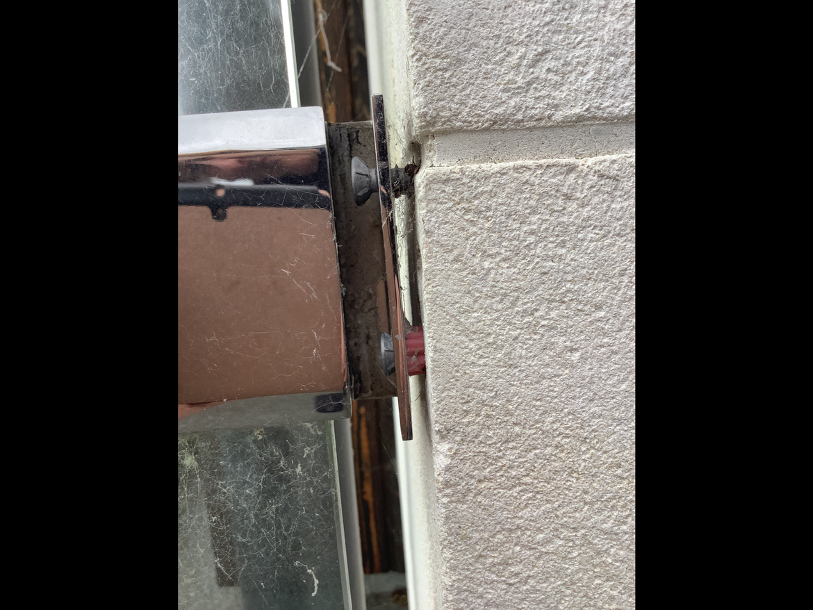

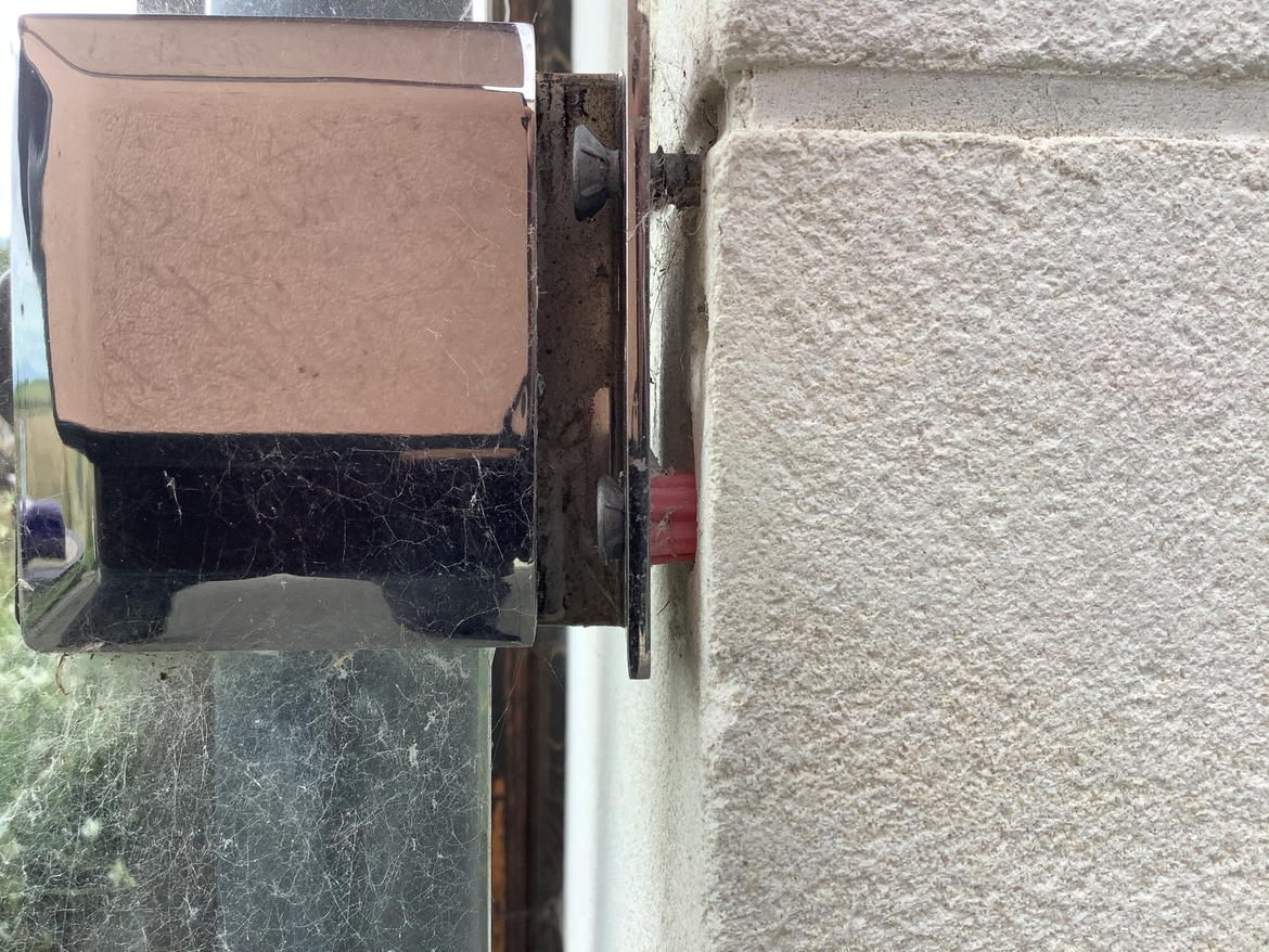

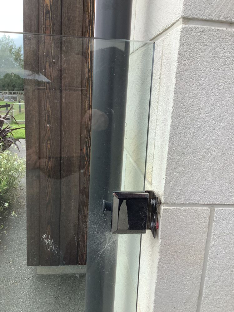

Hi. I have a glass balustrade door with laych drilled into Oamaru stone as below. The screws are working loose as picture shows, with giggling of the door in wind etc, and I’m wondering if I try squirting in some liquid nail to hold the screw and the plug in place? This was already a patch up job by a builder. Thanks

For a one-off job like that just use a better quality brick anchor.
