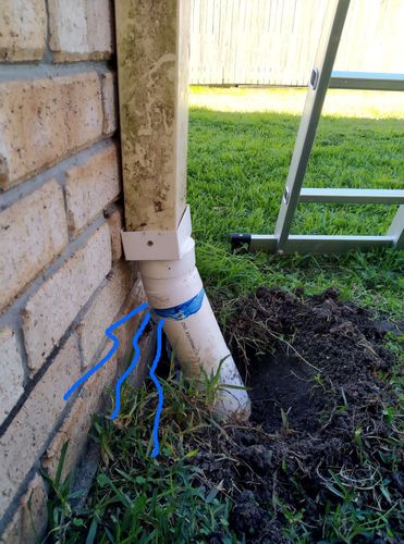

Okay, hard lesson learnt . We  hired a handyman, instead of a plumber , to replace a sector of downpipe.
But the junction seems not sealed with insufficient blue glue. And some water can leak at the back of the junction.
Fortunately it is not serious because the gap is small.
So we are after some products such as sealant to seal the gaps from outside.
Should we use blue glue ?
Or Shelley's all clear sealant? 
Thank you for any suggestions.

What should have happened, is that there needs to be a square to round transition at the bottom of that downpipe.
As well as a couple of 45 degree bends and shortened PVC lengths to get down to the ground.
Couldn't be any easier.
Also, you only use plumbing adhesive on pressure pipe (as in it has actual water pressure on it), that is a rookie mistake
in itself.
The actual pipe fittings you need are DWV (Drain Waste Vent).
One final thing, having water off your roof, wash into your foundations, is probably not the best, that could cause subsidence over time where your foundation could sink with the water getting under it.

"What should have happened, is that there needs to be a square to round transition at the bottom of that downpipe."
I don't understand this answer. Isn't that a square to round transition in the photo?

Have you seen water coming out from that joint? Unless the pipe isn't inserted far enough into the fitting, I would have thought it shouldn't leak even without glue, with the low pressure trickle from the roof.
Is it possible there's a blockage further down, and the water is filling the pipe?

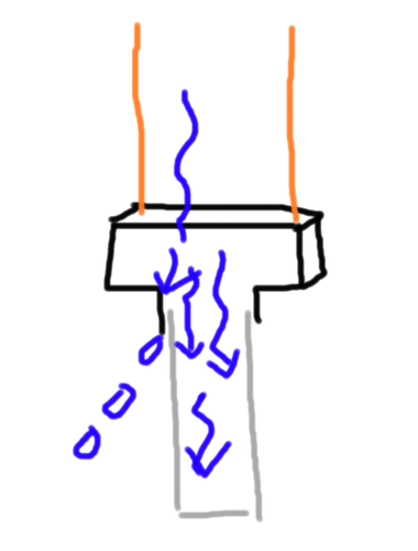

@pstq The square to round transition is enclosing the pipe below from outside, and the pipe is not vetically straight, so that leads to a small gap
And we see water coming out

I would have thought the square to round had enough slack in it to let it twist to match the angle. Maybe they didn't cut the pipe straight, or struggled to jam it on properly before the glue set.
I think if there's no danger of the joint separating then it would be easiest to just silicon the gap up. The blue glue is a solvent to "melt" the two pieces together, and can't fill gaps.

It's great that you have received fantastic advice from @MikeTNZ and @pstq. If the leak is only very slow and small, I suggest using Selleys 290ml Clear Storm Waterproof Gutter And Roof Sealant. Selleys Clear Storm Sealant delivers a waterproof seal on almost any material, and can even be applied in the rain to stop leaks immediately. Please keep us updated, we look forward to seeing the leak covered.

No it isn't, that is meant to be a bracket at the bottom of the downpipe, that looks like it was broken off to allow the plumbing work to happen.
If you look a bit harder, the round pipe has been put up inside the square (or rectangular) section of the down-pipe, that is why it is leaking like a sieve.
It needs a transition installed on it to funnel the water into the round pipe, from the downpipe.
