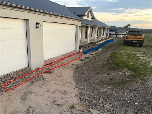

I am after some advice on what to do to get the stormwater drainage right at our new build.
I am about to put in a gravel driveway and there will be a ~5-10% grade down toward the garage. I plan to install a series of channel drains at the bottom of the driveway to carry stormwater towards an easement (on the other side of the house).
My question is, can I run this channel drain (in red in the photo) into the ag pipe that I will use along the front of the house (in blue in the photo) and then to the easement? Or given the volume of water, is it best to run a seperate pvc line from the channel drain to the easement and keep the ag line its own seperate system? I’m not sure what the “standard” approach is here.

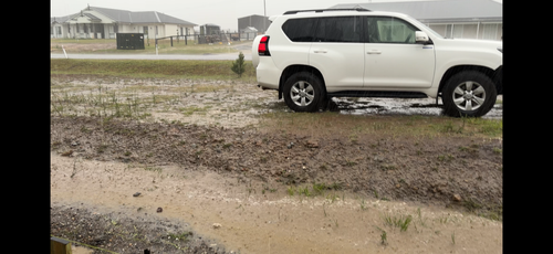

For some reference, the photo below shows the volume of water that was running along the front of the house (where the ag line will go) during a recent storm. The ground is clay so there is puddles for days after rain, hence the need for ag line.

Good Evening @jordan106
I never trust ag pipes to stay clear, those corrorgated ribs just scream that they wiul catch silt, even if they are socked. Id go for a PVC pipe for sure :smile: You are going to the effort so why not mnake sure you dont need to revisit it in a year or so.
I would also install a Pit at one end of the drain in front of the garage. Just to collect rocks ect and a cleaning point if needed.

Hi @Dave-1, thanks for the quickly reply.
Would you still use ag pipe to get the surface water away from the area in front of the house? I will need to do something and I’d rather not use a series of drainage pits there.
Understood about the pit next to the channel drain, and then running PVC from there. That makes sense to me
