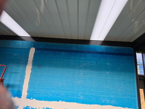

I applied the dunlop Fibre Cement Jointing Compound onto blueboard last night and won't be able to sand it off until Friday will that make it harder to sand smoothly?
What is the recommended time frame to sand it off? I read on the container to allow 4hrs  before sanding is there a maximum time when it will be difficult to sand. And l baked it on heaps oops

Hi @Davy,
The Dunlop Fibre Cement Jointing Compound is intended for use as a base coat as opposed to a topcoat. This means that it sets extremely hard to create strength at the joints. For this reason, regardless of the time frame that you leave it, you will likely have considerable trouble trying to sand it to a smooth finish.
My suggestion is to scrape and sand away any hard edges and then apply a wider coat of James Hardie Compound Top Coat over the top of the jointing compound. This is a topcoat designed for use with fibre cement, so it is much lighter, smoother and easier to sand.
Let me know what you think and if you have any other questions, please don't hesitate to ask.

I tried  sanding th joint compound off using 150mm 180 grit however  it's barely sanding as l applied heaps.l am concerned that when l apply  the render the raised places will get less render is there a disc sander l can use
Re: Dunlop Fibre Cement Jointing Compound sanding timeframe?
Hi @Davy,
You could use an orbital sander to speed things up, but the main change I would make is to use a much more aggressive sandpaper such as 40 grit.
As this is a base coat, it will end up getting covered, so there is no real need to be gentle as you are not aiming for a perfectly smooth finish. Just try to remove any hard edges or obvious lumps and the render should cover the rest.
