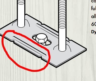

Hi @UncleAz
The levelling is the most time consuming part of the whole process. But then again if you take your time and get it right then the laying the boards is the easy part.
In regards to layout of the joists. I was told by Demak who I sourced the joist supports from that the easiest way to do it is lay your joists 90x45mm treated pine on the floor. Make sure they are spaced 450mm centres as recommended. And then with a builders pencil trace the side of each joist onto the concrete. Then remove the joists. The advantage of doing this is when you lay the klevaklip down to secure it to the slab it is actually marked where the joist will be with 2 grooves.
I've circled the image where the grooves are.
I hope this makes sense. I also would recommend using all galvanised fixings being outside for the hardware associated to the Joist Support.

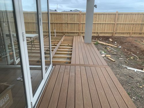

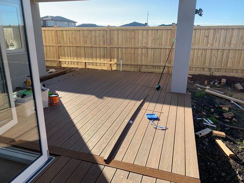

Hi all,
It's taken a while to complete but I really appreciate all the help people gave me in my prep work. I completed this a while ago. I agree with @bruce93 that using the klever klip was really time consuming when it comes to the levelling of the joists it becomes time consuming. I would probably use a different method if I was to do something similar again. But here are some pics of my work. I had to adjust some things after these pics because they weren't perfect and I kinda get frustrated looking at something that isn't the way I wanted it.
