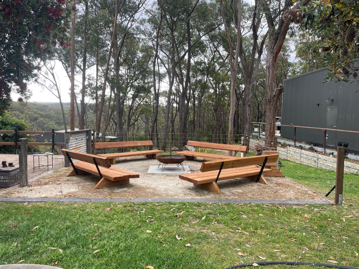

A sloping part of the garden was turned into a relaxing area to watch the sunset over the gully.

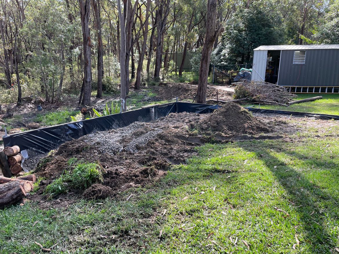

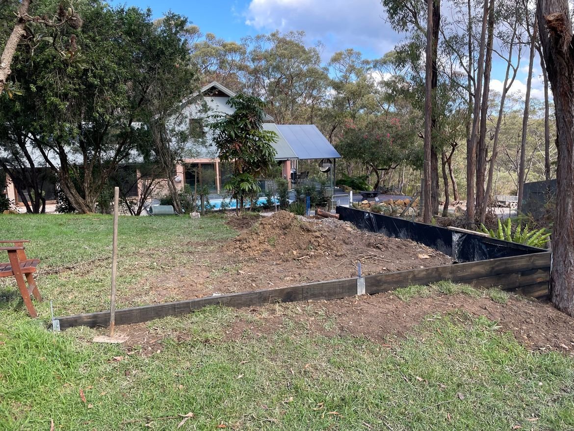

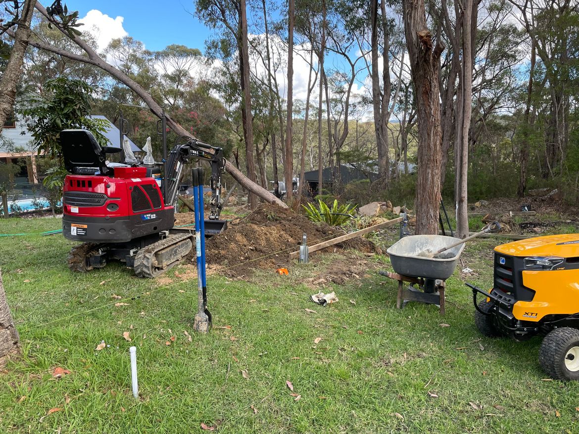

Excavating and building a retaining wall using treated pine sleepers, with gravel backfill and plumbing for drainage to build up a 6 metre by 6 metre area with compacted gravel ground cover.

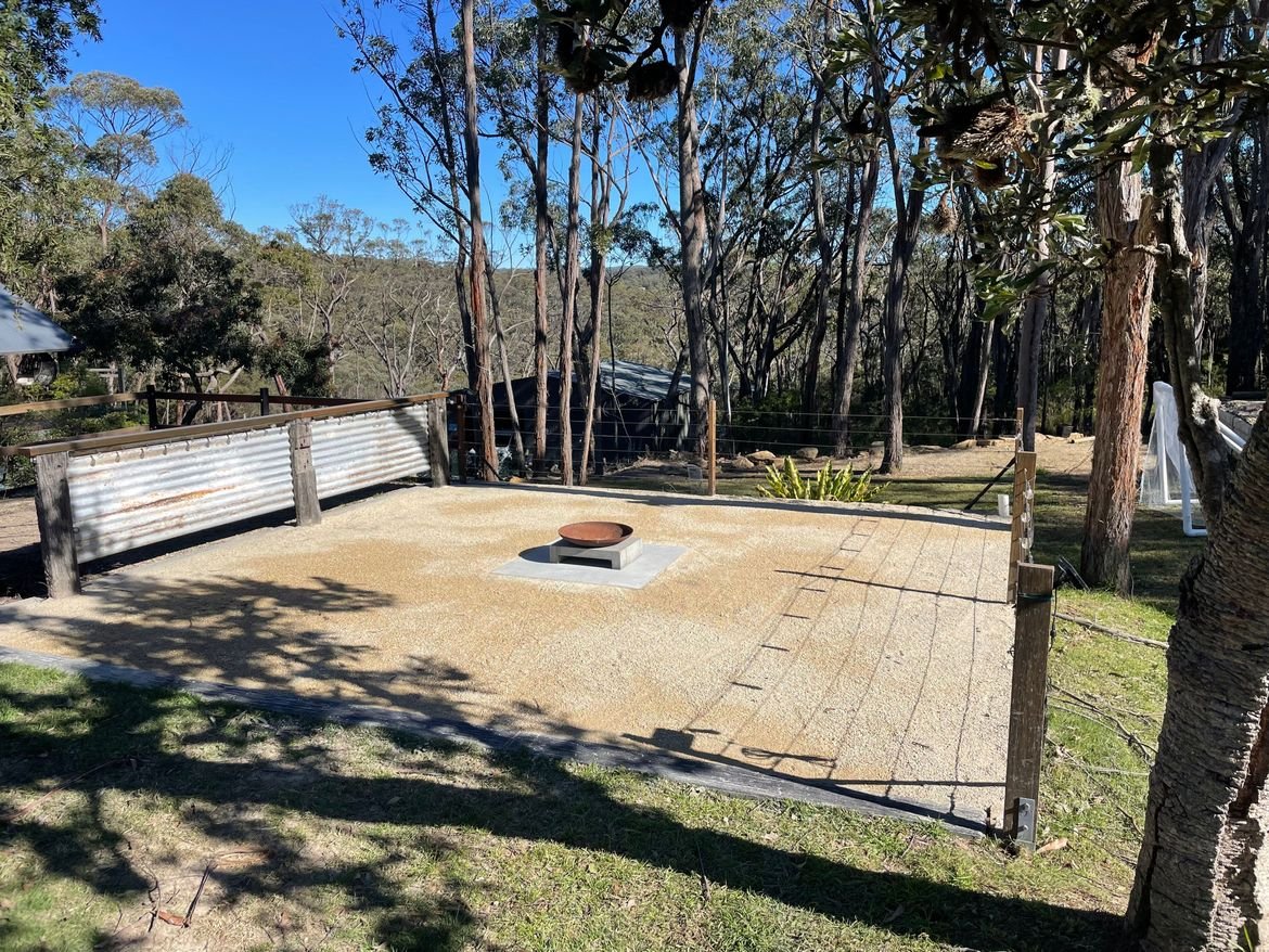

Benches are home made with Sienna treated sleepers, and stainless steel wire rope fencing to allow for maximum view. A perfect place for star gazing under a clear evening sky.

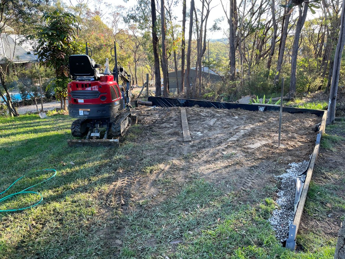

Excavate for the retaining wall.

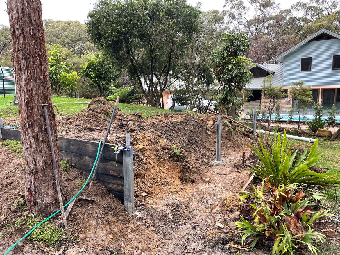

Build retaining wall and backfill.

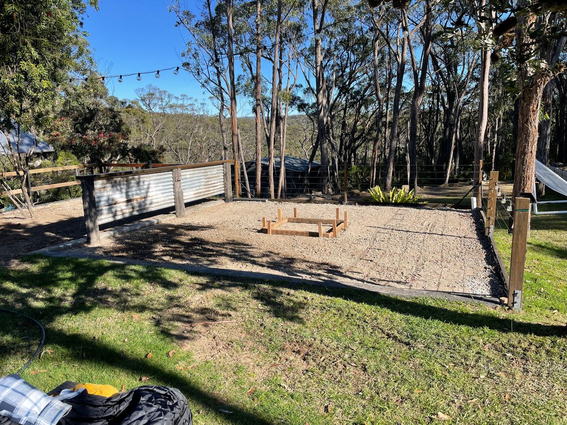

Lay and compact decomposed granite. Pour footing for fire pit.

The eventual finished product.
