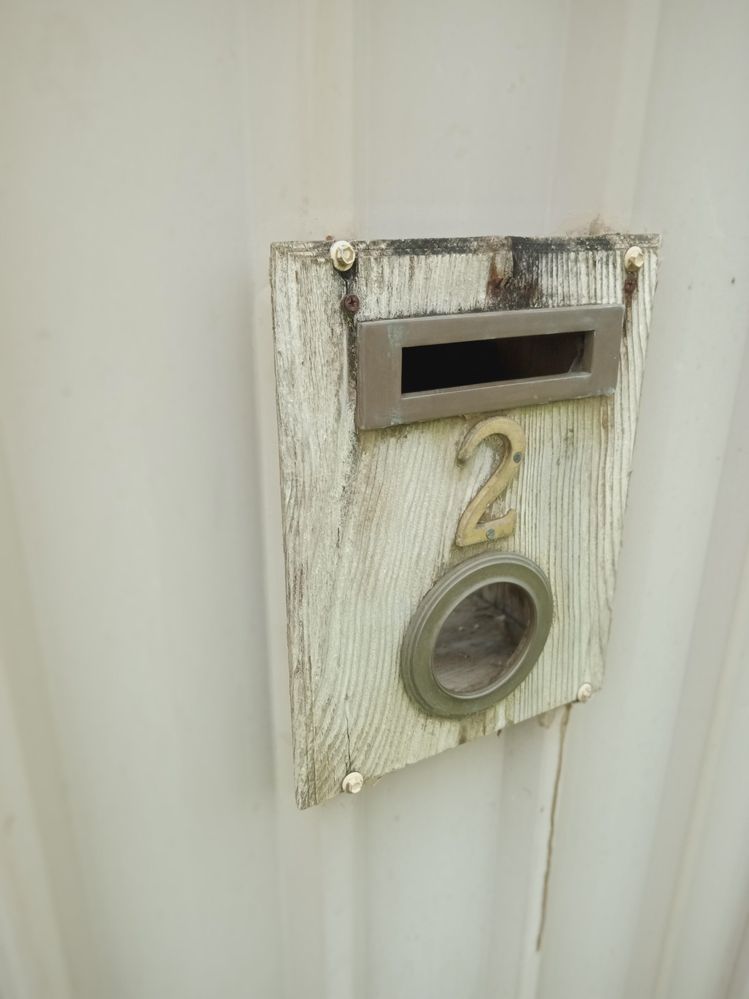

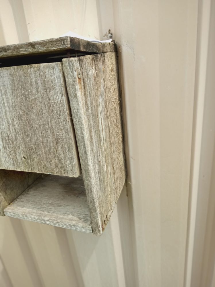

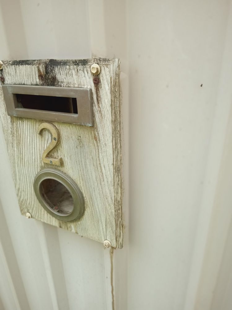

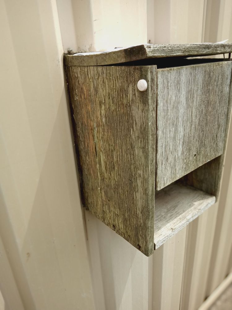

I have a letterbox that is already in place measure 220w x 290h x 180d
My new letterbox is 195mmW x 300mmH external
inside 175mm W x 260mm H x 255D
fence is colourbond, so I need to take care of any adjustments necessary.
My
New Letterbox
Old Letterbox 1
Old Letterbox 2
Old Letterbox 3
Old Letterbox 4
Old Letterbox 5
Old Letterbox 6

I suspect that the cutout in your fence is actually smaller than it appears. I recommend removing the current mailbox to determine how big the cutout really is. Once you've established that it is smaller, then you can simply cut the necessary hole with Tin Snips to fit your new mailbox.
However, on the off chance that the cutout is bigger than your new mailbox, I suggest using the front of your old mailbox and cutting the centre out of it and using what's left as a filler for the side of the new mailbox.
