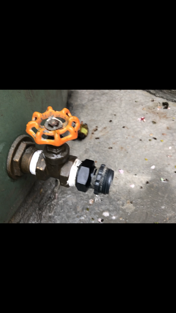

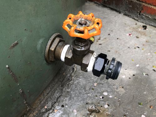

We have a rain water tank and there is leak in the plumbing.  Please see image for the plumbing.
You can't make out from this photo, but there is a drip leak, with a drop leaking every second or so.   I tried uploading a video but unable to. So please allow me to describe as best as i could.
If you look at the second image closely, you can make out a drop - Although it appears as if the drop is from the middle of the black part(sorry don't know what's it called ), the waterdrop comes out from the open mouth, travels back underside and then drops down from the middle :smile:
I have tightened the tap(the round -orange thingy- again don't know the name)  as much as i could but no joy.
Is there anything that i can do  ? Any suggestions please.

Hi @bm,
If you are certain that the water is coming from inside the black fitting then that indicates the gate valve is faulty and allowing water to bypass it. A couple of options, the first is just to replace the gate valve or if the tank is full you might find it more convenient to just attach a secondary valve after the first leaky one and leave it in place.
In order to install an additional valve, you will need to unscrew the last black fitting, then screw on a new valve and a poly nipple so you can screw the last fitting back on. I presume the last black fitting is from a tap adaptor which allows you to click your garden hose on and you wish to keep it.
I don't believe there are any serviceable washers inside a gate valve as it is a copper gate that stops water passing through the unit.

Thanks @MitchellMc  for the options. While i look further into these, Please are you able to advise on the white strapping that appears on the valve?
what is that?
thanks
Highlighted
Re: Fix water leak from Rainwater tank
@bm,
The white strapping is thread seal tape and is wrapped around the thread of fittings before joining them together. It is used to seal the threads and stop water leaking through them.

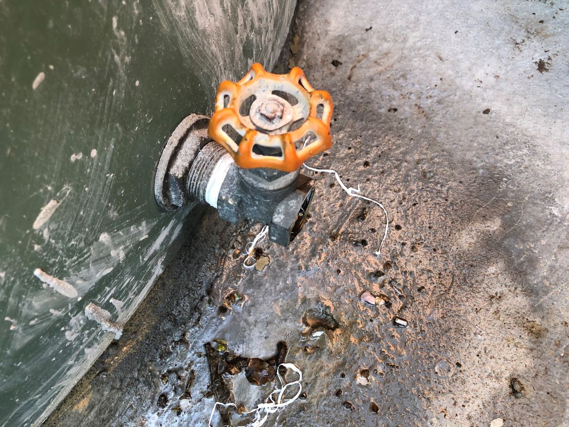

Please see attached photo.
I have now managed to remove the nipple- there was some damage on it so thought of removing it.
As you suggested  , I am going to plug in another  valve , retaining the existing valve- so i don't lose the water load.
Now to connect the new one to the existing valve, Wouldn't  I would need a  "joiner" -  joiner  with the same sized sides? both valves are 1 inch.
Would Bunnings have this joiner? Please suggest.  The poly nipples , as i understand have differing sides.
Sorry, normally i would have gone to the shop and asked , but in locked down Vic  I am not allowed..
Thanks

Hi @bm,
The "joiner" you'll need is the nipple that was removed. It provided a male thread at one inch for your female valve to screw onto. If you need a new nipple this Philmac 1 Inch Threaded Bsp Pipe Nipple would be suitable.

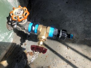

I used the the following:
https://www.bunnings.com.au/kinetic-25mm-brass-gate-valve_p4790286
Philmac 1" Threaded BSP Pipe Nipple)
Garden Rain 1 x 3/4" Poly Irrigation Reduce Nipple) for the Tap Adaptor to go in.
All thanks to the Bunnings team, I have now managed to install these and voila, there is no leak .
I retained the original valve as is, so i did not lose the water load.
