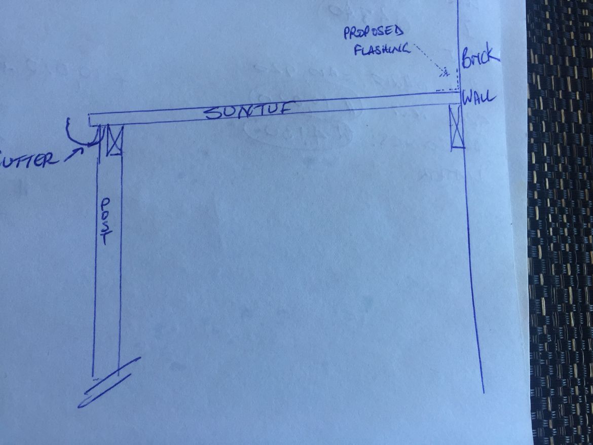

Thanks Mitchell. I can't attach the flashing far enough down the roof to hold it down with the foam underneath it as the top perlin (?) is right on the wall (is 45mm thick). I agree with the Sikaflex and I intend using the flyscreen profile Bunning has with a screw and plug into the mortar line. I will have to use a smaller flashing so it doesn't flap around in the breeze....which means: I have kind of thought I could Sikaflex a shaped bit of something at the end of each of the Suntuf's valleys up at the end under the flashing. IMG_1283.JPG

Re: Flashing a polycarbonate roof against a brick wall
Your flashing need only extend out onto the roof the width of the infill strip @Russ42. Since the infill strip is only about 20mm wide, you could use rigid Metal Mate 32 x 25 x 3.0mm 1m Aluminium Unequal Angle. Mount the 25mm wide side to the wall, and the other side will extend out 32mm over the roofing. Before fixing it to the wall, sandwich the foam strip in between it and the roofing.
Makes sense, thanks Mitchell. I can't see a problem with that at all. Excellent! I will see what stainless steel B has to do the job. We are close to the beach.
