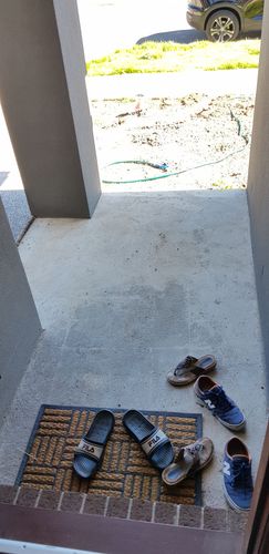

Hi @MitchellMc @Dilanka here is a picture of the area in am planning to deck. The height if from the slab to make it flush with the brick is 165mm. The wife was hoping to run the decking board perpendicular to the wall, so i was thinking I'd have to run the joists parallel to the wall. Also what is a picture frame deck ?

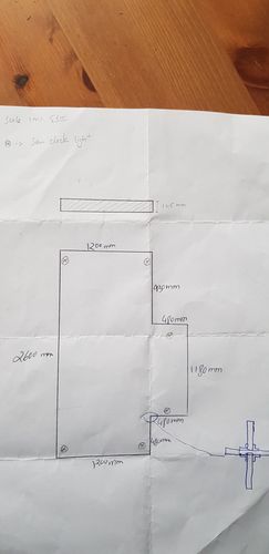

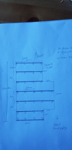

Having browsed through more posts and finding out what picture framing, span of timbre and decking boards are, i drew this up. What to run it bu you guys before i go order some timber. Please let me know if this is correct the frame and also if i can do a picture frame deck with this frame layout.
Thanks in advance guys.

Once you have removed your decking board thickness of 19mm from the overall 165mm space, you'll be left with 146mm. I'd then suggest using Treated Pine Outdoor Timber Framing 90 x 45mm for the frame and joists. You'll find you have 56mm remaining to finish flush with the bricks. The Builders Edge Pedestal Foot Smallfoot 35 - 60mm can adjust the frame to be flush for you. You're correct that you'll need to run the joist parallel to the walls to achieve the desired board layout.
A picture frame deck is when a gap is left around the perimeter when laying boards and is then in-filled with a framing board. I'll add an image below to illustrate.
