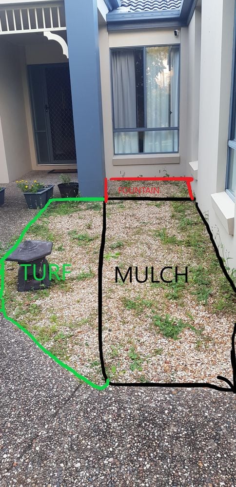

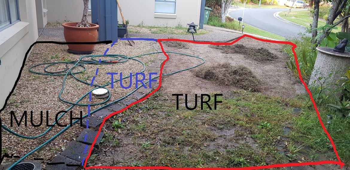

I am working on my front yard project. Following are the images and what I am planning to do. I am laying turf, mulch and installing Water fountain. My question is: Is it okay to use Mulch close to wall? I am asking this I am planning to plant some flowers on mulch after laying them. Will the mulch attract termites? I would really suggest if you have any suggestion on this.

They say you shouldn’t have garden beds against the house walls  because it can encourage termites to gain entry into the house. You could use stones/pebbles and some beautiful pots and maybe have  a garden bed away from the house walls

Welcome to Bunnings Workshop. Thank you for sharing your diy project with the community. In these situations I would probably suggest using timber sleepers against the house or even bricks to provide a buffer against the mulch. Mulch tends to hold moisture and might become a source of mold against your wall. So by providing a buffer such as sleepers or bricks you have that measure of safety. Looking forward to the finished project.

Thank you all for the advice. So I was in the right direction. I was feeling reluctant to use mulch against the house wall. @LisasGarden I like your idea of beautiful stones or pebbles. I think I will go with this. The only thing I am worried about is the weeds growing from the ground when pebbles are used. This is the current case as you can see in the picture. I like to control weed growing also.

You could lay down weed mat  or shade cloth etc first to help control the weeds and then the stones.

Although uncommon mulch can attract termites but more often what it does is provide cover for them to get into the underneath of your house unnoticed. That's a major problem.
Two solutions...
- Cypress mulches are termite repellent, tea tree mulches too but probably not for the longer term.
- Pebble mulches will also work well as termites are unlikely to travel underneath them to the house.
