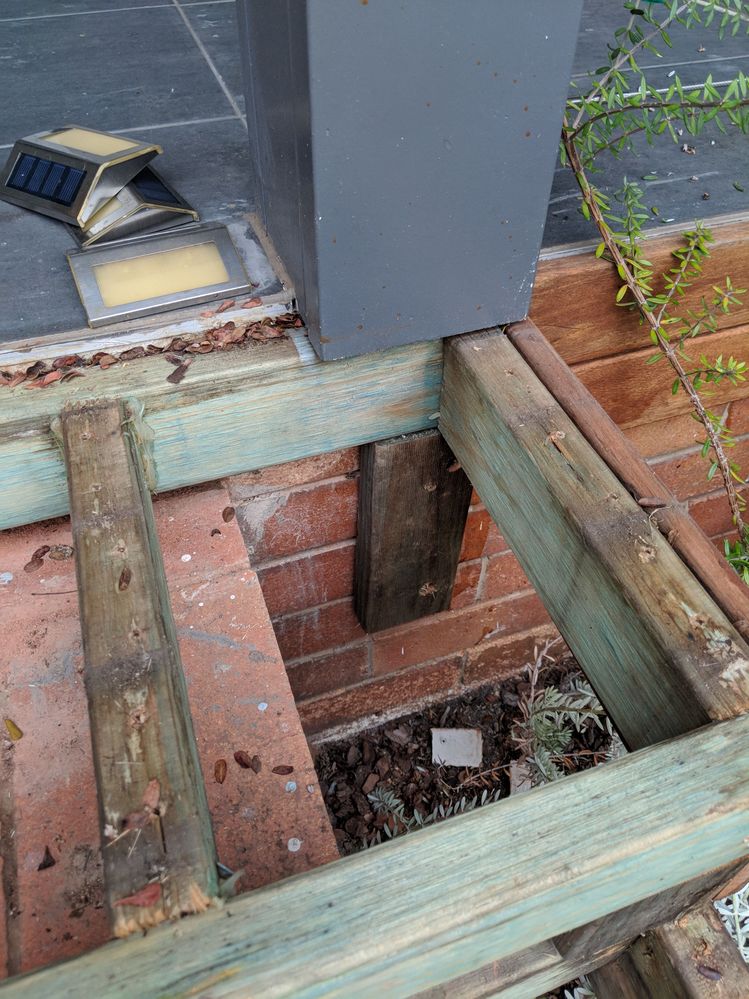

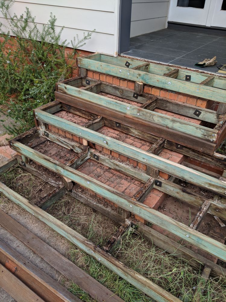

I have attached a photo (first image below) of the previous frame that was built by the flippers. I am looking to avoid the mistakes as this was the result after only 3.5 years. If I am to do this again, I would hope for much longer than that in longevity. I think the mistakes they made (but please confirm/add others) are:
1. They have bolted the boards direct to the vertical riser face enabling water to be trapped
2. Where they didn't need to elevate the frame, they bolted direct to the horizontal tread
3. They didn't apply any kind of joist protection strips
4. Appears it was only H2 treated and not H3, judging by the colour(?), but I could be wrong about that. I assume H3 would have been more resilient to the drainage flaws/lack of joist protection strips?

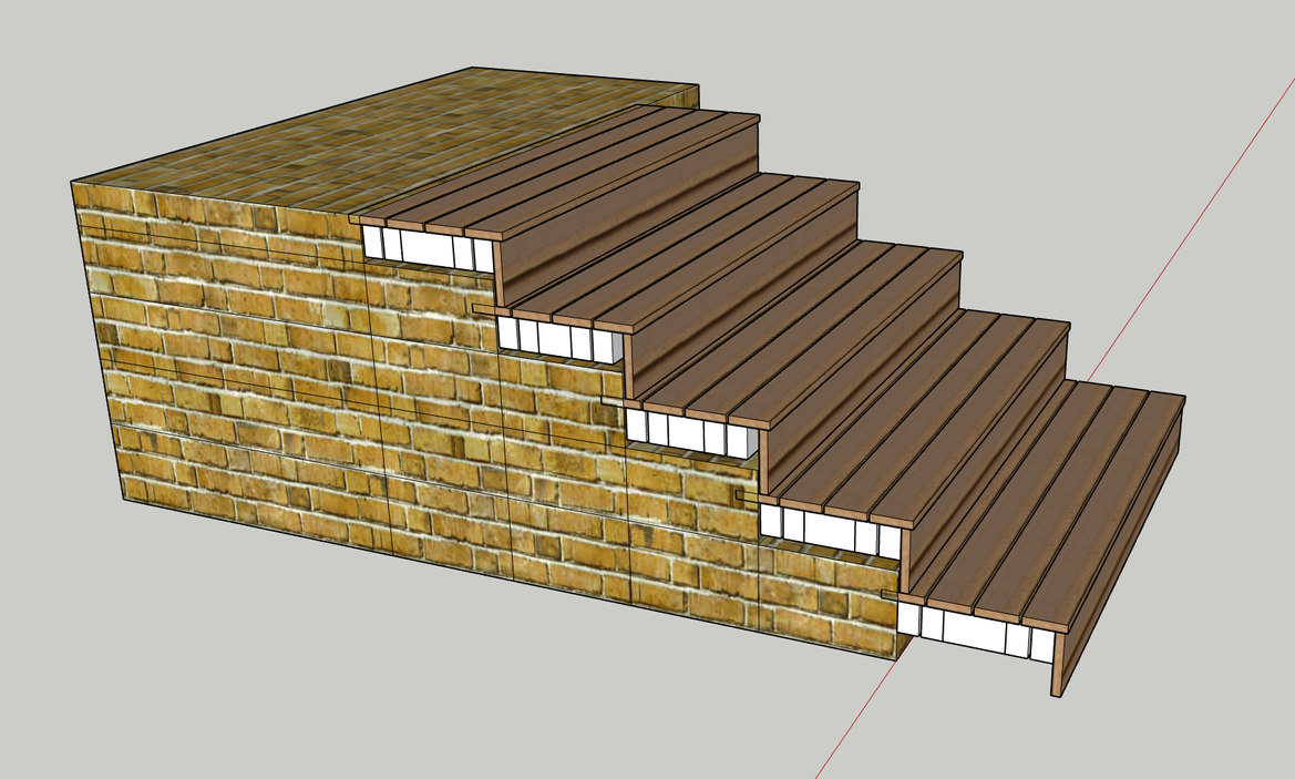

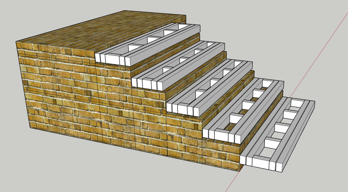

1. Rebuild similar frame with H3 - and allow at least 5mm gap (using spaces/shims - is that enough drainage clearance?) to any brick work and use a PVC joist strip to cover all horizontal elements of the frame (see Sketchup design images below). Materials include:
  • 70x45mm H3 framing throughout which allows for the space below each frame box to the underlying brick tread
  • 90x19mm merbau decking for treads
  • 140mm merbau decking for risers (single board seems to be working out better than trying to run 90mm boards behind each tread, or cutting them down)
  • Still need to figure out how I am going to support the frames. The space beneath each frame is about 25mm at most, some as little as 15mm. The only exception is the bottom stair frame which drops about 65mm to the concrete path.

I'd have to agree with your suspicions that it's actually H2 termite resistant timber not suitable for exterior use. They were my thoughts as soon as I saw that blueish treatment. By replacing it with H3, you'll see a significant lifespan increase. You might like to also spray your frame timber with TWA Woodcare 300g Ecoseal Tanalised Timber Treatment or paint it with Bondall 1L Inground Timber Protector, which should bring the H3 treatment closer to H4, which is suitable for inground use and semi-permanent water contact.
I'd follow a similar connection process to the one they've used. Dynabolt into the step's riser and use angle brackets to Dynabolt the frames into the stair treads. The frames can be supported and raised on plastic shims.
