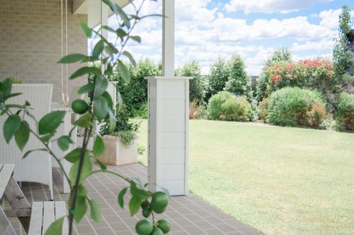

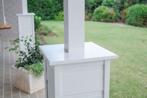

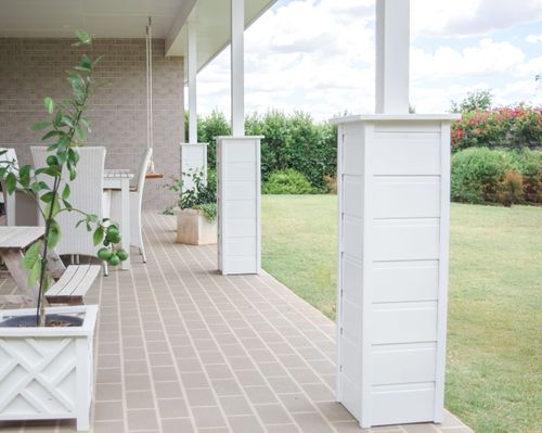

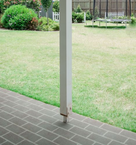

Over the weekend we completed a little project - we turned our skinny posts into something pretty amazing.
We even completed a DIY tutorial with all the links to a Bunnings shopping list if you wanted to try doing it yourself. www.Hamptonsinhighfields.com/blog

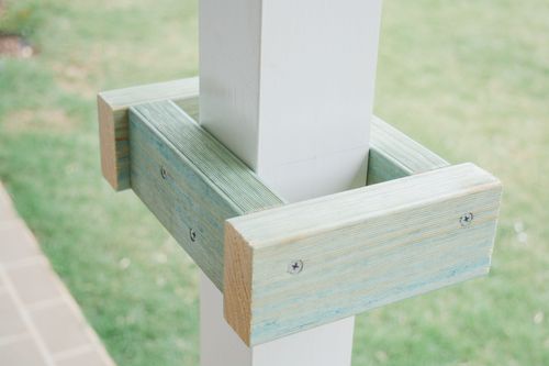

NB: we have a 6-10mm gap so it’s allows for both ventilation and water run off. The new structure does not touch the ground and the original stirrup is still in place preventing termites to climb. We also have an Instagram full of inspirational ideas 💡www.instagram.com/hamptonsinhighfields
