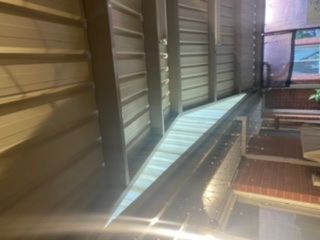

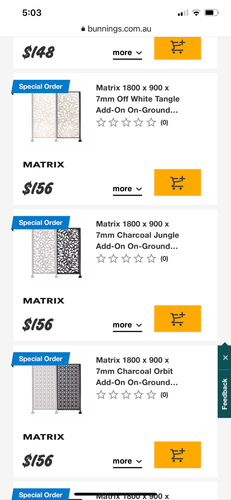

Hi there. Im hoping someone could help me figure out what I would need to put a few screen panels as a room divider in the verandah. We have this huge concreted and enclosed verandah and to make it purposeful, we’ve decided to put up a divider. I’ve attached a photo of what Bunnings has to offer and was wondering, is this secure enough to stand on their own. Probably thinking of 3 screen panels. The verandah roofing is an A line roofing so I’m not sure how we go about putting something to hold he screens up. There won’t be any post to bold the screen to on both sides.

The set you asked about is actually a floor-mounted version of the Matrix panels. I would have to call the manufacturer on Monday to get more information on which kit you would need to join the 3 panels together. The Matrix floor mounting kit is made of steel and is strong enough to stand on its own. No ceiling anchor is needed to keep them standing.
Once I have the information on how to join the panels, I will relay it to you as soon as I can.
Re: Help put up Screen Panels
Hello @Jills
I've spoken to the supplier and they have given me the order sequence for you to join 3 panels together. Based on the sample you posted you need to order:
  • 1 full set of your preferred panel and an on-ground screen kit - This kit contains the panel, 2-floor standing posts, and the frame to hold the panel.
  • 1 set of your preferred panel and an Add-On On-Ground Screen Kit - This kit contains the panel. 1 post, and the frame to hold the panel. (x2)
These items will need to be ordered at the Special Orders Desk at your store.  I suggest using Dynabolts to mount your posts if you have a cement floor or a large diameter screw for timber floors.
