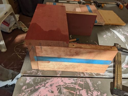

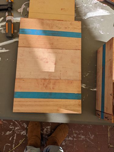

Using scrap pieces of wood from the Women's shed class (thank you Lana!!) I had 7 pieces of wood all measuring at 250mm x 125mm x 20mm. I arranged them into 3 pieces – to form a BACKBOARD
Then I needed to arrange the planter box which will attach onto the backboard. I have a front and a bottom that fit perfect to the back board. I cut two SIDE pieces from my extra pieces of wood measuring the equal amount of 125mm – 20mm of the bottom = 105mm. . .
Borrowing my husband's jigsaw, I tried to safely cut two side pieces. I learnt a lot - jigsaws are intense and whilst they look like it should do straight lines apparently, it's actually a circular blade that I need to get that straight cut (who would've thought?!) Borrowing my father-in-law's circular saw and after going back to Bunnings to replace the wood I ruined with the jigsaw. I asked the hubby to help me cut my sides (I didn’t want another repeat of the jigsaw disaster!)
Now I'm ready to put them all together!
* NB: My replacement wood was different to the wood from the Women's Shed – something I didn’t think would make a difference until I got to the staining stage... whoops!

With my wood pieces all smooth and ready to go - Let’s start with the BACKBOARD! I used some Tarzan Grip wood glue that I had lying around (can't remember why? But yay!) and I glued all 3 of my back pieces together on their EDGES and then clamped them in place – so they really stick!

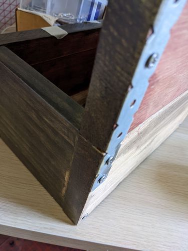

Because I want the backboard pieces to be stable and being a beginner, I don't entirely trust just glue to hold onto a planter box. With this in mind, I decided to use two STRAIGHT BRACKETS* to hold it all together. I think the ones I bought are for making your own brackets because the metal has notches in it and it bends quite nicely too! Whether they were the right thing to use or not - they did the trick!!!!
* Galvanised MAKE-A-BRACKET FLAT 20x2200x1mm by Carinya – they also come in handy to open paint buckets!!!
I placed my two brackets as close to each of their side ends as possible as well as placing along the line that will essentially also meet the box sides on the front.
I positioned the bracket holes so that TWO bottom holes were hitting the BOTTOM piece with just 1 hole EACH in the top two pieces.
NB: making sure that the holes you will be screwing into on the brackets don't hit the joining line of the wood.
I used SMALL screws in the top two holes so that it doesn't protrude the BACKBOARD. For the bottom two holes I used LONGER screws so that they would also go embed into the sides - which I left until I was joining the box to the backboard.

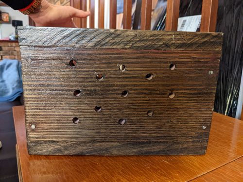

Once it's together, I drill holes (about 8mm) into the BOTTOM of your box for drainage!

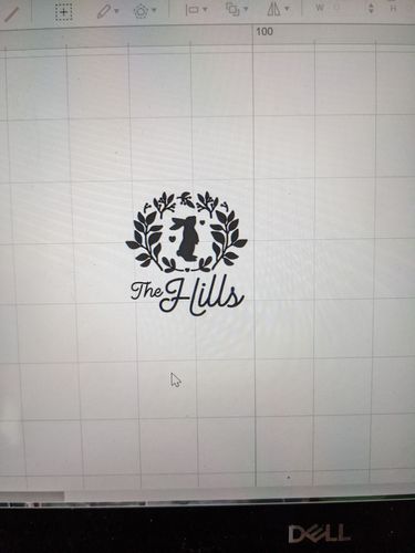

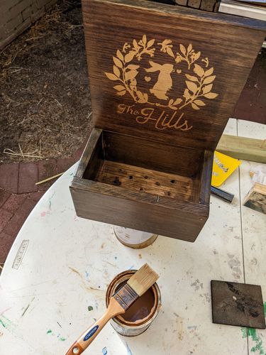

While my wood is staining, I used my Cricut to design and cut a stencil to put on the backboard. I used a gorgeous image from a fellow Cricuter and added our surname - It's extra cute for me because I'm new to the Hill family and we live on a HILL! Using Cricut Stencil vinyl I cut my project, weed it, apply transfer tape and then I was ready to stencil!!
Centering the stencil onto the back of the board I applied it with the transfer vinyl.
Note to self: do not use strong transfer - it was wicked hard to get off!! Normal clear vinyl will do!! I also should have covered the area I wasn't painting as it seems spray paint has quite an off spray - which for me I didn't mind so much as it gives the stain a bit of extra sparkle!!!
With acrylic gold paint I stamped my stencil design and then sprayed over it with Squirts Gold Gloss spray paint. I got a bit of a square mark from the stencil shape when I did the spray paint - I buffed this out a bit with a sand block so it wasn't as obvious - but again I think it adds a bit of sparkle and depth to the back.
Also - this was my first attempt at stenciling so please forgive the lack of perfect lines - again it just adds to the character of the planter 🙂
Stenciled & Stained!

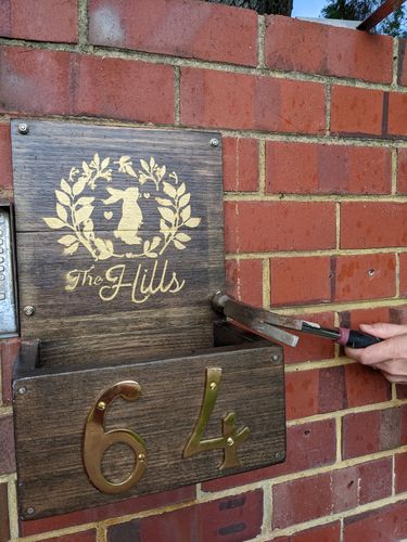

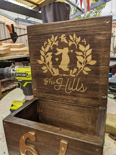

Next, we need to put our numbers on – otherwise it’s just a cute planter box not a cute HOUSE NUMBER planter box! I bought Sandleford 100mm "Windsor" Screw-on numbers in Polished Brass. I probably should have marked and pre drilled the holes BEFORE I stained and finished but oh well... Using the back of a contact sheet (which has a grid printed on it) I taped this to the front and centering the two numbers with equal distance apart and from the edges I NOW mark and drill my holes – Still leaving the contact sheet on so I don’t mark my pretty wood! With my holes in place, I can take off the contact and screw in my numbers!

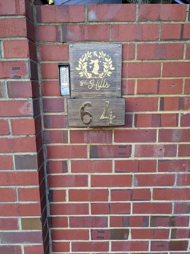

Now all I have to do is put it up out the front! Because it’s going onto a brick wall, I need to use a MASONRY DRILL BIT and a masonry fixing. Following the instructions of “How to install masonry fixings” on the Bunnings’ website, I decide that even though my planter box isn’t too heavy, I prefer the look of the hex nut on the Dynabolts.
Marking on the TOP corners of the BACKBOARD and using a spare bracket hole as a guide for my bottom two holes – which I’ll drill from the back – I made 4 clearance holes with a 6mm drill bit. Which, I probably should have done BEFORE I applied my stain and finish – whoops!
Lining up my planter box, I marked through the clearance holes onto the brick. I use my HAMMER drill setting on my Ryobi cordless drill and made 4 holes with a 6mm masonry bit. With my amazing hubby to help me line it all up, I gently hammered my 60mm Dynabolts (that I pre-hammered through my clearance holes) into the brick. Then with a spanner, turned the nut till it was tight and my box was flush against the wall!

VOILA!!!!! My very first project and I'm so proud! Except it’s missing something???
