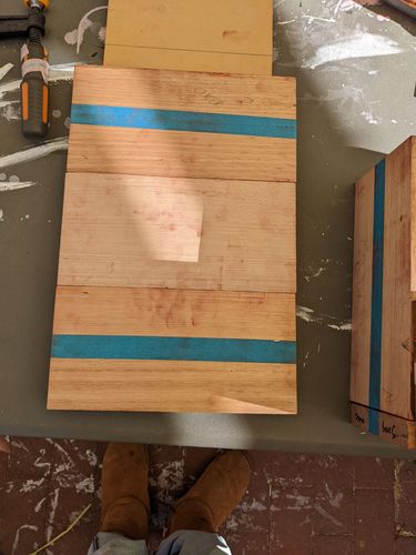

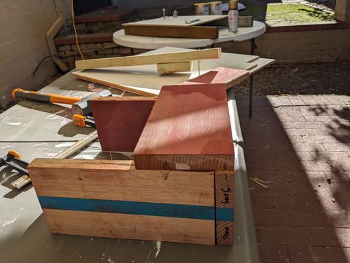

Using scrap pieces of wood from the Women's shed class (thank you Lana!!) I had 7 pieces of wood all measuring at 250mm x 125mm x 20mm. I arranged them into 3 pieces – to form a BACKBOARD
BACKBOARD LAYOUTBACKBOARD LAYOUT

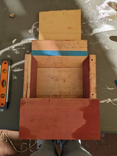

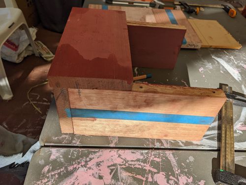

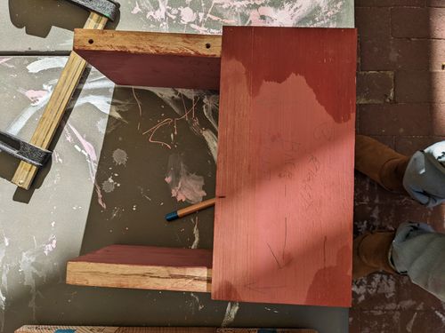

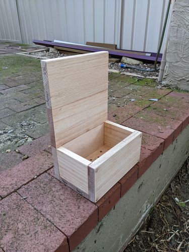

Then I needed to arrange the planter box which will attach onto the backboard. I have a front and a bottom that fit perfect to the back board. I cut two SIDE pieces from my extra pieces of wood measuring the equal amount of 125mm – 20mm of the bottom = 105mm. . .
Borrowing my husband's jigsaw, I tried to safely cut two side pieces. I learnt a lot - jigsaws are intense and whilst they look like it should do straight lines apparently, it's actually a circular blade that I need to get that straight cut (who would've thought?!) Borrowing my father-in-law's circular saw and after going back to Bunnings to replace the wood I ruined with the jigsaw. I asked the hubby to help me cut my sides (I didn’t want another repeat of the jigsaw disaster!)
Now I'm ready to put them all together!
* NB: My replacement wood was different to the wood from the Women's Shed – something I didn’t think would make a difference until I got to the staining stage... whoops!
PLANTER BOX LAYOUT on the BACKBOARDPLANTER BOX LAYOUT on the BACKBOARDPlanter Box - the sides are too big and need to be cut downPlanter Box - the sides are too big and need to be cut downPlanter Layout Left SidePlanter Layout Left SidePlanter Layout Right SidePlanter Layout Right Side

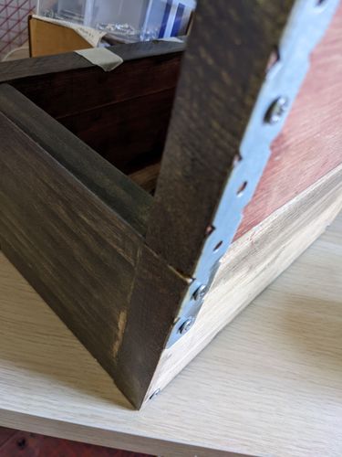

With my wood pieces all smooth and ready to go - Let’s start with the BACKBOARD! I used some Tarzan Grip wood glue that I had lying around (can't remember why? But yay!) and I glued all 3 of my back pieces together on their EDGES and then clamped them in place – so they really stick!

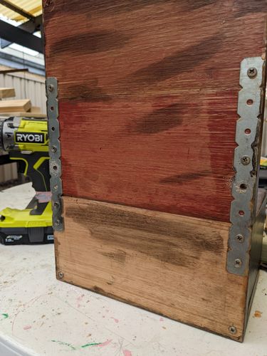

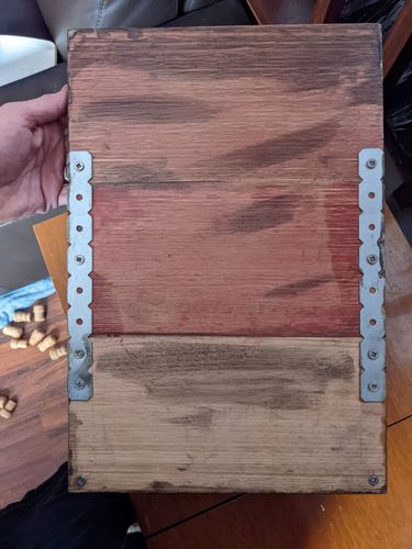

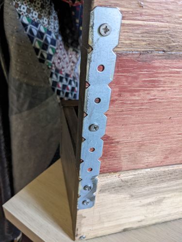

Because I want the backboard pieces to be stable and being a beginner, I don't entirely trust just glue to hold onto a planter box. With this in mind, I decided to use two STRAIGHT BRACKETS* to hold it all together. I think the ones I bought are for making your own brackets because the metal has notches in it and it bends quite nicely too! Whether they were the right thing to use or not - they did the trick!!!!
* Galvanised MAKE-A-BRACKET FLAT 20x2200x1mm by Carinya – they also come in handy to open paint buckets!!!
BACK BRACKETSBACK BRACKETSBack brackets - back view - the two bottom screws are longerBack brackets - back view - the two bottom screws are longerBack Brackets - side/back view - don't want the screws to go through the backboard - but I do want them to go through the bottom into the planterBack Brackets - side/back view - don't want the screws to go through the backboard - but I do want them to go through the bottom into the planter
I placed my two brackets as close to each of their side ends as possible as well as placing along the line that will essentially also meet the box sides on the front.
I positioned the bracket holes so that TWO bottom holes were hitting the BOTTOM piece with just 1 hole EACH in the top two pieces.
NB: making sure that the holes you will be screwing into on the brackets don't hit the joining line of the wood.
I used SMALL screws in the top two holes so that it doesn't protrude the BACKBOARD. For the bottom two holes I used LONGER screws so that they would also go embed into the sides - which I left until I was joining the box to the backboard.
  • Small screws = Timber Screws 8G x 30mm hinge-long threads and countersunk head.
  • Longer screws = Timber Screws 8G x 50mm hinge-long threads and countersunk head.
I marked my holes and with a 7/64 (2.8mm) bit, drilled holes just deep enough to get my screw to self-drive itself into the wood. With my brackets screwed on and secure – the BACK is done!!
Now the PLANTER BOX!!!

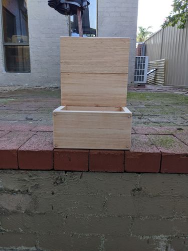

Most of the projects I watched and read "how to" used a nail gun – and they're expensive!! I did it the old-fashioned way with a hammer and nails!  Starting with the FRONT and the two SIDES I used wood glue and placed the front on TOP of the sides like a little table. I then drilled holes on my marks with a 5/64 (2mm) drill bit. Then I hammered in some 200mm flathead nails – with the pre-drilled hole they went straight in!
 Next was the BOTTOM. Gluing the other end of my SIDES I followed much the same process to attach the bottom. Except because I didn't want to hit the nail that was coming from the front, I moved my marks on the bottom to be 20mm (rather than the 10mm on the front) from the front and back edge BUT I still kept my 10mm coming in from the ends – so I don't miss the side pieces!

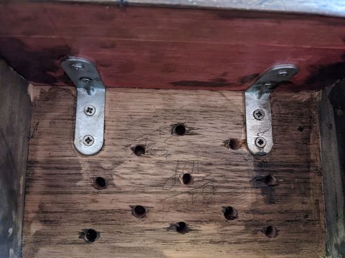

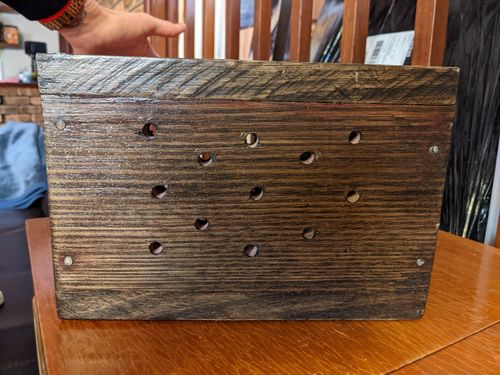

Once it's together, I drill holes (about 8mm) into the BOTTOM of your box for drainage!
Drill BIG holes in the bottom for drainage - as many as you like!Drill BIG holes in the bottom for drainage - as many as you like!

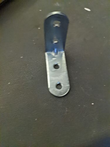

Another tool/material (?) used by many YouTube pro-ers was "L brackets" - I managed to get two on the front and the bottom but when I wanted to join the backboard to the box, I couldn't get the drill in to make my holes. I ended up leaving it with just the two L brackets because I also knew that the straight brackets on the back would hold the planter!!! I thought this was clever of me?!
The L Brackets I usedThe L Brackets I usedL Brackets attaching the FRONT to the BOTTOML Brackets attaching the FRONT to the BOTTOM

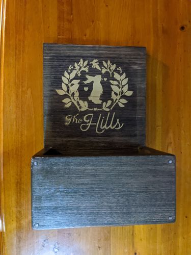

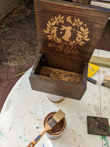

NOW it's all joined it's time to make it pretty!! I sanded again, this time with an orbital sander! I used a coarse grain (240) then a fine grain (80) and rounded out my corners just a little for an extra smooth look.
All together : Front viewAll together : Front viewAll Together: Right Side ViewAll Together: Right Side ViewAll together: Left Side ViewAll together: Left Side View
I used the Shanty to Chic2 (fun American YouTube diy-ers!) to do my stain:
  1. Spray the wood all over with water (this brings out the grain of the wood so the stain can catch it better!)
  1. With a foam brush, going WITH the grain, I applied SIKKENS EBONY (#40) stain.
  1. After leaving it a few minutes (still wet NOT STICKY!) I used a rag to wipe/blend the stain.
I repeated this ^^ about 4 times, then with the last coat I left it for 24 hours to set in. Because the colour Ebony is so dark I was achieving the depth of colour I wanted quite quickly - but to be honest it was all just guess work until I was happy with the colour and that’s when I left it alone.

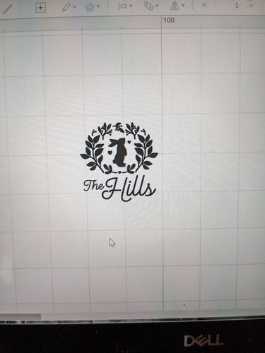

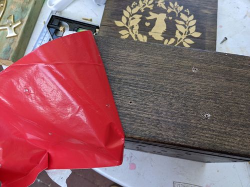

While my wood is staining, I used my Cricut to design and cut a stencil to put on the backboard. I used a gorgeous image from a fellow Cricuter and added our surname - It's extra cute for me because I'm new to the Hill family and we live on a HILL! Using Cricut Stencil vinyl I cut my project, weed it, apply transfer tape and then I was ready to stencil!!
My Cricut designMy Cricut design

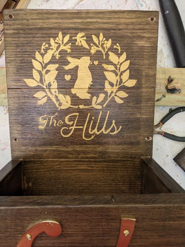

Centering the stencil onto the back of the board I applied it with the transfer vinyl.
Note to self: do not use strong transfer - it was wicked hard to get off!! Normal clear vinyl will do!! I also should have covered the area I wasn't painting as it seems spray paint has quite an off spray - which for me I didn't mind so much as it gives the stain a bit of extra sparkle!!!
With acrylic gold paint I stamped my stencil design and then sprayed over it with Squirts Gold Gloss spray paint. I got a bit of a square mark from the stencil shape when I did the spray paint - I buffed this out a bit with a sand block so it wasn't as obvious - but again I think it adds a bit of sparkle and depth to the back.
Also - this was my first attempt at stenciling so please forgive the lack of perfect lines - again it just adds to the character of the planter :smile:
Stenciled & Stained!Stenciled & Stained!Stenciled & Stained!Stenciled & Stained!

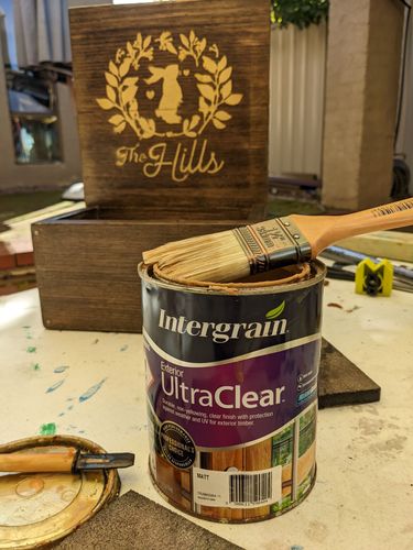

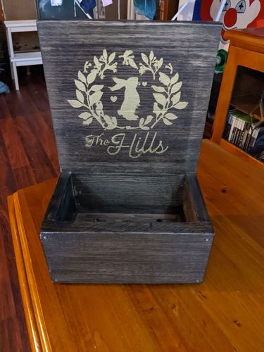

Now I've got my stencil and my stain on it's time to add a finish so my project doesn't rot away! With a bristle brush and FINISH* I coated my planter over 3 days for extra security against rain (plus it will have a plant in it sooo...)
*I used Exterior Ultra Clear in Matte by Intergrain – a water based, non-yellowing, clear finish that will provide my planter box with protection from rail, hail and shine – though hail isn’t much of an issue in the West.
Finish - a coat - but I am nearly finised!Finish - a coat - but I am nearly finised!Coating with a bristle brush helps avoids streaks and clumps when applyingCoating with a bristle brush helps avoids streaks and clumps when applying

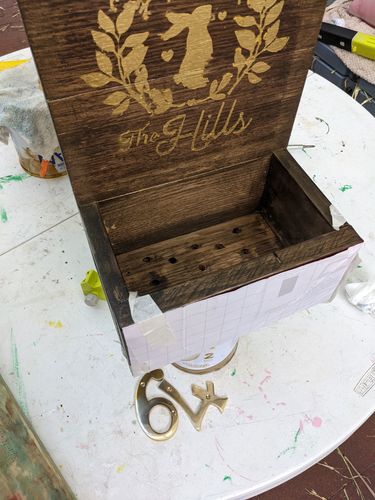

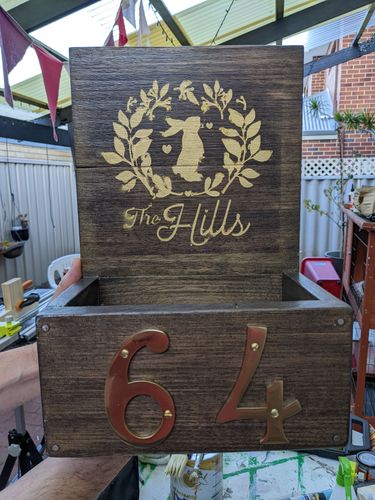

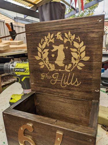

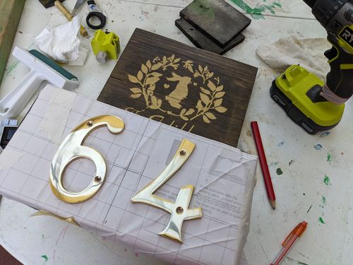

Next, we need to put our numbers on – otherwise it’s just a cute planter box not a cute HOUSE NUMBER planter box! I bought Sandleford 100mm "Windsor" Screw-on numbers in Polished Brass. I probably should have marked and pre drilled the holes BEFORE I stained and finished but oh well... Using the back of a contact sheet (which has a grid printed on it) I taped this to the front and centering the two numbers with equal distance apart and from the edges I NOW mark and drill my holes – Still leaving the contact sheet on so I don’t mark my pretty wood! With my holes in place, I can take off the contact and screw in my numbers!
Numbers!!Numbers!!Using the back of some contact paper to help line up my numbers!Using the back of some contact paper to help line up my numbers!Pilot holes for numbersPilot holes for numbersScrewed in!!Screwed in!!

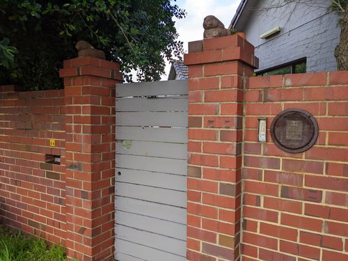

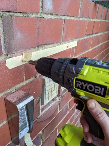

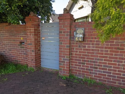

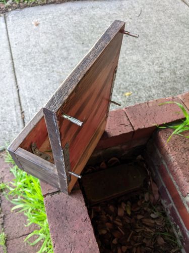

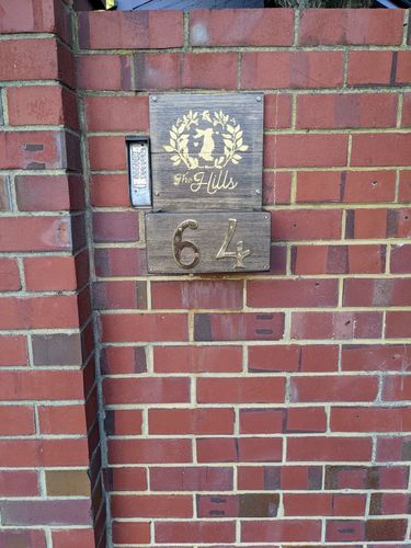

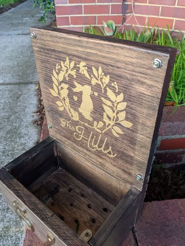

Now all I have to do is put it up out the front!  Because it’s going onto a brick wall, I need to use a MASONRY DRILL BIT and a masonry fixing.  Following the instructions of “How to install masonry fixings” on the Bunnings’ website, I decide that even though my planter box isn’t too heavy, I prefer the look of the hex nut on the Dynabolts.
Marking on the TOP corners of the BACKBOARD and using a spare bracket hole as a guide for my bottom two holes – which I’ll drill from the back – I made 4 clearance holes with a 6mm drill bit. Which, I probably should have done BEFORE I applied my stain and finish – whoops!
Clearance Holes for wall attachment BACK view - goes through the spare hole in the bracket!Clearance Holes for wall attachment BACK view - goes through the spare hole in the bracket!Clearance Holes for Wall attachment Front viewClearance Holes for Wall attachment Front view
Lining up my planter box, I marked through the clearance holes onto the brick. I use my HAMMER drill setting on my Ryobi cordless drill and made 4 holes with a 6mm masonry bit. With my amazing hubby to help me line it all up, I gently hammered my 60mm Dynabolts (that I pre-hammered through my clearance holes) into the brick. Then with a spanner, turned the nut till it was tight and my box was flush against the wall!
Dynabolts pushed through planter FRONTDynabolts pushed through planter FRONTDyabolts pushed through planter BACKDyabolts pushed through planter BACKUse masking tape to mark the depth of your drill bit AS WELL as on the brick to avoid slippage and helps with brick dust too!Use masking tape to mark the depth of your drill bit AS WELL as on the brick to avoid slippage and helps with brick dust too!Just tapppp it in... taaappp it in!Just tapppp it in... taaappp it in!
BEFORE...BEFORE...... AFTER! But something is missing?!... AFTER! But something is missing?!
Definitely needs something in it... but what?!Definitely needs something in it... but what?!
VOILA!!!!! My very first project and I'm so proud! Except it’s missing something???
A BUNNY!!!!! :)A BUNNY!!!!! :smile:FITS PERFECTLY!FITS PERFECTLY!
