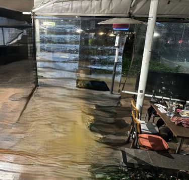

I should have included a photo of the umbrella, which has already two of its sides closed with much heavier wind up blinds. The umbrella is a commercial one with its pole 3m dug into the ground. Would this change your suggestions and advice?
Cheers,
Murat

Re: How can I install PVC patio blinds to the side of a large permanent umbrella?
Hello @Murat
Thank you for sharing that picture of the umbrella. Yes, I still recommend putting in posts to hold the weight of the blinds so that your umbrella will not have to bear any of its weight.
Good Morning @Murat
As it is a comercial solution it does change my suggestion, I would suggest an engineer to design something that will carry the load. For home its different but when you have members of the public involved and the quantity of people always around it. It changes things up. So needs to be made safe under tighter circumstances.
