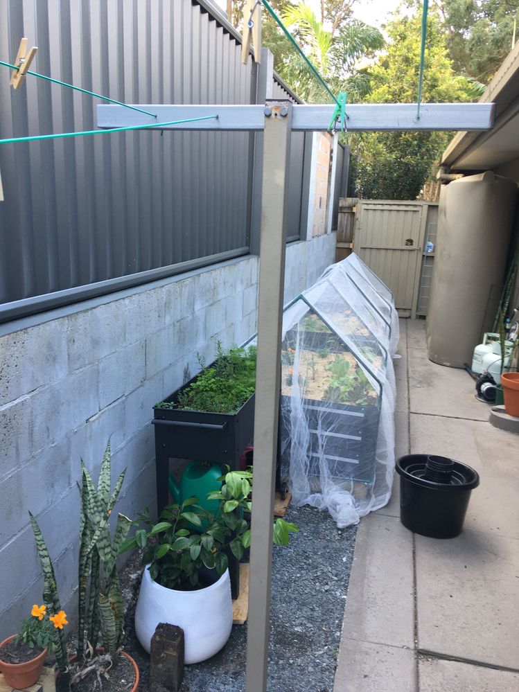

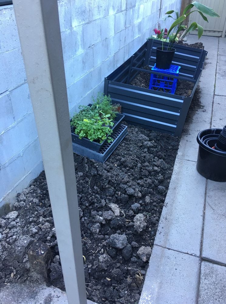

Hi guys. This is the current sorry state of our narrow side yard. We've removed the old paling fence and our old raised garden beds and are going to drop in new metal garden beds like the one my partner and project boss has assembled in the pic above.
The problem is that the new beds aren't going to sit level because of the concrete that dripped down along the fenceline when our neighbour built the retaining wall and core-filled the Besser-block fence pillars.

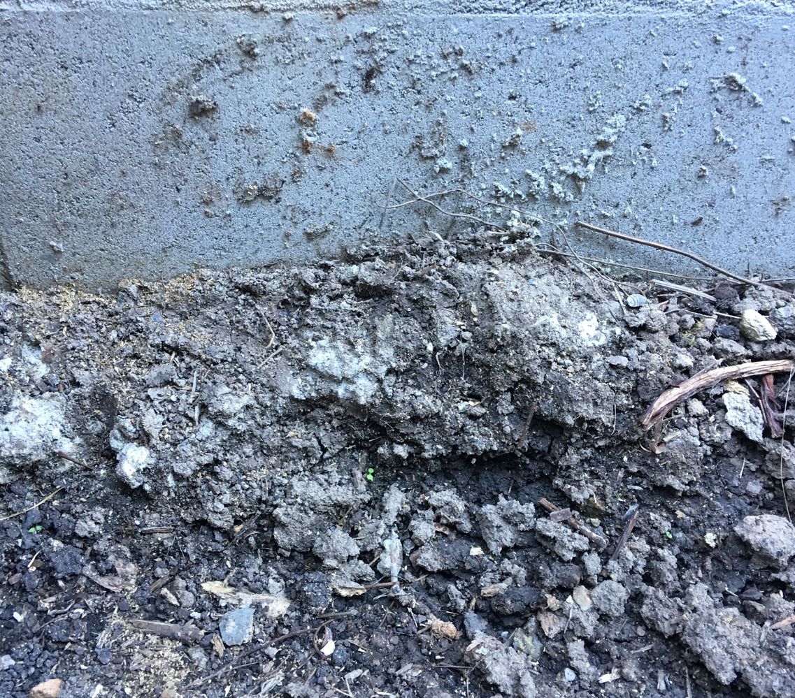

What would be the easiest way of removing some of that concrete from the bottom of the retaining wall so the raised beds can sit flat? It won't crack off easily just by hitting it with a pick. Would an angle grinder be suitable? Terrible pic below of the concrete or mortar at the base of the retaining wall:

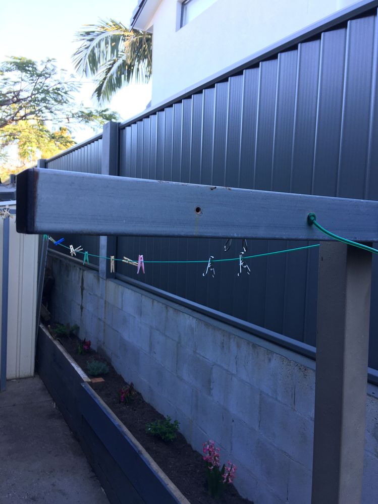

One last question: It seems that corrosion has narrowed the holes in this 50mm metal tubing so that I can't fit 3mm clothesline through it any more. Could I slightly widen the holes with an 18V drill? What sort of bit would I need? I don't know what kind of metal it is.
