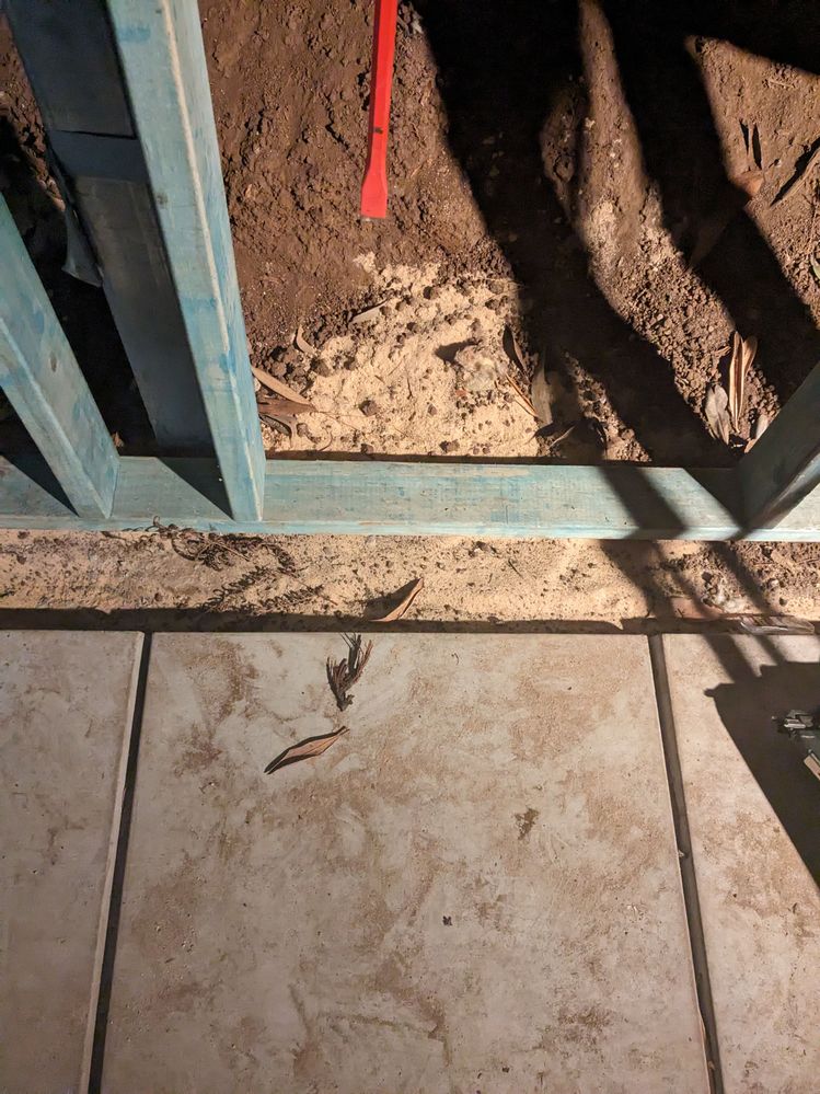

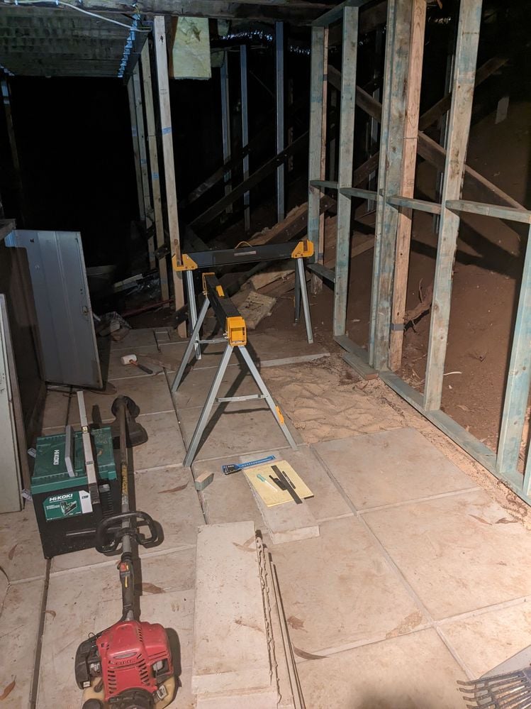

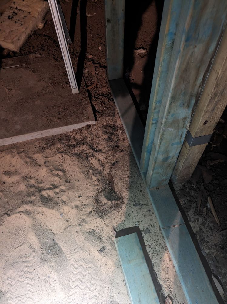

Hi everyone,
I recently decided to build a storage area under my deck. I decided to use 600m x 600mm concrete pavers for the floor. I should have really poured a proper slab, but I think I'm too far along now to explore that option. Anyway, I want to build a partition stud wall, but I don't know how to anchor it to the ground. I was thinking of pouring a narrow slab that goes around the perimeter of the pavers, but there's a problem. The pavers go right up to a line of house stumps, and I'm very wary of interfering with them. Any advice would be appreciated. Could I create some low concrete piers in between the stumps and anchor the wall to those? Or am I just overthinking all this and I could anchor the wall to the concrete pavers (which are 50mm deep). Photos attached for reference.
