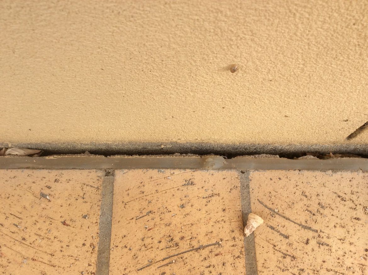

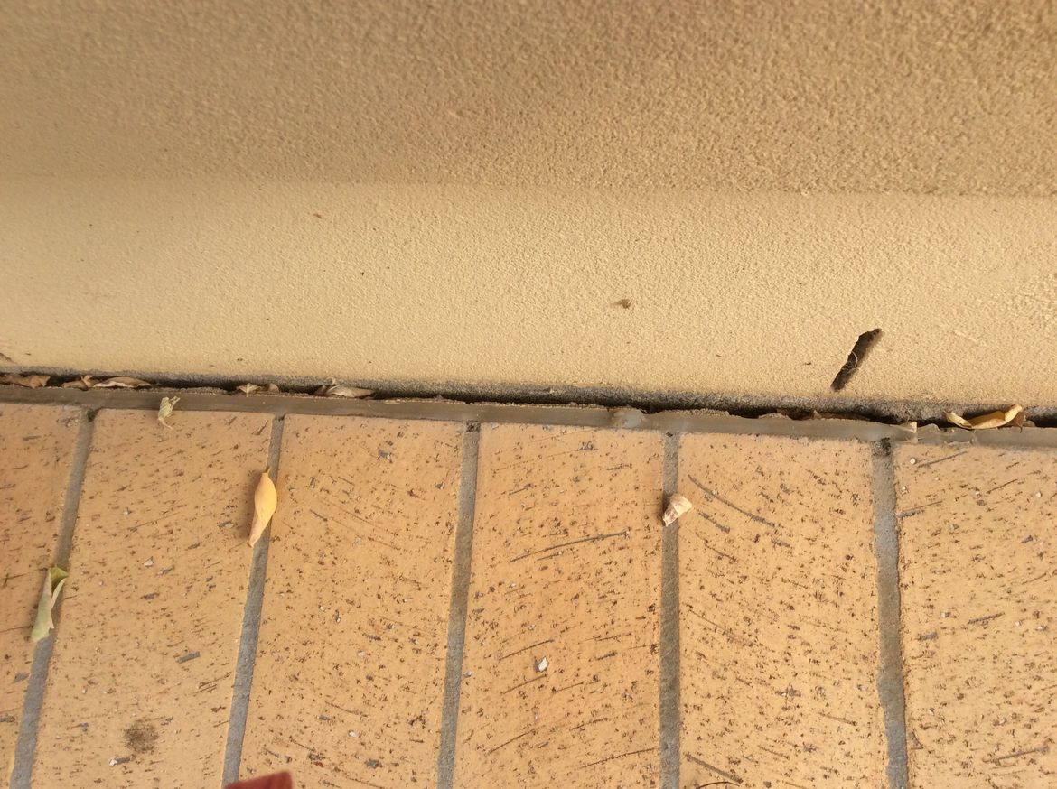

What can i use to fill gaps between my house & patio pavers.The gaps were filled many years ago with silicon which has long perished.The gap itself is approx 2-3 mm wide & stretches around most of the house. Any assistance will be appreciated.

Hello Eric, Thanks for your reply. I’ve taken a few photos as requested. The area looks even worse now than I previously thought! Hope your suggestion will rectify the problem.

Thank you for posting those photos. My apologies for misunderstanding your setup. My recommendation was meant for pavers joined together to form a walkway. In this instance, I suggest using a mortar filler such as Selleys 440g Sandstone No More Gaps Bricks And Mortar Gap Filler. It's specifically formulated to bond with cement, mortar, render and fibre cement.
My number one tip is to fill the gap with Moroday 6mm x 5m White Gap Filler Rod so that when you apply the gap filler it will not sink to the bottom of the gap. I also recommend using a Pro Renovator 38mm Plastic Scraper to spread the filler evenly.

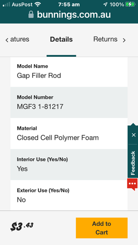

I noticed with the Gap Filler Rod details, it states not for outdoor use. Under the circumstances, can it still be used?

Thanks for sharing your question about the gap filler rod. The reason I suggested using the gap filler rod is because you have greater control over its position compared to self-expanding foam. Once the filler rod is in place it is then covered over with a gap filler, its purpose is to prevent the gap filler from sinking in too far into the gap. Since the gap filler is rated for exterior use it in turn covers the filler rod and protects it from the elements.
